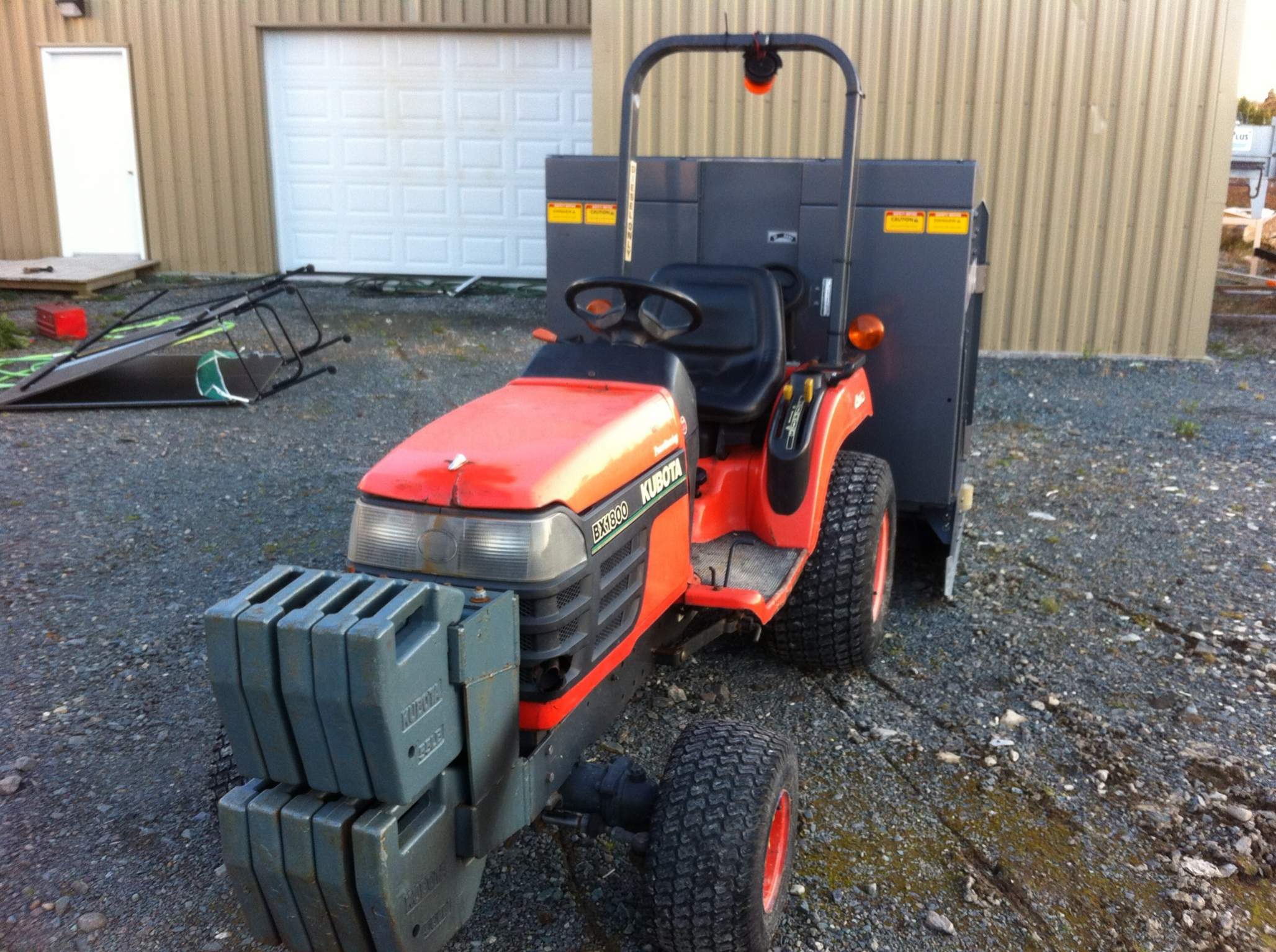

They are 55lbs each.
/ Suitcase Weights for a BX #4
4shorts, what is that on the rear of your tractor; or are you just backed up against it?
/ Suitcase Weights for a BX #5
Looks like a homemade Zamboni
/ Suitcase Weights for a BX #6
Tom gets the prize :laughing:
I did this for a customer a few years ago. It reappears at the shop once in awhile for service. Works well. The one technical issue I had was getting the 3pt arms to lift the resurfacer. I got around that by shortening the two lift arms 1.5". Once I did that it's was all perfect.
Extra weights to keep the front down

Obviously you've had this working for a while now, but I dug out a BX18/2200 manual that I'm mailing this afternoon to another member. I opened it to a random page this morning and it talked about ballast. I believe it said 275 lbs max. You are at 550 with 10 of them. Are you at all concerned about the front end on this rig?
/ Suitcase Weights for a BX #18
Not at all. Two and a half years and counting since completion and used daily. I really had no choice in the matter. Customer had the BX1800 on hand and this was the resurfacer he wanted mounted to it. He's also an engineer so he understands these things. He just told me to make it happen. He is very pleased with the outcome, I'm paid in full and everyone is Happy, Happy, Happy :thumbsup:
/ Suitcase Weights for a BX #19
I should have thought over that question before I even posted it. Duh! The loader is 400 lbs and they lift more than 175 lbs. I guess maybe that's a limit for the stock weight holder. And nothing you've touched is stock. :laughing:
So I guess I'm happy too.
/ Suitcase Weights for a BX #20
I actually thought it was a great question and observation on your part. The resurfacer never comes off the tractor. It's used only for that purpose and even though there's a lot of weight on the front you could almost pick the front up because of the weight of the resurfacer so I was never concerned about it. Like you said. Put an FEL in there and factor in what it will lift and your well over those weights. Ya I'll admit I tend to mod a bit :laughing:
