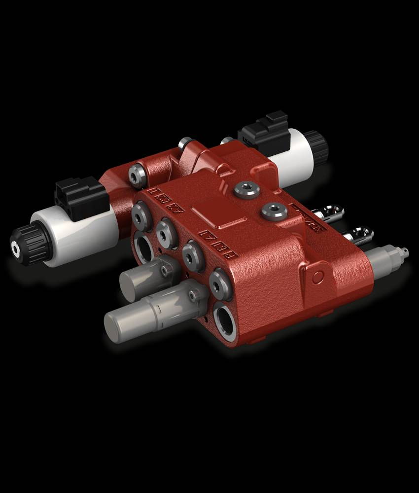

anyone using one of them on a LS ??
doing a install on a XG3025 as well a remote on the rear

I just installed a Summit 3 circuit remote multiplier kit. It’s a very nicely made setup with high quality components.

Hello, I will give a update when finished , so far the third function kit installed and is good to go , finishing up the remote , I had a couple single control valves and using the smaller of the two for my remote in the rear . I went with this kit and made my own mount out of 1/4 X 5 flat stock .

as well as the remote , i changed my mind again and doing two remotes , one being live will run a B-hoe or wood splitter and the other will have the handle . had to machine a sleeve for the return to sump under the seat . the handle isnt bad on the Summit in my view .
i build just about all of my attachments thats why i needed the third function , welding up my other grapple now i use a bucket and a log grapple

Hello, on the paint pic i posted to show the color match for LS tractors , the part i painted was the mount for the third function control on , .. Boy i thought i knew enough about hydraulics that this would be a breeze , Ive owned backhoes, and bocats and never gave me this much of a mis understanding , but i got a lesson on Humanility & Patience , on pressure verses flow of fluild . this project is done - finished and is good to go .. will post a complete DIY 3rd function and 2#rear remotes install with pics ,, will do a you tube video and post it aswell as this should carry over to most models that has the same frame work as the 3025 and help out owners who want to do their on installs .
