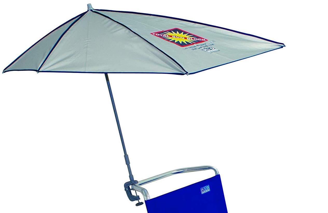

Anyone ever try something like this?
Amazon.com: Rio Beach UB57 Total Sun Block My Shade Clamp-On Umbrella: Sports & Outdoors
