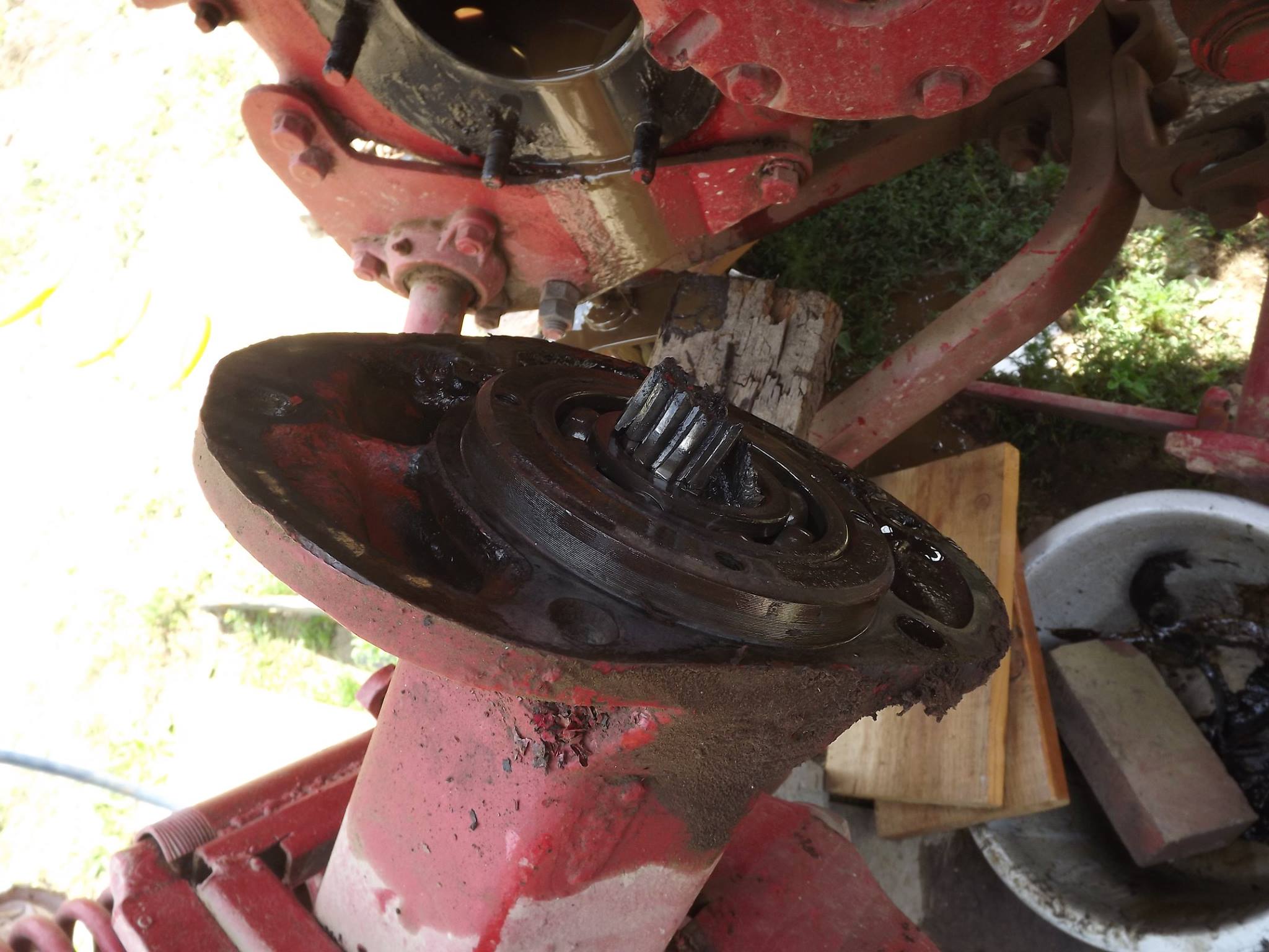

now i need to know how the axle comes out of the housing. is there a retainer clip on it?
   / Super C transmission gone out? #16
Axle comes out the other end of the housing, but first you need to remove the end cap. Axle is larger in the center, and machined for the bearing to fit over the splined end, and the outboard axle size. Here's an exploded view of it, from Case/IH online parts store. Pretty simple, once you see it. Official Case IH Online Parts Store and Case IH Catalog for Best Parts Search and Best Parts Look Up. Case IH Parts for Case IH Tractors, Case IH Combines, Case IH Tractors, Case IH Manuals, Case IH Parts
It looks like you have the bearing retainer removed on the inside, so, once you remove the outboard axle end cap, it should tap right out.

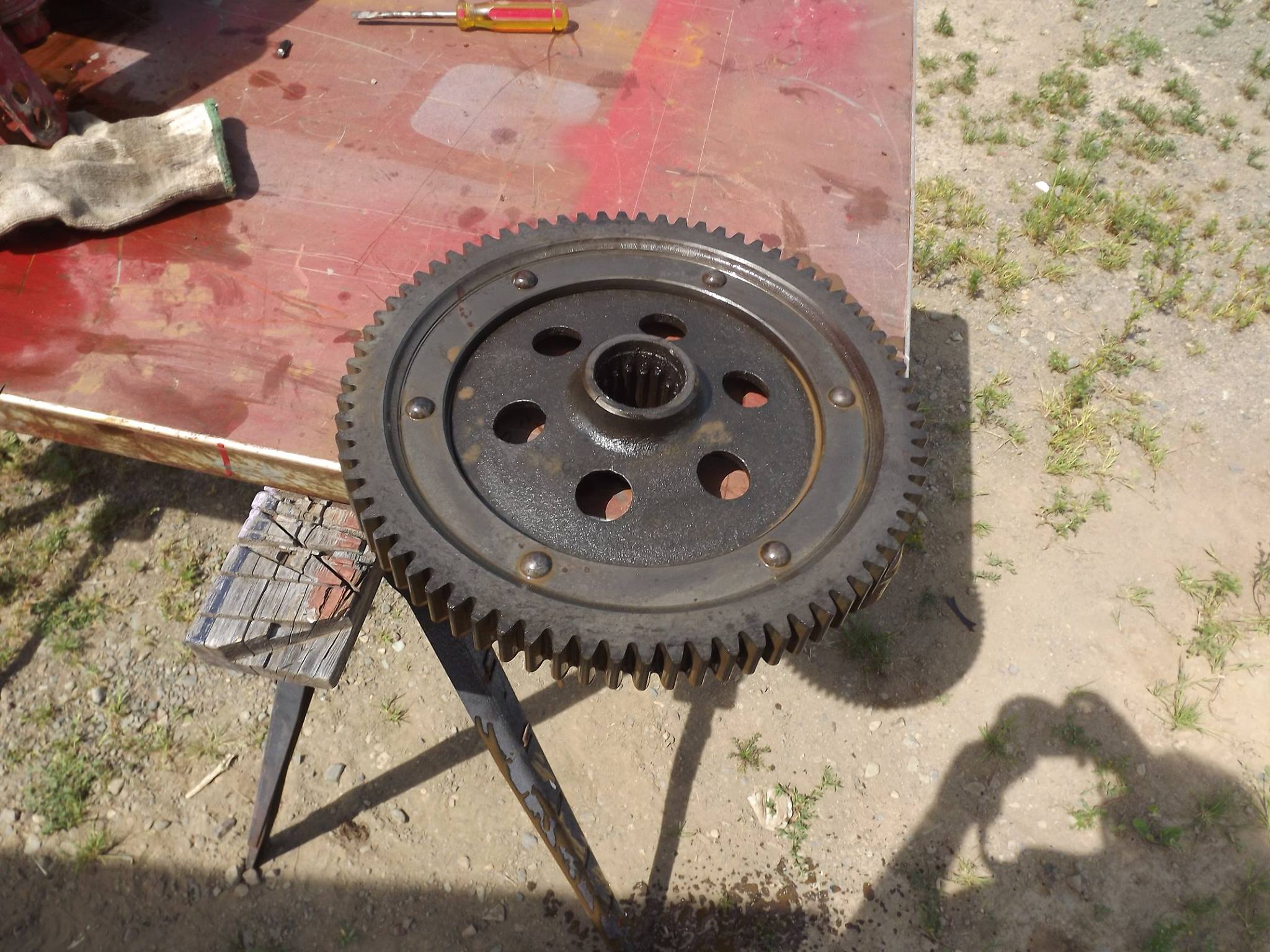

Thanks..I Think these bearings and shaft are original. The bearings are corroded a little to the axle even with a gallon of grease and oil surrounding it. When i first broke the housing gasket seal about a cup of water came out from either condensation or top cover bolts collecting water in their little mini funnels. I'll fix that when i put the cover back on.
#18
Yep, the axle and bull gear are damaged, so i was able to salvage the two bearings though. They are good and tight and roll for a long time with a good spin. So now i'll need three gaskets and a piece of rubber tubing and two hose clamps (guess where they will go) and a tube of gasket sealer and some heavy oil. I'm thinking 90 weight.
