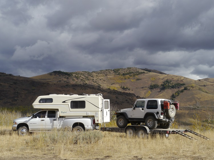

We had a fairly hefty camper on our truck for a while - it was within the truck's cargo capacity ('97 F350 SRW; 9.5' camper took most of what was available) and if you're not used to driving a truck with a heavy camper I think you may want to try before you buy and reconsider. I found driving it to be pretty disturbing - a lot of weight up fairly high made driving on curvy roads pretty uncomfortable and stressful, not to mention how it felt with crosswinds. Airbags may help some; we were considering that but then we ended up selling instead.

Keep in mind that the outer edges of your mirrors, be it on a SRW or DRW, are generally the widest part of the truck. So - if the mirrors fit, the dually fenders will also.
...from someone who went from SRW to DRW to haul a camper and will never go back. HUGE difference in stability.
