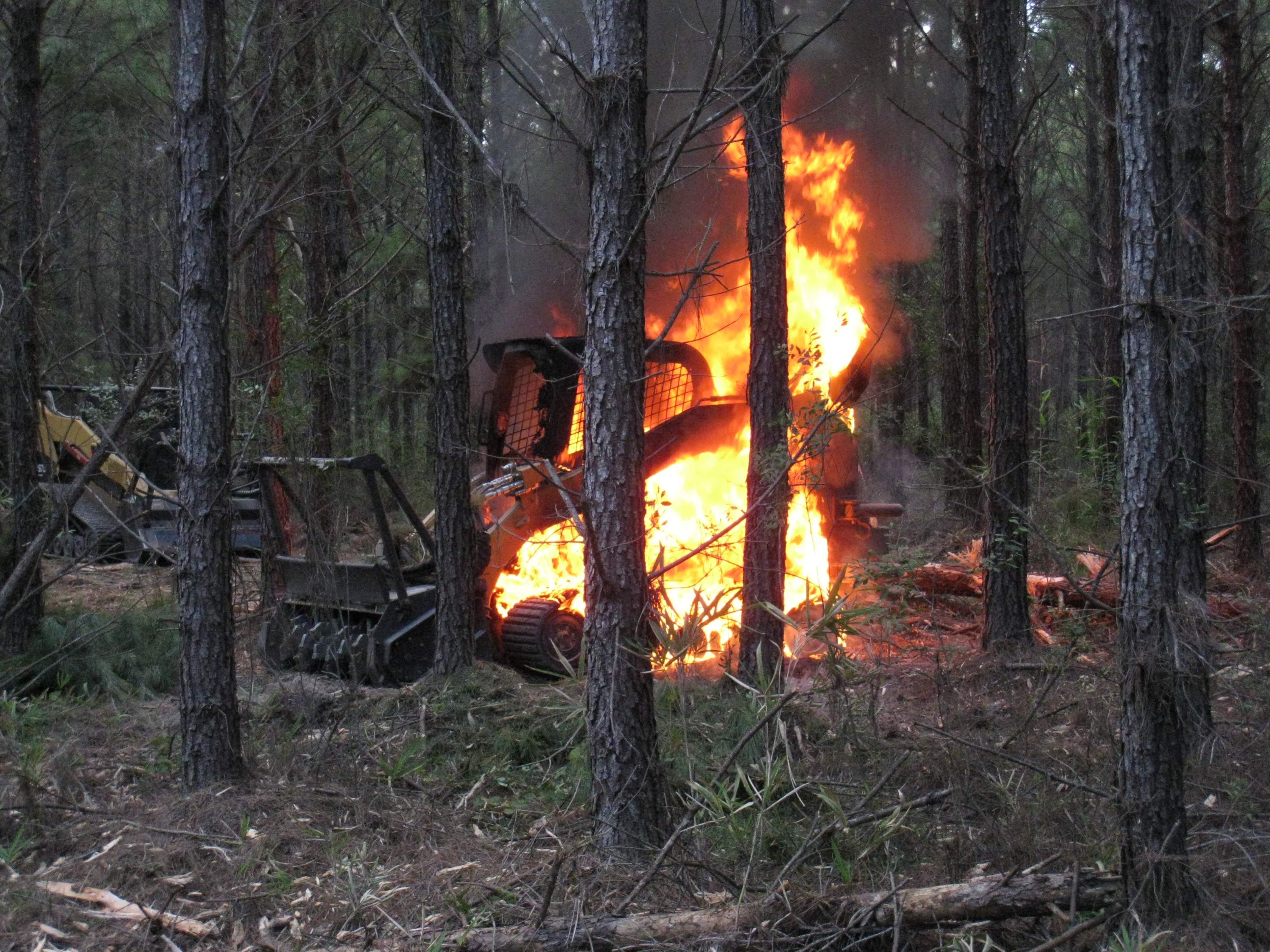

Yes, I've Demoed A Supertrak Sk 140 for 10 hours i was very impressed with the unit until my CAT Salesman told me the price. For wat they want for the Sk 140, i would buy a fecon 148l. The Sk140 is a cat 297 frame extended out to cram a 140hp motor in, the fecon 148l has a big enough engine bay to stick a bigger motor in plenty of room to work on an easier to keep clean. The sk 140 has to many nooks an crannies for debris to build up in an hard to reach. Trust me u don't want to spend take kind of money on a Skid steer an this happen.
Now the bigger Supertrak units are Good Machines I would just stay away from the skid steer Models.
