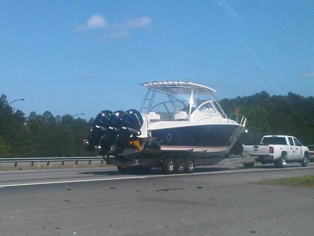

Is that DiamondPilot? It's been 2016 for a while now. And that's DRW/CC/4x4 and a 4.3 axle.
No, but we tow them bigger than that. I would guess that boat on the trailer to be about 15,000#.
