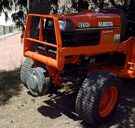

Glenn,
This is the weight I use when I run my 5ft. rotory cutter on my B2710. Seems to work just fine, only adds about 150lbs.

Well, I really want to cut grass (but not brush) with the loader off, and I dont think I need too much weight. The only other alternative is to add weights. (I was thinking of having two hooks welded on my brush guard, into which I could put my old barbell with weights. But I dont like the hassle of putting heavy things on and removing them.) I sort of interested in doing the foam just as an experiment. I've had one flat way out in the field and it was a hassle and a time waster. I also sort of like the idea of just making my tractor permanently more heavy sans loader.
   / SuperFlex Tire Ballast #10
Hooks on the front guard is an interesting idea, but I agree it would be nice to permanently attach whatever weights you are going to use. Let us know how you make out. I've been considering more front weight even with the loader to improve traction in the snow.
