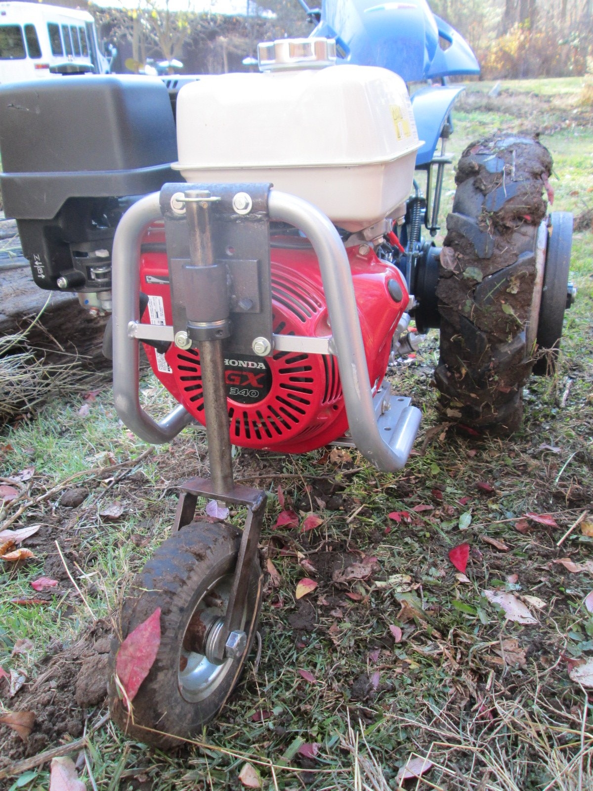

Here's a transport wheel I made for my 739 that is a lot nicer than just a stand because you can drive the tractor with it in the down position. It pivots up for when you don't need it. Had to remove the plastic BCS cover. Used half pieces of pipe to mate up to the BCS frame tubing. Clamped everything together and tack welded it on the machine. It was a bit of a project but would not be without it.

Wow, that’s nice.

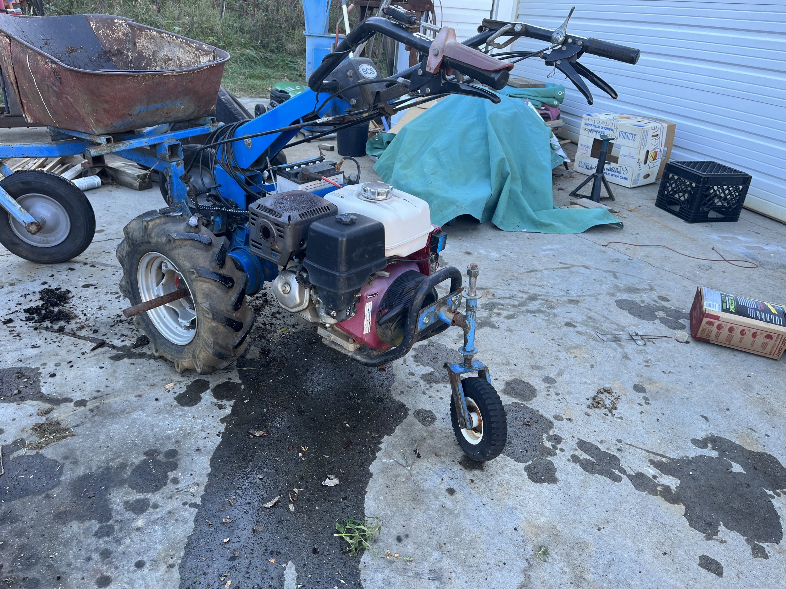

I built this one, very similar to NibbanaFarm. A simple plate bolted to the bumper, the rest just pipe and threaded rod, what ever I had laying around. The wheelbarrow was also homebuilt years ago, one of the most useful implements for year round use. The oil is not from the BCS, changed a filter on a Kubota and made a mess.

You guys are much more skilled and/or handy than I am! Both of these supports look great.
