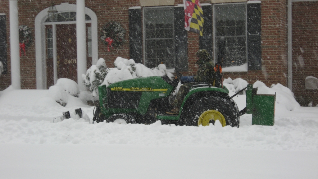

Yesdeere! Hey, I live in 21035 and we only have 18 inches..,,, Where abouts are you ?
Having fun, but I had to weld the weight bucket back together....

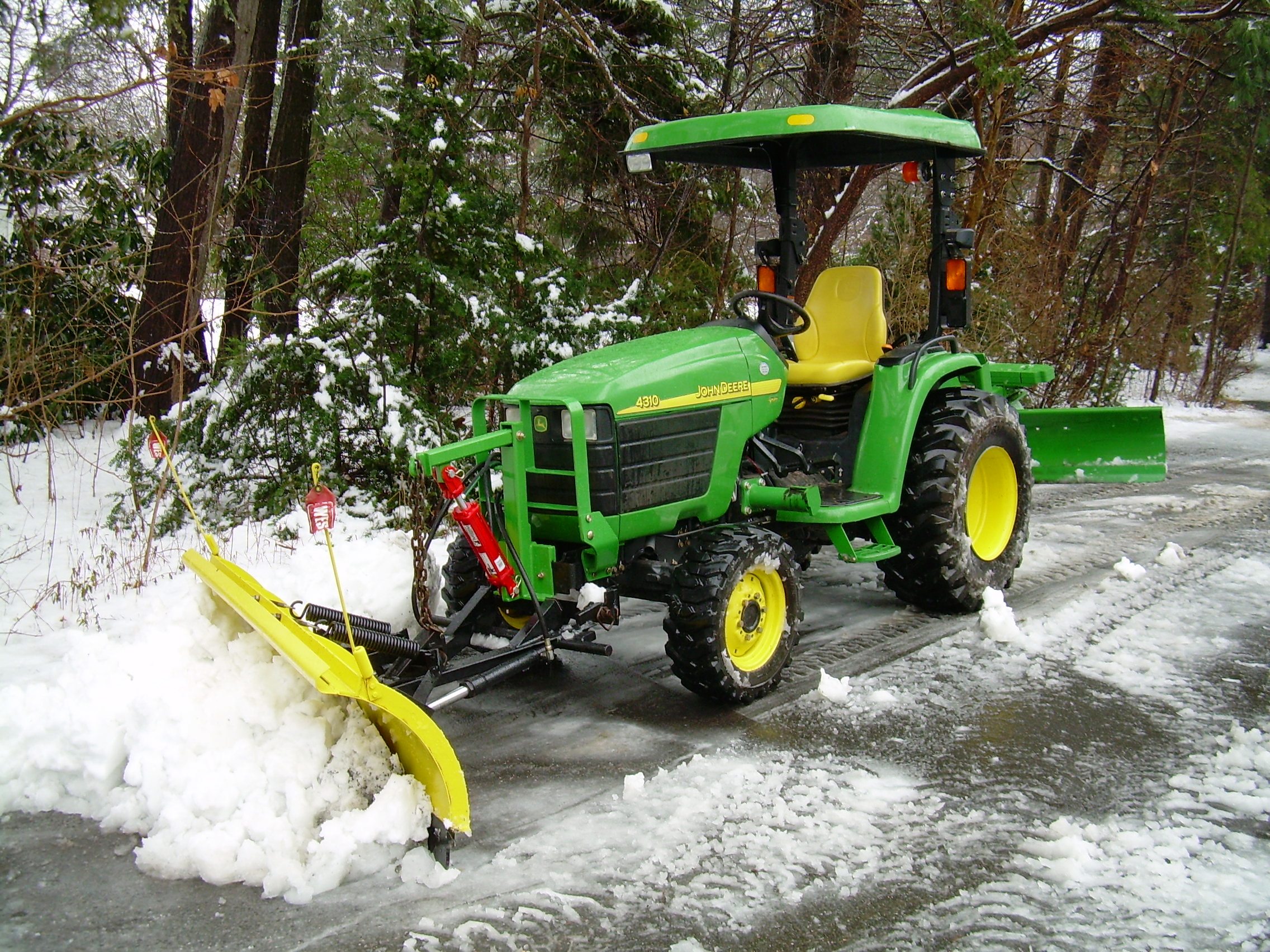

Well, weatherman says 12 - 24 inches of snow inbound for tonight here in central VA, so I guess it's about time to wake up the old 790, take off the FEL and put on the plow----always a pain in my butt. Seems like every time I do it, we're virtually guaranteed to get 0.0010" of snow. Still, the plow is so much better than the FEL or rear blade for snow...just gotta do it.
And unlike all you Eskimos out there with your fancy heated cabs, I'll be freezin' my butt off!! ;)
First, I'll be puttin' a couple pallets of landscape stone in the Dodge....
...and picture attached of my 790's renovated home...
