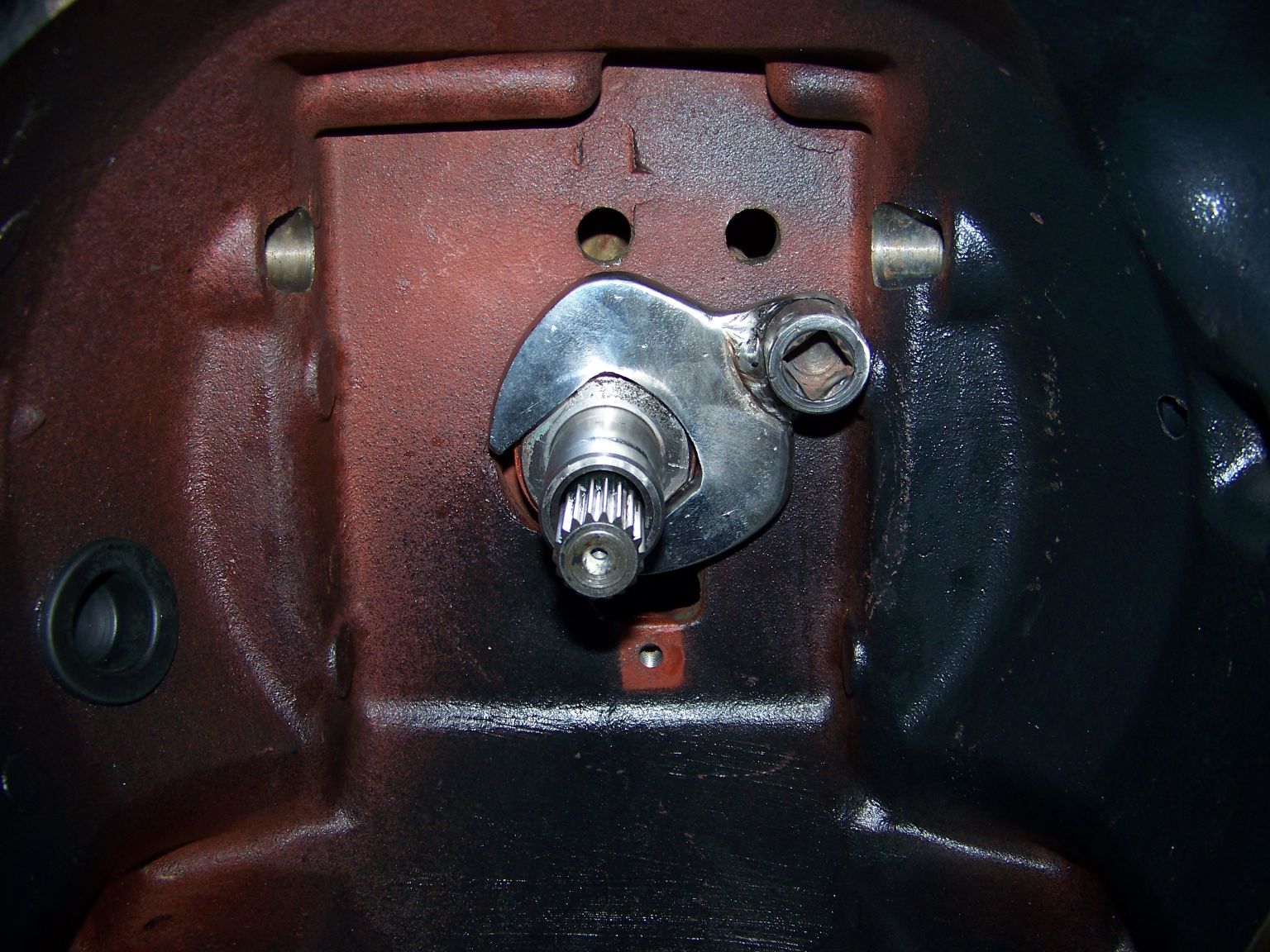

Joe...JC is right...poke a hole in the seal and pull it out. What i did was used a dental pick with a hook and just gave it a swift yank. The seals are not that tightly fitted. and BTW>>>dont bother to remove the steering column...total waste of time I found out after. I too looked into splitting the case when I couldnt get the hub off prior to gettin the crows foot. Splittin that case is a whole lot more work than what U may think...leave it alone!!! <G>
So I take it your hub wasn't that tight? Maybe bcuz yours had the hrs and mine was new? I clearly remember how tight mine was!!! Good job on comin up with a tool!! As for installation of the new seals...I used a piece of pvc pipe I had kicking around. 1 1/4" maybe? lol CRS and all that! Just match up the seal size to a piece of pipe. Try to stay close to the outside diam of the seal, yet still fit into the case opening AND fit over the input shaft. It doesnt take much effort to seat them just keep them straight and not cocked.

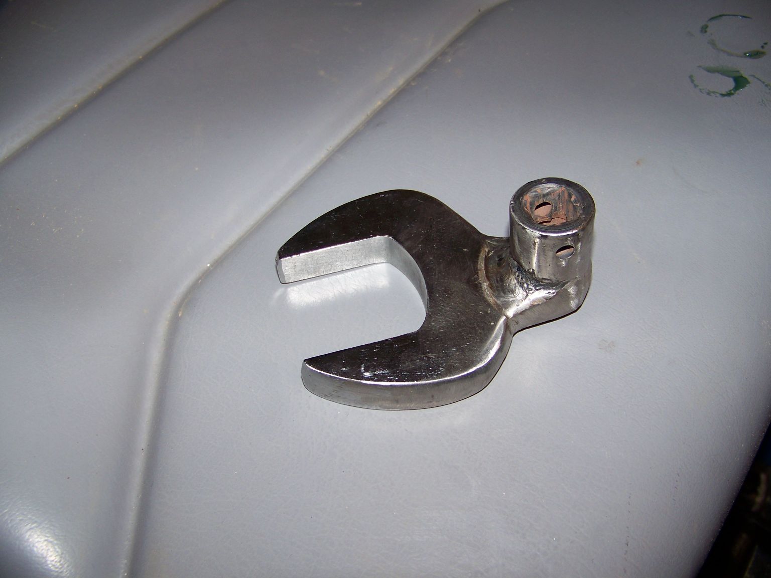

Your doin a great job so far!!...keep us informed. Id like to see that tool U made out of the wrench...can U post a pic?

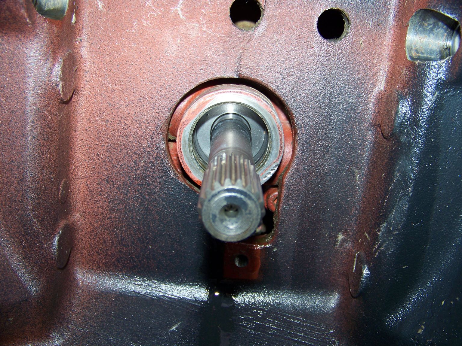

You said earlier that there were two seals? Are they in front of one another? I guess I'll see when I get them out.

Joe...yes there are 2 seals. A primary and a secondary. They both look the same but one is thicker than the other. IIRC...the thicker one is first (inner) and then the thinner one (outer). Just note which is which when U remove them.Since it was 4 or 5 yrs ago, and the only NH that I ever split, I dont remember every detail...plus being my mind is preoccupied by someone else ;)...doesnt help either.

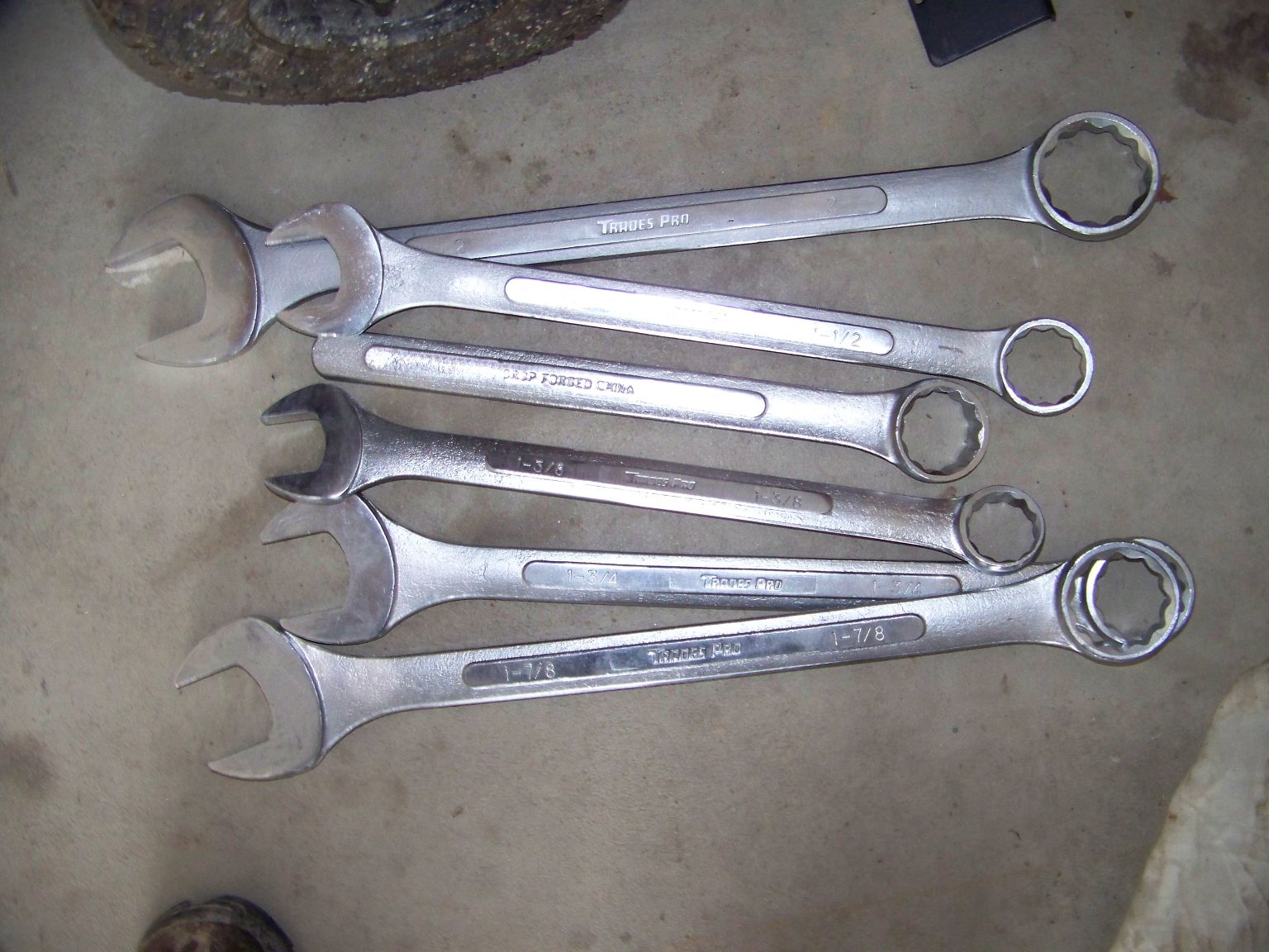

I discovered that the input shaft sleeve was closer to 1-5/8" in size. I'm sure is was really metric but oh well the standard size worked.
I went to TSC and bought a set of larger wrenches. It was $49.99 for one individual 1-5/8" wrench or $69.99 for a whole set that ranged in size from 1"-2". I bought the whole set that way I'd have some larger sizes for whatever I may need.
I cut the end off the needed wrench and welded on a old broken 1/2" drive extension I had.

The seals were removed and using dental picks, they came out easy. I cleaned up everything and inserted the new ones. TCBoomer was correct in that the thick one went in first and then was followed by the thinner one. I covered the splined section of the input shaft with tape and with a light coat of grease on everything. I had no problems getting the seals in using an old piece of PVC pipe.....thank God!
A couple of pics.....
I forgot to take some pics of the seals before insertion. I can get some of the old ones if anyone wants to see them.
