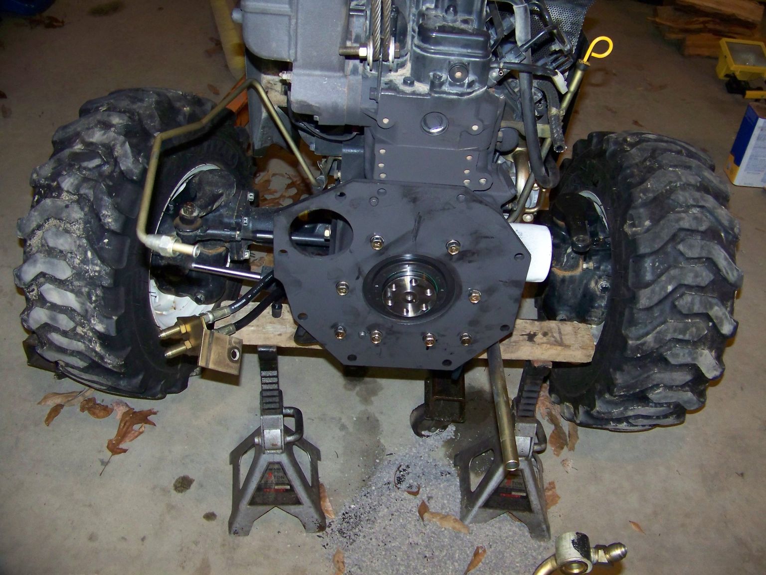

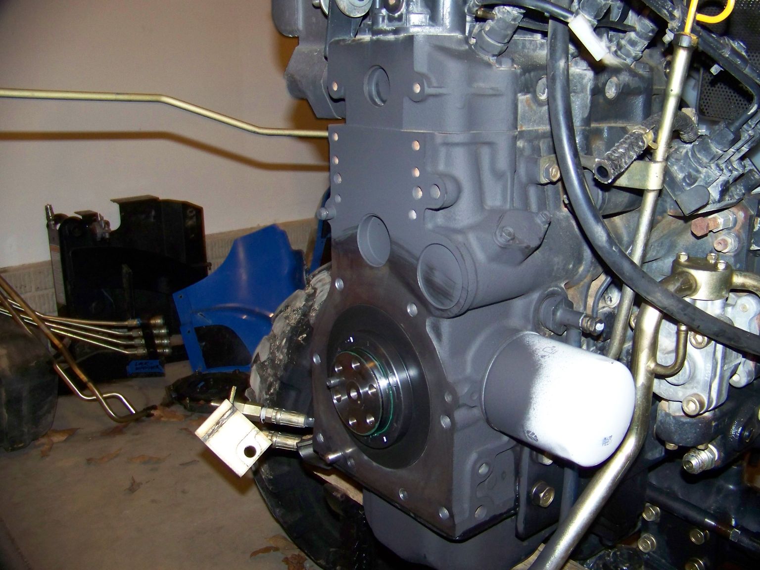

I touched up the rear portion of the engine block. Someone earlier mentioned the rusted freeze plugs and that one looked dented. None of them were dented, it was the camera flash. I did rough up the area/clean and I shot some high temp. paint. I went back with a clean rag and some thinner and wiped off a radius around the rear seal in preparation for some sealant and the new seal. I left the old seal in place during the painting etc.
This is a pic of the new rear main seal in place. I placed a bead of sealant around the outside of the seal before putting the back plate back on.

I cleaned up the back plate and painted it as well. This is it installed along with the new rear main seal.
