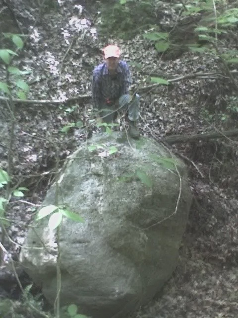

I picture the corner you are looking for on a hillside that is wooded, probably covered with leaves and maybe slick. You take two steps forward and slide back one. I’ve been there and done that. If I thought a corner was there I was extremely persistent when it came for finding it to the point of stubbornness.
A picture of the largest monument I ever found. This is my helper standing on it. It wasn’t set by a surveyor but just happened to be on the corner Does this look like your terrain?
