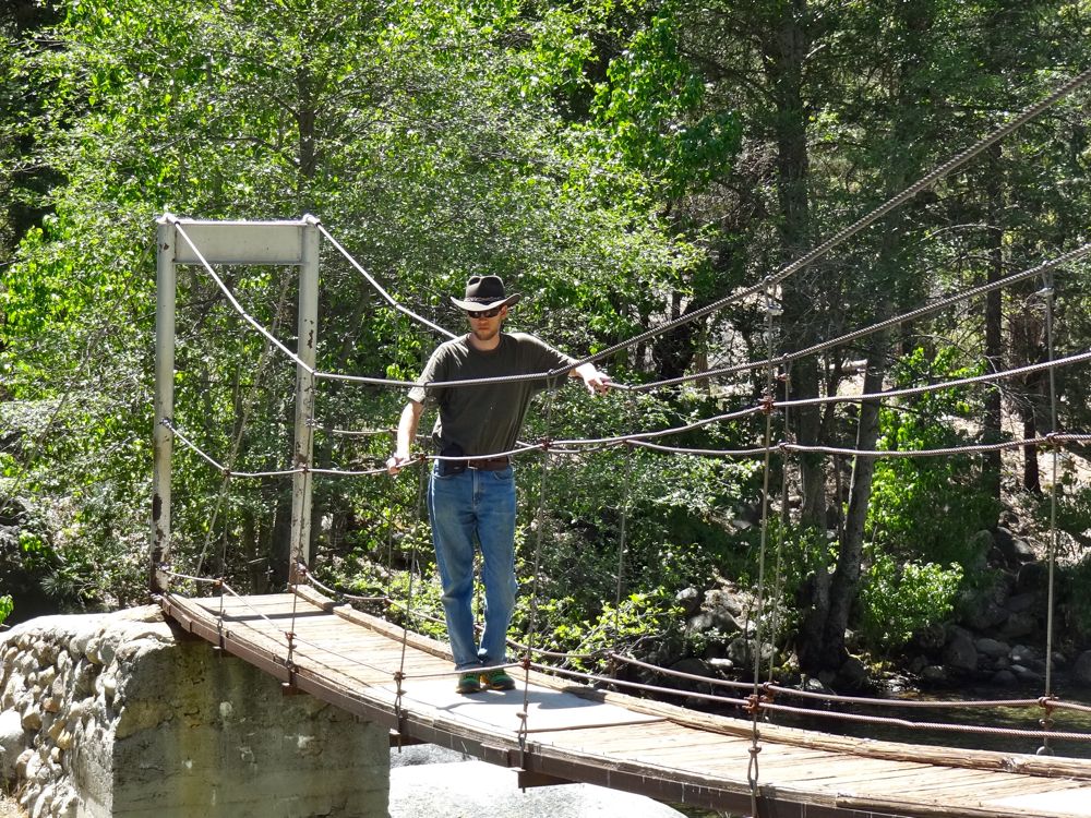

I'm in the design phase of building a suspension bridge (footbridge) across a year-round creek on my land. An earlier bridge got washed away in high water 2 years ago. This one will be higher off the water and stronger. I had designed a wood bridge but now I'm thinking a partial metal design would be better.

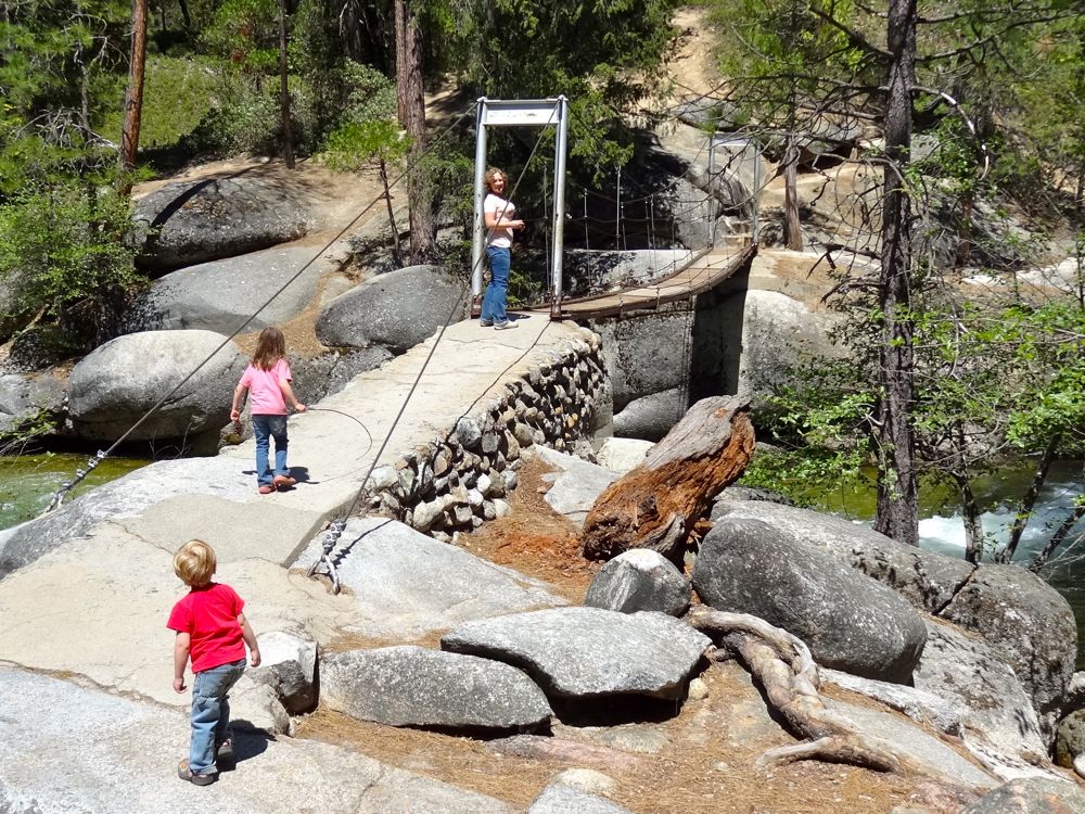

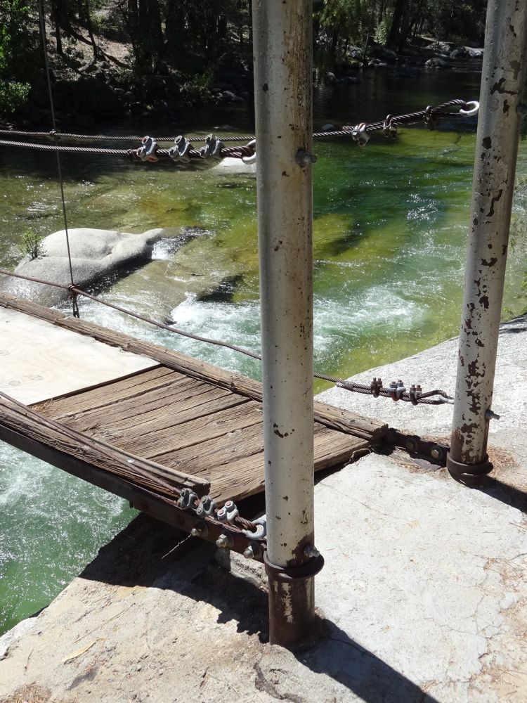

While taking a hike in Yosemite this week, I came across this bridge and I liked some of its design: They used 2-3" angle-iron longitudinally under the horizontal planks, and horizontal angle-iron under that for attachment to the support wires. Pretty simple design and easy to bolt together. Lighter than wood. I would make the end posts taller (12-16') to alleviate some of the sag in the middle. I'm including some pics and my calcs. I'd appreciate any input (especially from any engineers).

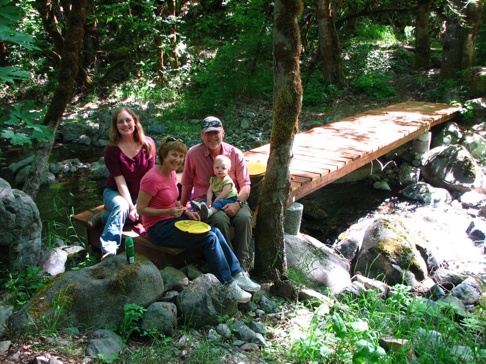

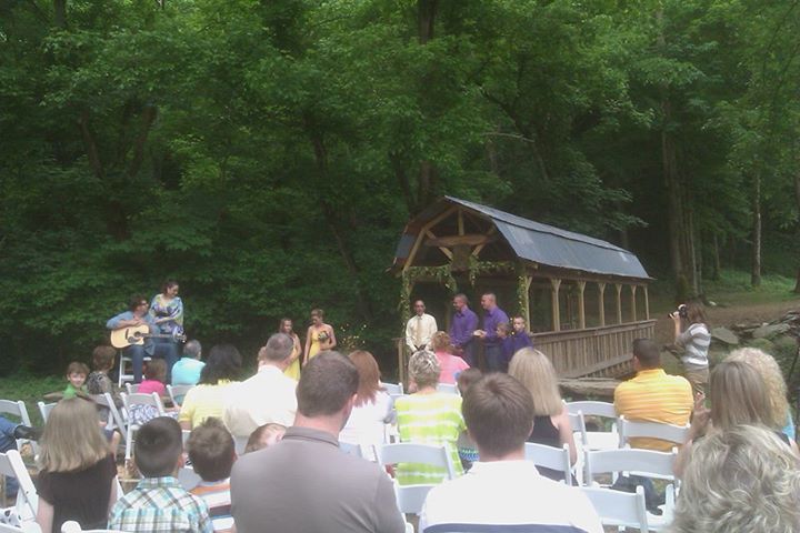

First bridge (pardon the wife and in-laws on the bridge):
Washed out in high water:
Interesting bridge design in Yosemite:
(yes, that's me on the bridge)

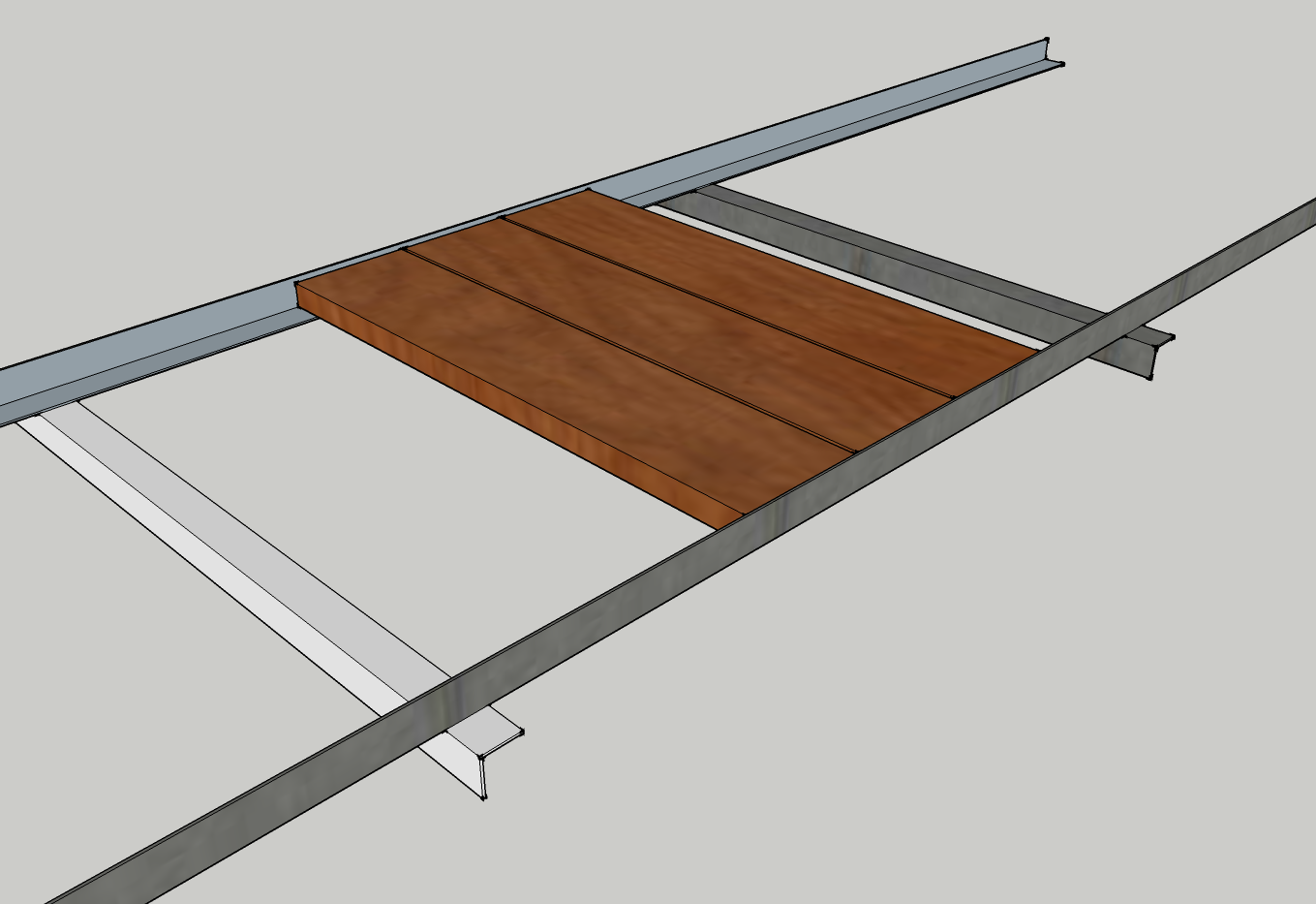

I'm thinking 2 x 2 x 1/8" angle iron would be plenty strong. Here are the calcs:
I = Moment of inertia = 0.19 inch^4 in directions Ix and Iy
E = modulus of elasticity for steel = 30,000,000 psi
Deflection over 4 ft (force at center) of 500 lbs:
= 500 * (48)^3 / (192 * 30,000,000 * 0.19)
= 500 * 110,592 / (192 * 30,000,000 * 0.19)
= 0.0505" or approx 1/16"
Over 2 pieces of angle:
= 0.025" or approx 1/32"
That's seems a very small amount of deflection and would seem to be acceptable?

OK, I wrote a bunch of stuff and then deleted it . But anyway, I think you're using the wrong deflection equation. Can you post a drawing of what you're trying to calculate?

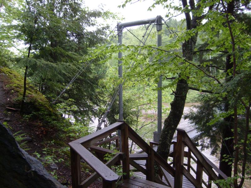

Thank you, BTDT, for the link to your thread. That's basically what I had in mind. You went longer spans than what I had in mind for each segment, both longitudinally and transversely. And I don't plan on driving my tractor across it.

CliffordK, this is just a small creek that feeds into Williams Creek, which eventually feeds into the Applegate River (tributary to the Rogue). Yes, it is a narrow canyon with fairly steep sides. It's normally a few inches deep and about 5-10 feet wide. The high water we've observed over the past 6 years has been 2-3 ft deep, and about 20 ft wide. Where I want to build the bridge is right next to the spot where we ford the creek with the truck and tractor. It would be a 40' span, 5' above the water.
The 1st bridge I built here was going to be a drawbridge, but then I never got around to installing the drawbridge mechanism. Of course, what happens in winter when you're not at home and the water is rising? Or what about when you're on the other side of the river and the bridge is up? Better to just build sturdy and high enough off the water.
When I calculated a 500 lb load above, that was just for a single 4 ft section lengthwise. I figured that was 2 big guys standing right next to each other in the center of a 4 ft span, and that could be repeated for the entire length of the bridge. The wood x-pieces wouldn't handle a bigger load, anyway. Or would they? I can't get a welder down there like BTDT did with the expanded metal. Everything I do will be just bolted together.

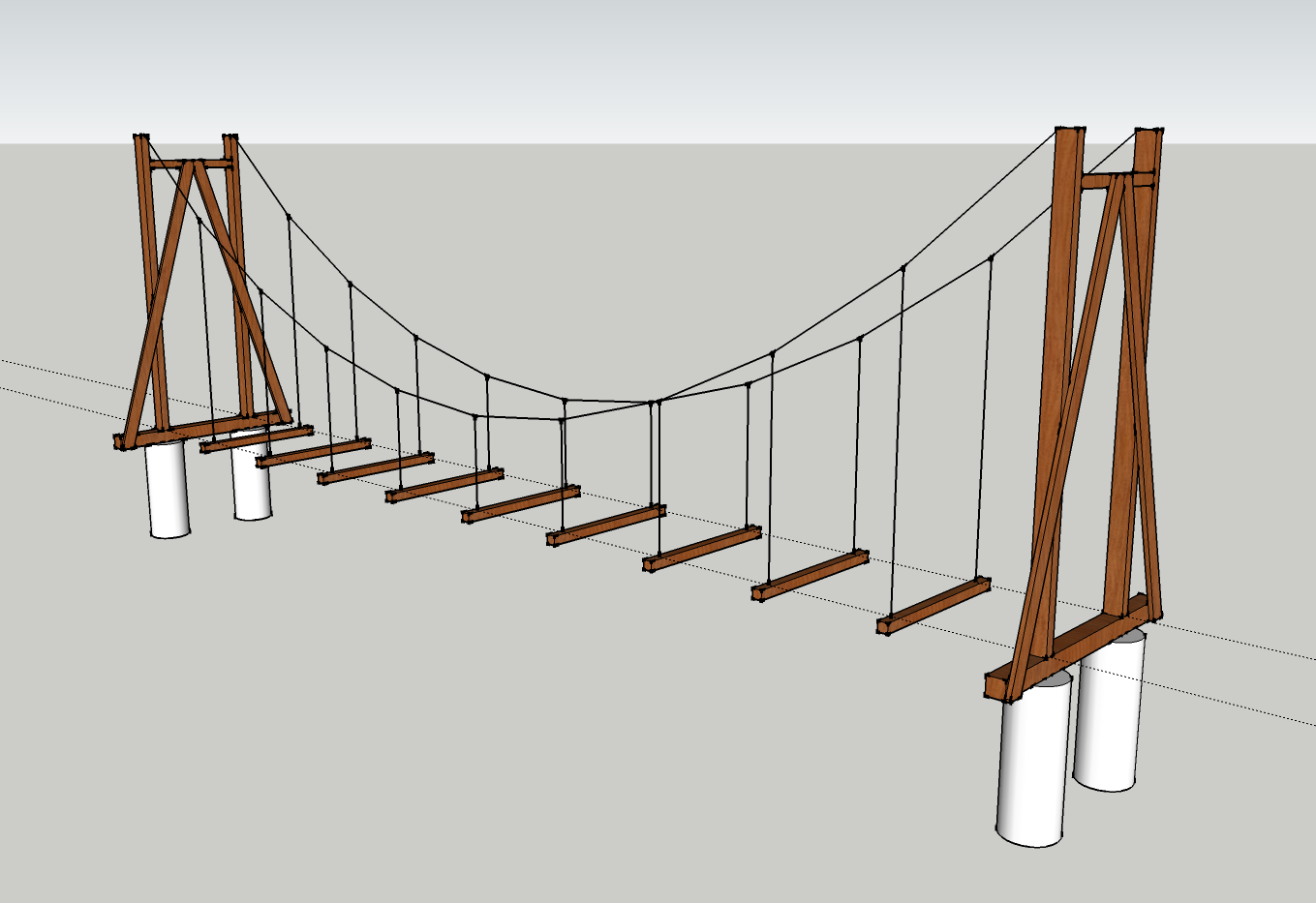

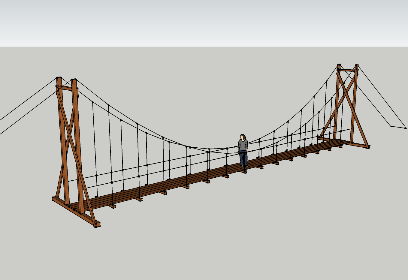

Here are some pics of what I was planning with wood. The concept will be similar except with 2" x 2" x 1/8" angle iron for horizontal and longitudinal support.
