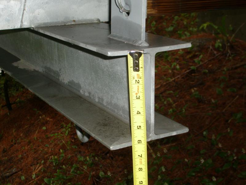

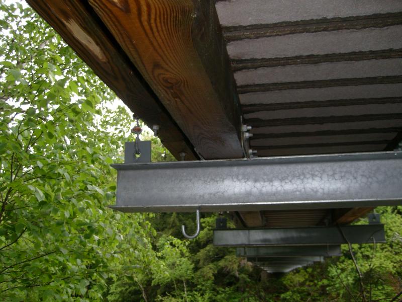

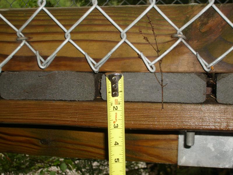

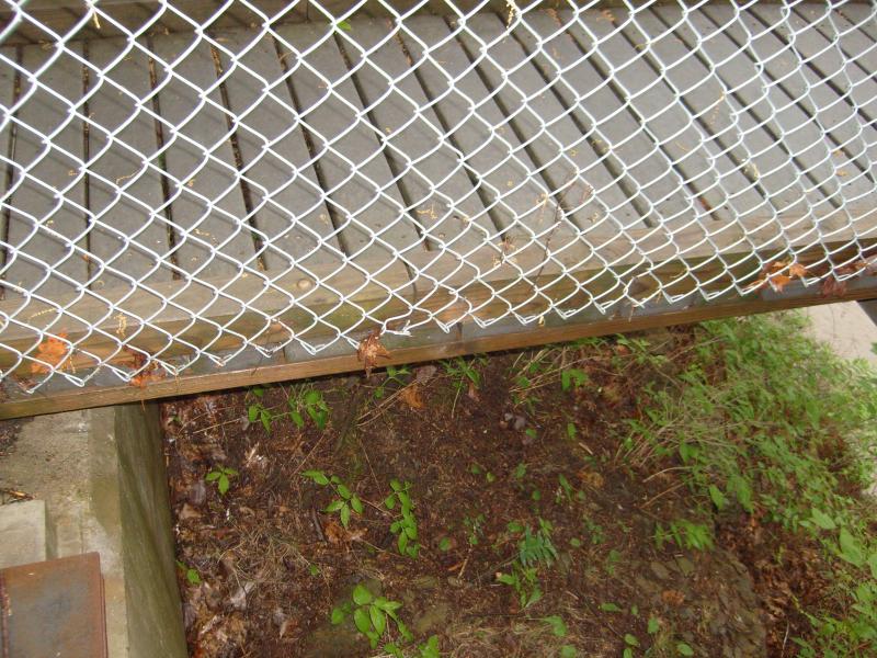

The actual walkway is made up of composite boards 1 1/2" thick. They have two PT 8' 6"x6" posts used to support the load between the i-beams. They are about 36" apart. The composite decking is sandwiched by a PT 8' 2"x4" and 8' 4"x4" on each end.
footbridge4_zps6f459403.jpg footbridge11_zpsdb04b123.jpg footbridge10_zps552a1903.jpg footbridge8_zps3792637f.jpg
   / Suspension bridge design #22
The i-beams are "S" beams, I would have expected "W". I think they are posts for guard rails and are 5' long.

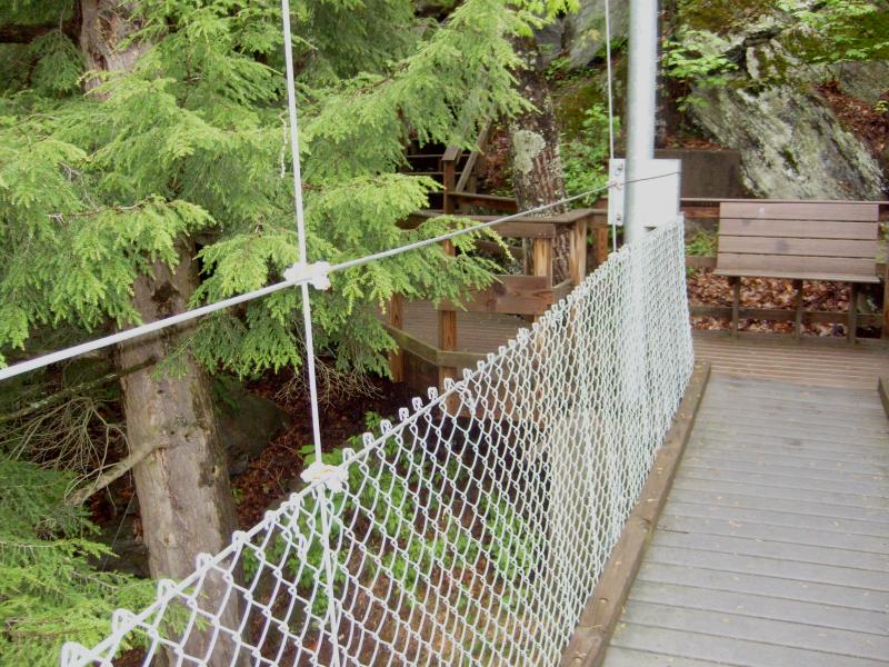

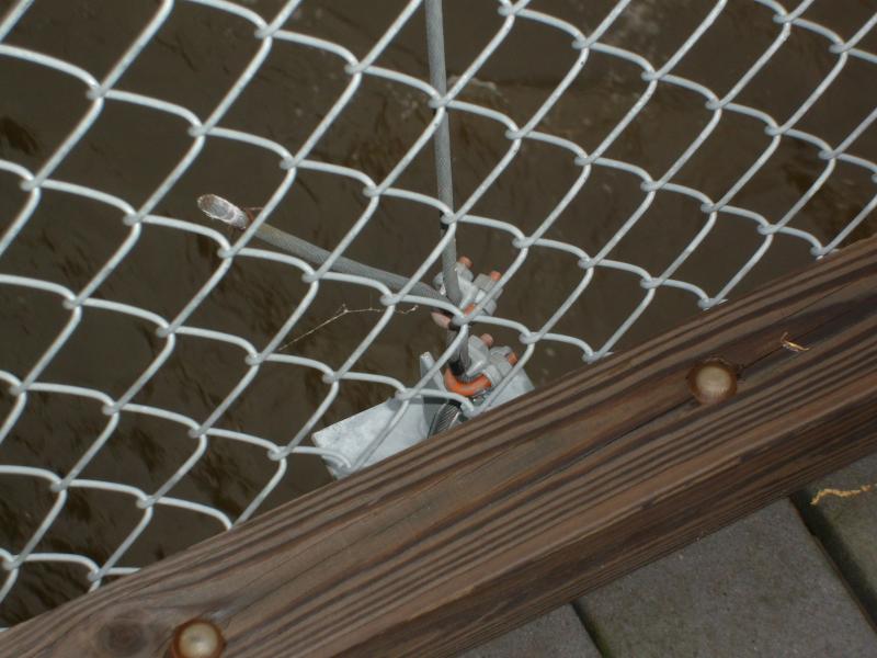

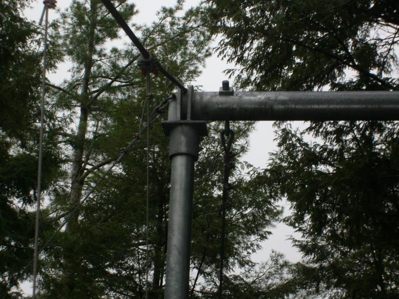

Here's a few other random pictures.

The ends of the two 1 1/4" cables are anchored to ledge on each end. I thought I took a picture but I guess not. It looks like it's anchored to the ledged and then they poured a cement slab on top of it.
#25
That is awesome! Way overkill for my purposes, but really cool none-the-less. Wow, 1 1/4" cables is huge -- extremely difficult to work with. And I thought 1/2" cable over 70' distance was heavy. My wife (and I) wouldn't like the chain-link on the sides. It also looks like they double anchored the end deadmen. Thank you very much for the pictures! More ideas....
