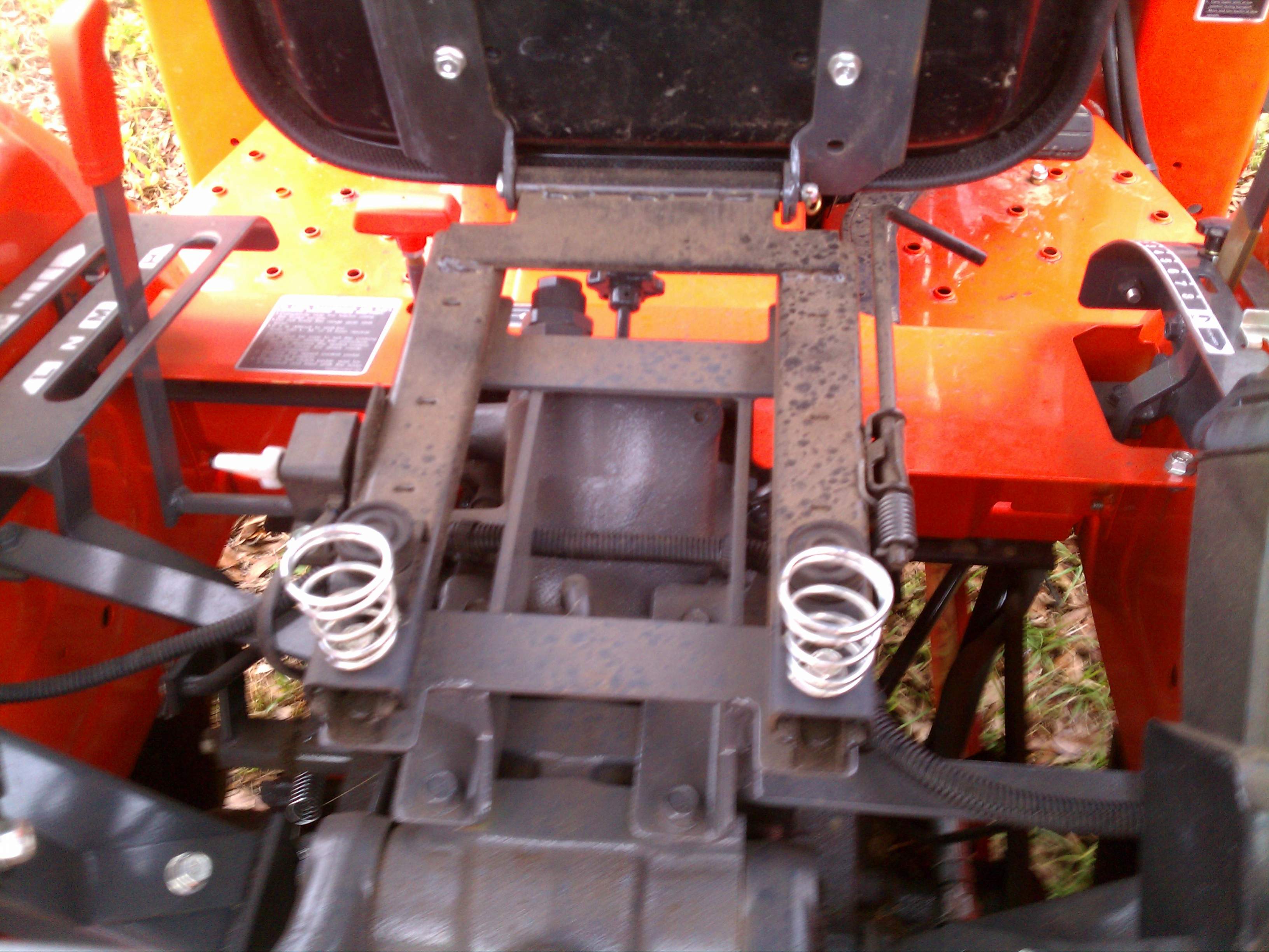

sbohan, Can you show a photo of your seat area? I would sorely miss the extra 3 to 4 inches in height that the suspension seat gives. Call your dealer and see how much a L2800 suspension seat would cost...

Sure here it is....

I guess that was the "almost 100% sure" part I was talking about..
I knew Kubota trimmed a few corners when they built the L3700, but I didn't think that was one of them.
It's a shame, really. The suspension seat is one of the nice features of the "economy" L-series, especially for those of us that have rough fields.
It's worth calling your dealer and asking about the upgrade, but I think the price will scare you. Nothing for a Kubota is ever cheap, at least not in my experience. From what I can see you need a different seat base, OPS switch, the T handle and screw assembly, plus springs and linkage. The seat itself is probably the same.
You may be able to adapt an aftermarket suspension seat and spend considerably less in the process.
Sorry we can't be any more help than that.

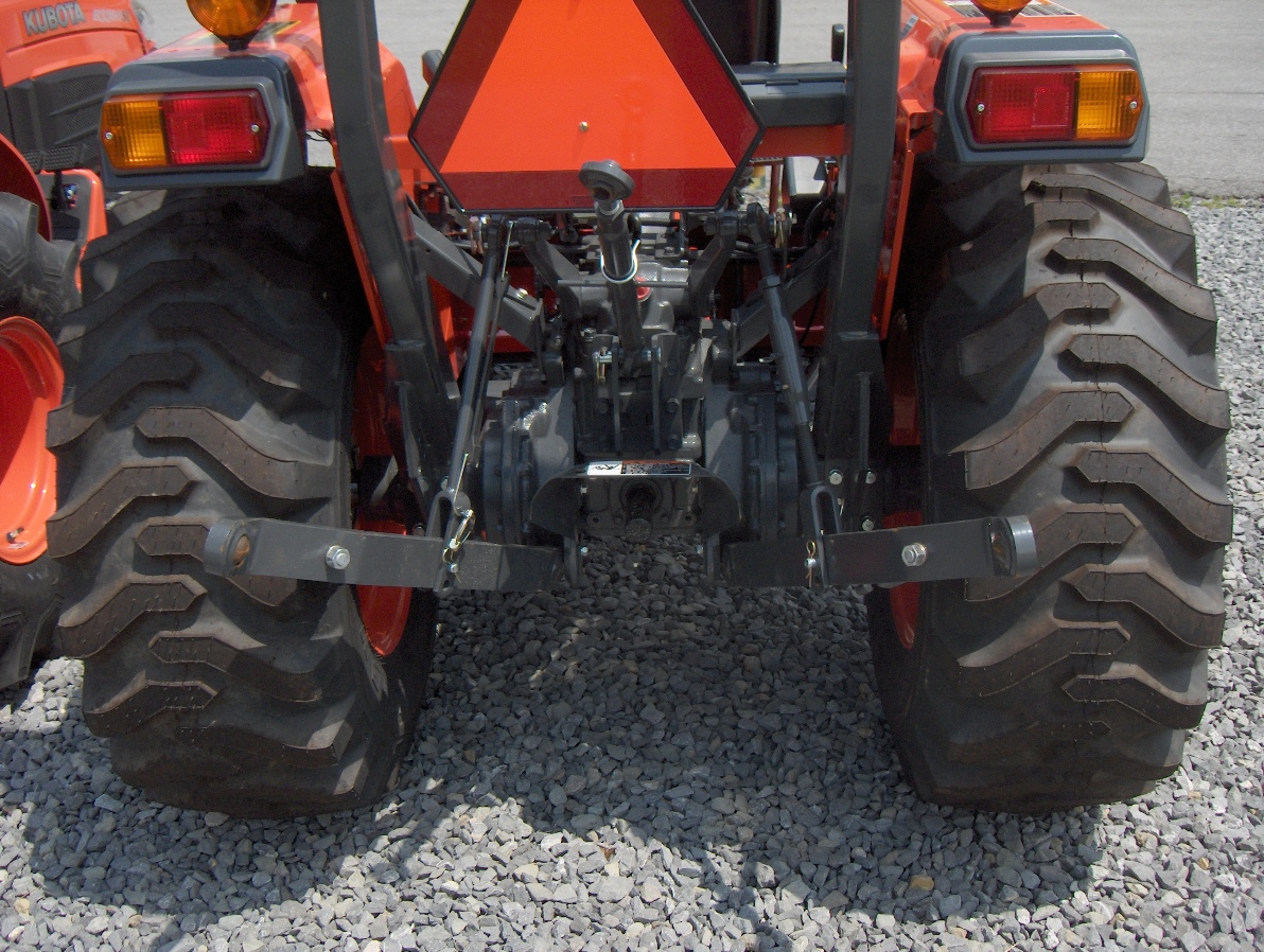

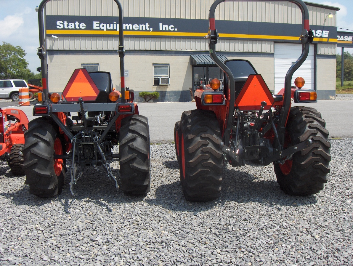

I found a picture another member took of an L3700 from the back. If you download the pics and then zoom right in, you can see there's not much under the seat base.
While the SMV sign blocks some of the view, I think it's missing the suspension seat as well. Maybe some had it and some didn't ?
At least tflt got his working after all this time.
Sean
