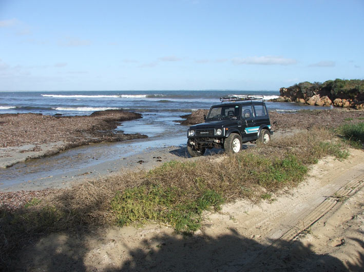

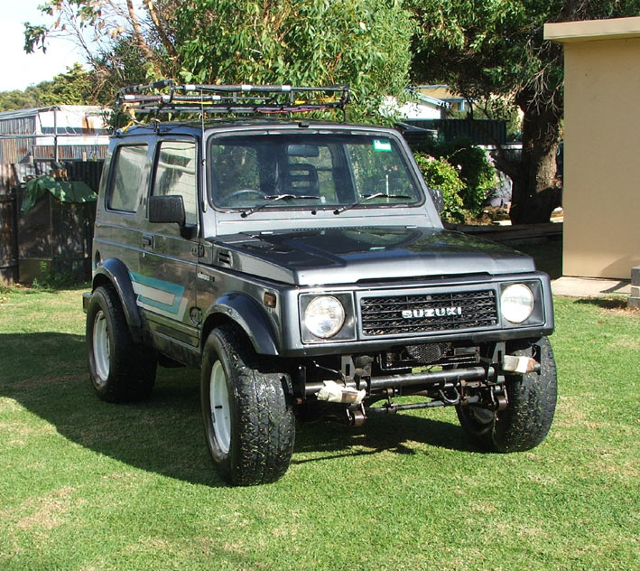

Over here they are called Sierras. Mine's an 89. I keep it at our beach shack. (A neighbour there also has one - a mean looking, jacked up, soft top). These are near perfect for beach driving. Never gets bogged. Launches a 15ft fibreglass boat off the beach just fine. Original wheels were just a bit skinny and it struggled in really soft sand. I fitted 15" F-100 rims I got from a wreckers. The tyres were off my 91 Mitsubushi Pajero. (I think you call 'em Montereys). These wheels will float over anything, but the speed limit is about 35 - 40 mph before the wobble gets so bad the car is seriously uncontrollable. These things definitely do not like going fast in wide wheels. I had to weld some extensions to the bumper mounts to move it about 3" forward. (Not shown in these pics). Now I only get occassional rubbing on a guard when i hit a bump if I'm turning. One day I'll jack it up an inch or two, That should eliminate any rubbing. Very few mechanical problems. Its done a LOT of miles so now i use the oil that reduces smoking. I've replaced one alternator that was squealing. The replacement is now doing the same so I'll have to give it a good grease-up soon. Sealed beam headlights blew regularly so I fitted a couple of spotlights to the bumper instead. The transfer lever got stuck in neutral once. This is not an uncommon problem. Its easily unlocked by briefly removing the lever. (Sing out if you want to know how). The channel that retains the plastic mouldings along the side is a real rust trap. I removed mine by grinding through the spot welds that hold it on. Be generous with water dispersant spray under the bonnet. Check and clean the clip connecters near the coil and mounted on the firewall. Dirty ones can stop you dead.
The only complaint I have is that 1st gear in low range is too high for such a low powered donk. Its difficult to get over rocks smoothly. I would love a set of crawler gears!
Ah... I see RollTideRam has covered some of these points too. Have fun!
