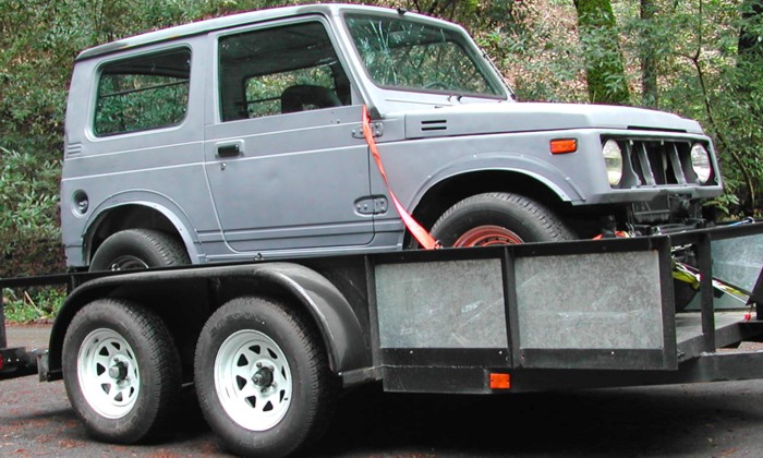

Interesting article. Thx for posting. If I get a fuelie Sami , I will look for that
capacitor problem. The 91 in the article is just a thottle body FI system,
not the more desireable port FI 1.6.
My own 1988 project vehicle was a tintop and cost $500, plus $200 CA state
penalties for expired registration. I scrapped the top and sold the parts I
did not want for a total of $350, so that helps. With my full frame-mounted
roll cage, my total vehicle weight is only 1250# so far. With the body off,
the tiny Xfer case and trans are super-easy to remove. Very nice rust-free
box tubing frame, too. I am using new tractor suspension seats since the
pan is welded to the frame.
