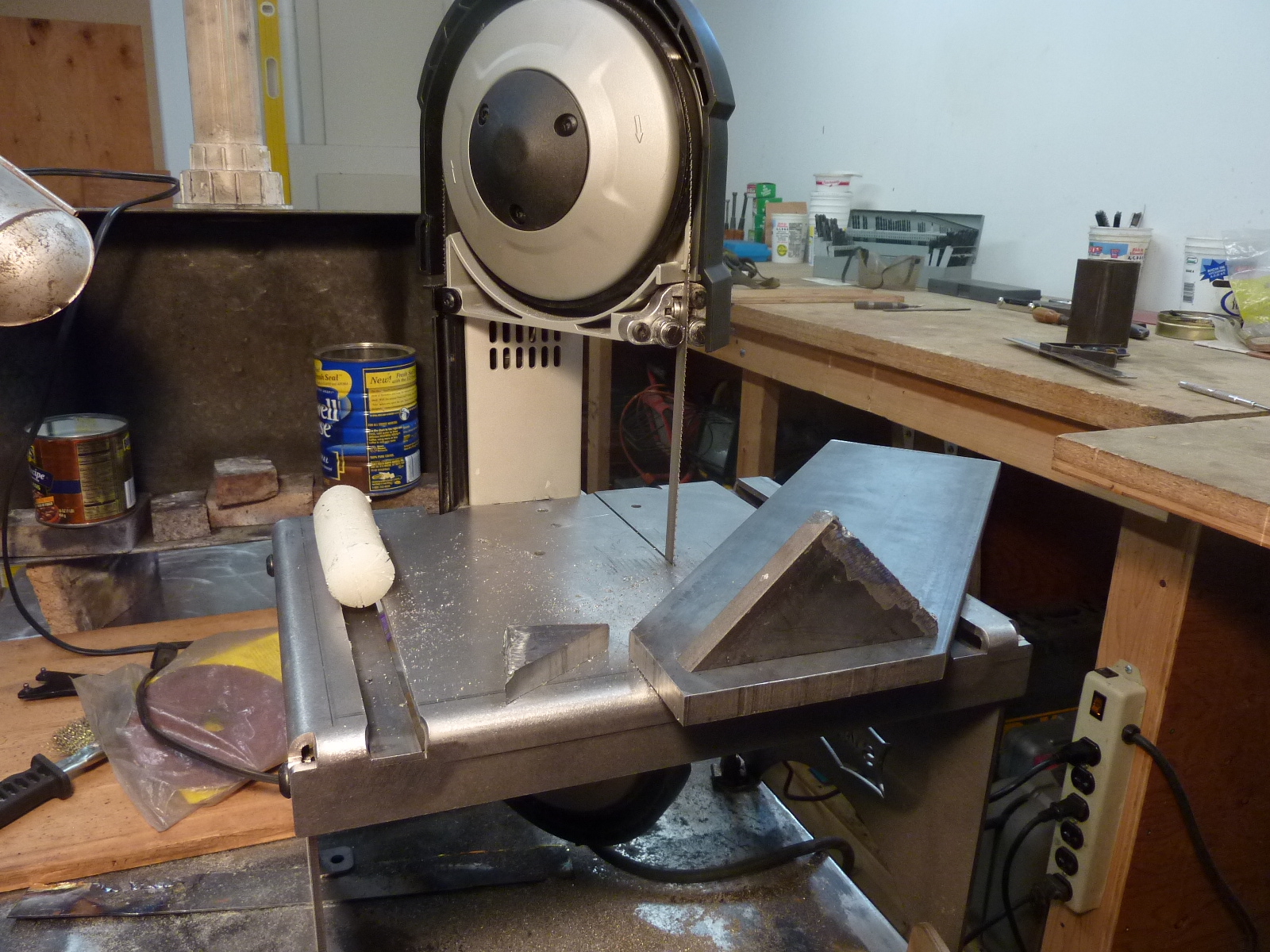

Just a update.
Here are a couple free hand cuts I made on some 1/2" mild plate 5"wide with a 10-14 TPI blade and a blade speed of about 285 SFPM. I am really happy with the saw and table.
