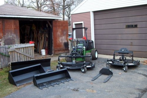

My PT425 is articulated.... I'm fond of those, too. :)
507461d1493273833-swinger-articulated-loader-pt425mainpic-jpg
