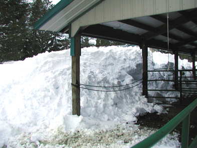

I did look at them, but i have to be able to swap between a plow and a blower without alot of effort. I have 2-1/2 miles of association roads that i have to have plowed before 6am. Didnt want the hastle of the drive shaft. The second reason is that when my barn sheds, i have a HUGE pile of hard pack snow to contend with . The ability to raise and lower my blower will help alot.
