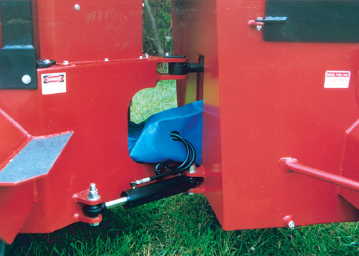

Now that I think about the two cyl, our Power-Trac's steer the front section by using two equal cyl through a steering motor/valve like this. Both cyl mounted the same. We turn the steering wheel and the steering valve pushes the fluid where it needs to be. This system has worked successful for a good number of years, in mining and on the Power-Tracs.
Surplus Center - 5.9 CU IN STEERING VALVE (TORQUE GENERATOR)
No matter which way you steer, the fluid is gong into one chamber of both cyl, the base end on one of the cyl, and the rod end of the other cyl. The exit speed of the fluid does not matter.
Do you really need equal pressure, force and movement.

/ Synchronizing two cylinders
#11
On that loader those cylinders are in a way "attached" to each other. If one starts to move the other has to move because they're both attached to whats moving. Mine weren't, I had no tie rod between my tires, so the tire that was easiest to move (the one where the cylinder was extending) always moved first. Once that cylinder was extended the other would retract.
/ Synchronizing two cylinders #12
There is no tie rod on the PT. One cyl pushing one way and the other pushing the other way.
The fluid flow to each cyl is done in the $500 steering valve.
#13
Correct, but because those two cylinders are attached to what is moving they are forced to move at the same time and be synchronized. It has the same effect as a tie rod would have had on my system. My cylinders were controlled through a steering valve like you posted also.
