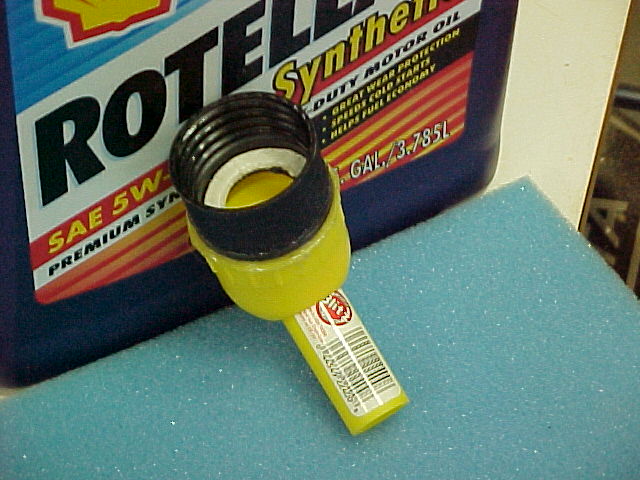

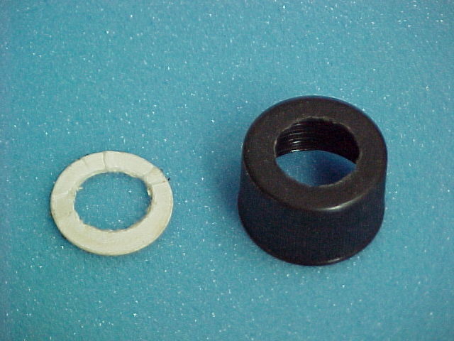

If you take the original (Rotella) cap and spend a couple minutes at the drill press, you could end up with this.
   / Synthetic Diesel Oil... #85
Hot glue on the mating surfaces and a bead around the edge connects the lid to the pour spout. Be sure to tighten lid (with gasket in place) to determine which part of the cap ends up in front before you glue.

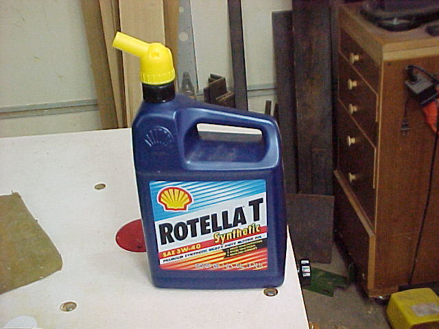

Finished product. With reasonable care, the hot glue should hold. Keep the spout closed until the jug is in the pour position, ready for action, and spillage should be minimal.
This may not be the ultimate solution for you. I also use funnels when necessary, but I clean them up when I'm done, and the spout requires less clean up. Good luck.
OkieG
