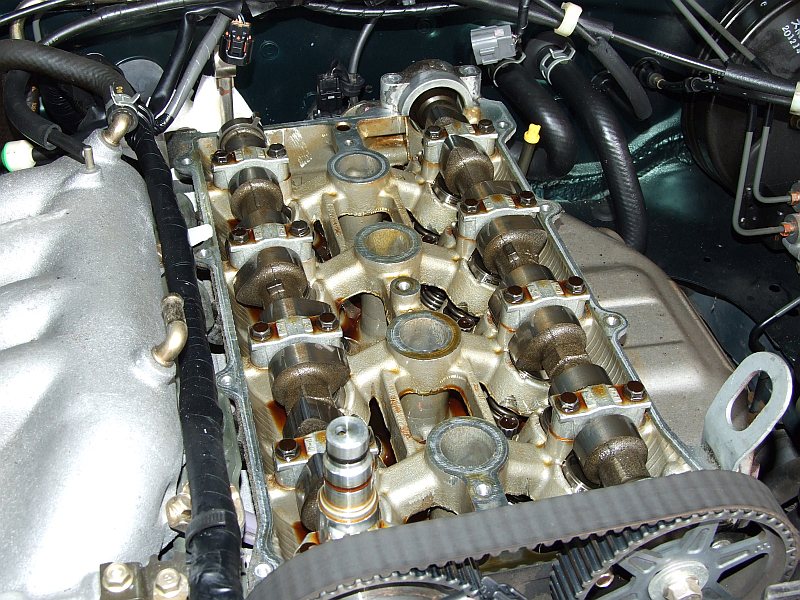

We all have our preferences but how many of those are based on anything more than anecdotal evidence? Have never ran synthetic nor have seen a need to in the areas where they out perform dino oil. Have been twisting a wrench on my own cars for >50yrs. I typ change oil at ~7k miles, including filter. I am old enough to remember when 1k mi oil changes were the norm. Have never sold a car with less than 150k miles. Last car sold, a Sentra had >250k mis on it and never an engine problem. When I sold it I wouldn't hesitate making a cross country trip with it with nothing more than filling the tank.
Last time I had to do any real work on one of my cars was last yr when I needed to change the timing belt. Here's a pic of the valve train, ~125k miles on the car. Where's the sludge, varnish, etc? All the discoloration is from pooled up dirty oil.
After I start seeing engine problems from using dino oil, then I'll start thinking about synthetic.
