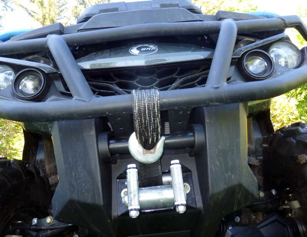

The poly strap on our machine

A flat strap winds straight onto the winch, as one would imagine? If so, it makes your winch a lot weaker when the reach is short, versus when the reach is long.
If used for skidding longs, in situations where tire traction is sufficient to keep the vehicle planted, this might mean running out of pull strength as the log gets close on a smaller winch.

There is just 10ft on it and its real job is plow lift. If I need to winch something further away, I have a poly tow rope in the tool box as an extension. Haven't used it yet.
