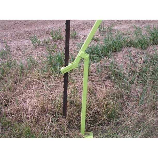

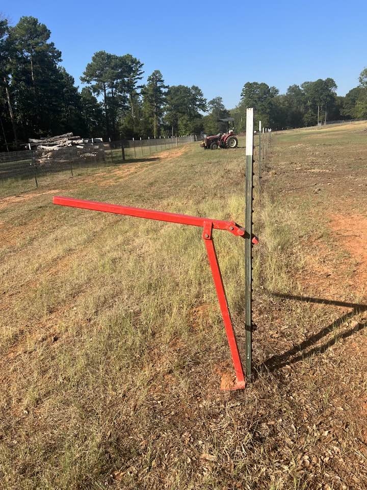

I have a Speeco t-post puller plate that works good with the loader and chain. Mostly I use it with the high-lift jack though.
Amazon.com
I use one similiar to yours, but I don't remember paying $25 for it ( but that was several years ago). Getting on / off the tractor to move on to the next
T-post is the most work when working alone. For few posts I can deal with it. But I wouldn't want to work alone if there were a lot of posts to pull .
Cheers,
Mike

Several devices like this
They work fine....
