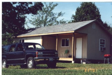

Built my cabin using OSB smart siding. I would not hesitate to use it again in Northern Missouri. It is also treated to resist wood eating insects. Only hard thing is driving nails through it. Hard resilient stuff.
