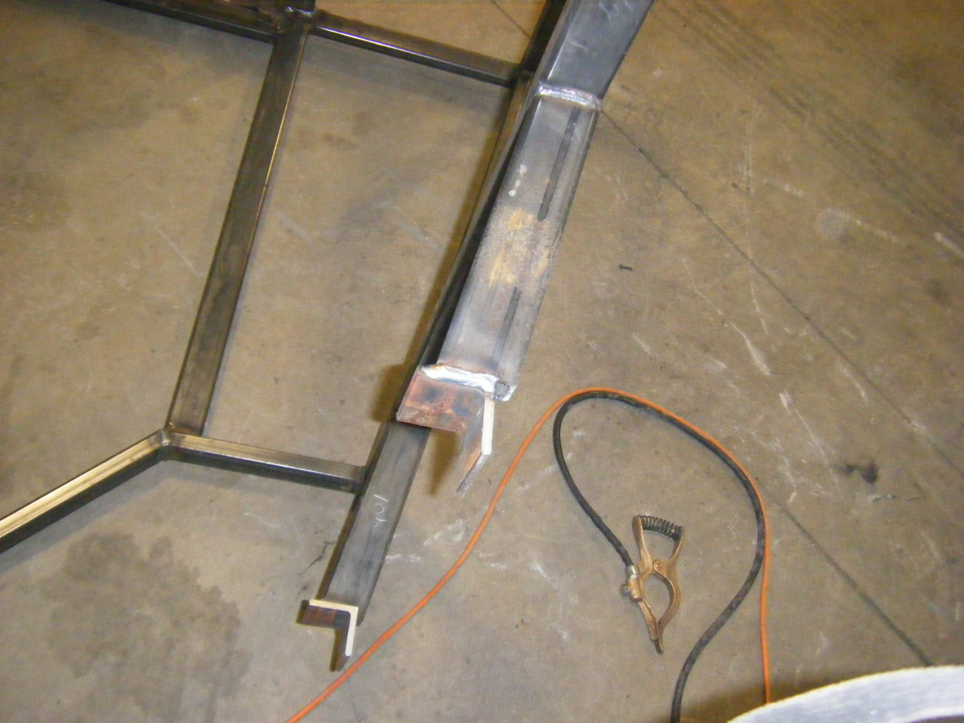

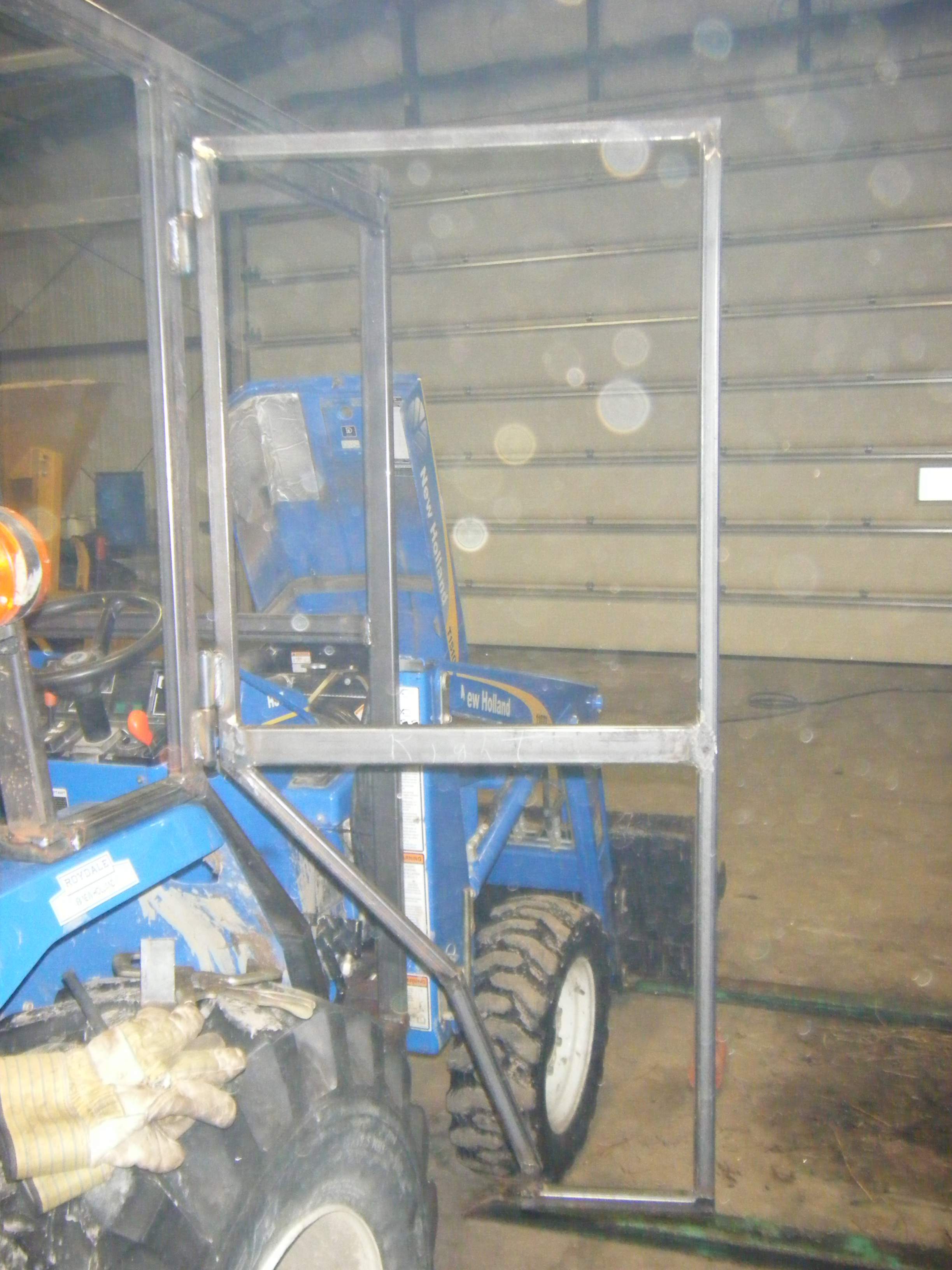

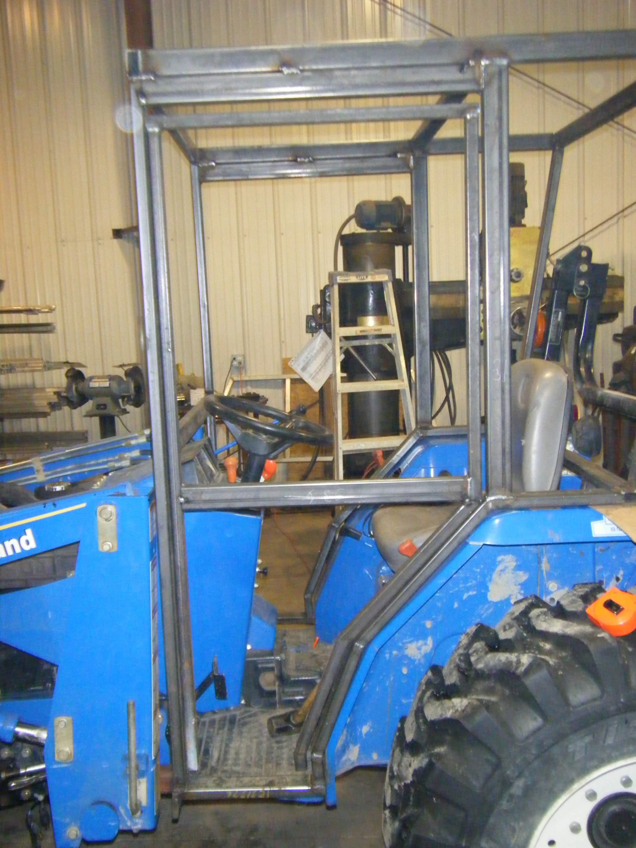

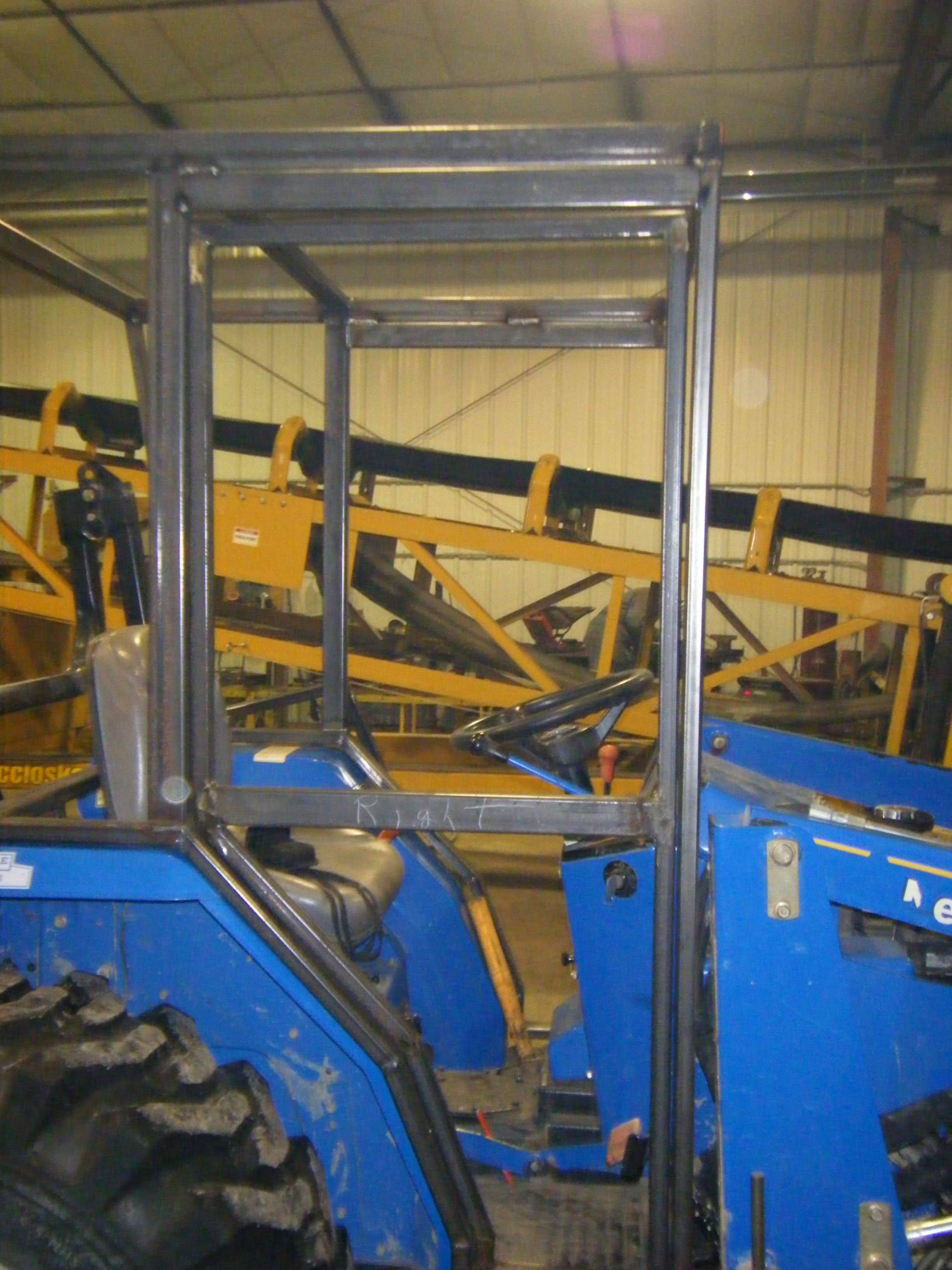

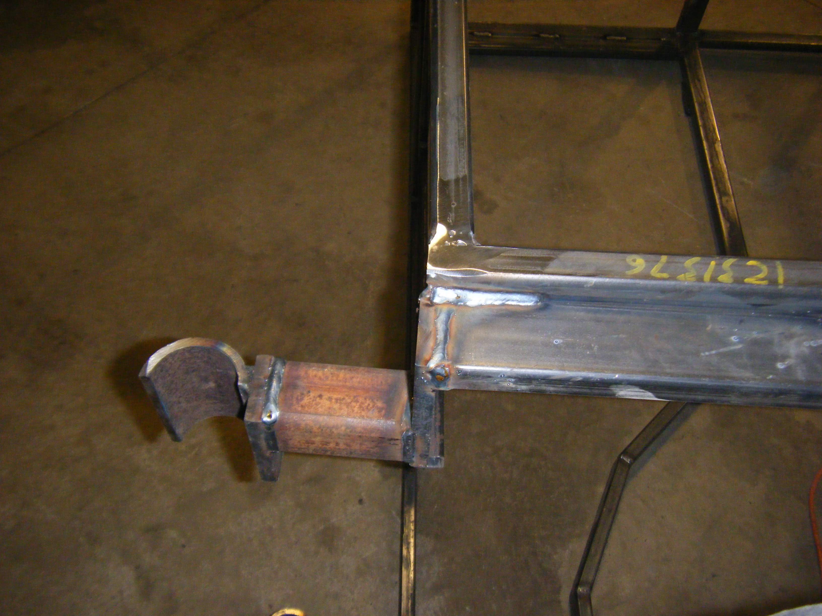

I purchased a t1510 New H DSCF5030.jpgDSCF5033.jpgDSCF5034.jpgDSCF5035.jpgDSCF5037.jpgDSCF5039.jpgolland several years ago and when it came to blowing snow when I was finished I always looked like a snowman no matter which way the wind blew.So I finally decided to put a cab on my tractor. I looked at purchasing a sims or other jobber cabs but 5000 to 10000 dollars just seemed like a lot of money for what you were getting considering the cost of the original tractor and what you were getting there. I have a friend with a welding shop and I am a retired welder so we decided to have a go at it. I will try to post some pictures as we progress. In these first pictures we built the basic frame , note the round pipe brkts built to sit on the front end loader brkts and the rear sit on the cross member behind the seat.

It looks like you are intending to make this cab easily removable should the need arise. You're lucky to have lots of straight lines on the fenders, etc to make your fabrication life easier.

Well you sure didn't forget how to weld! Very nice. I'm coming down the home stretch on a cab right now and have found it takes more time than I thought it would. I'll have around 150 hours in mine when complete. It will be worth every penny and hour spent.

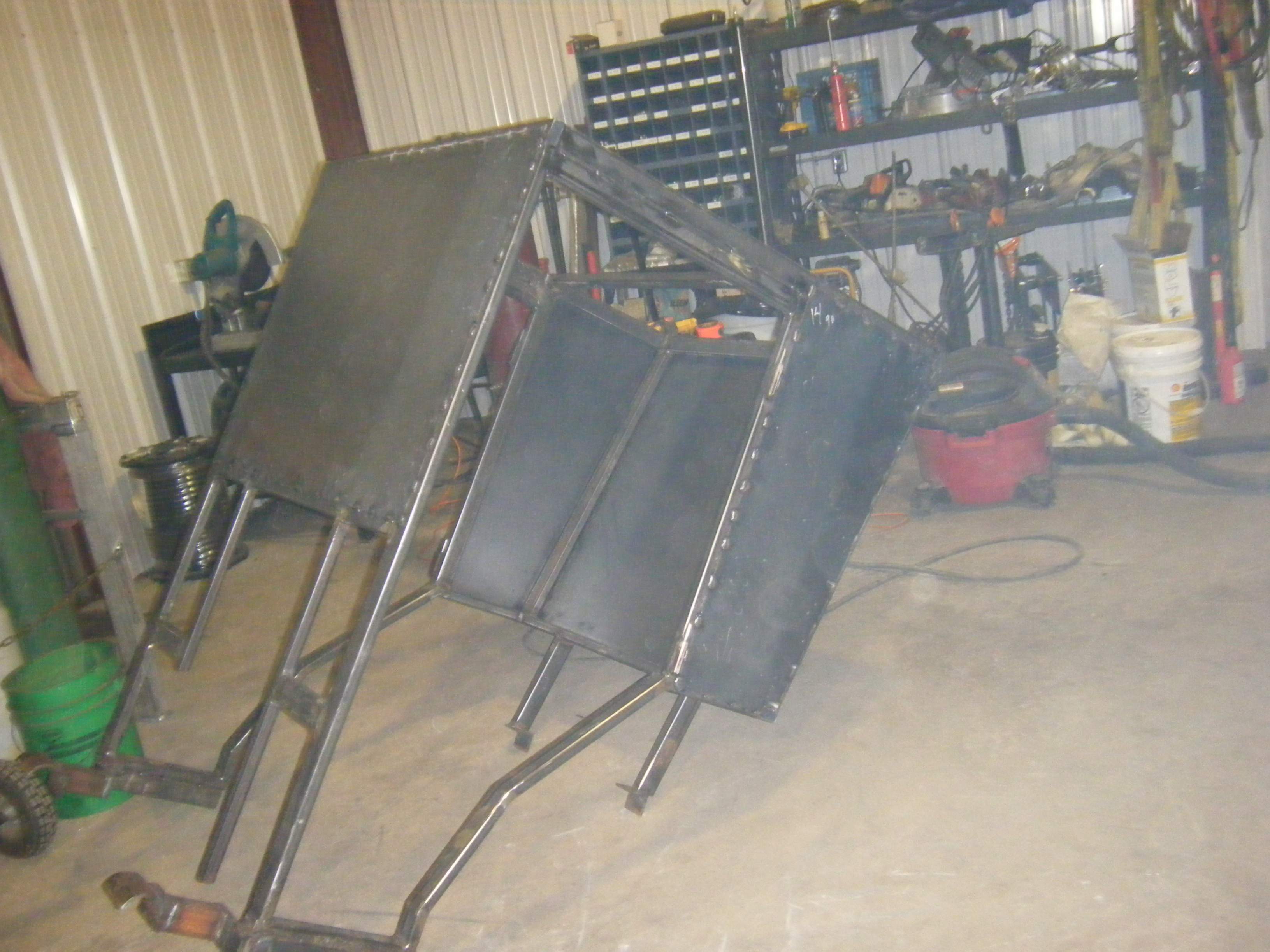

started doing the skinning today, got most of it done, we used 14 gauge material spot welded, then plasma cut out the windows and ground all the surfaces. I am new to posting material as you can see by the screw up with the pictures. try to to better this timeDSCF5041.jpgDSCF5042.jpgDSCF5046.jpg

14 gauge skin is pretty stout stuff. I'll bet you could have saved weight and cost by going 16 gauge or even 18 gauge.
In any case it looks like your cab is coming along nicely. Please keep posting pictures of your build. If you can, I'd use glass instead of plastic for the windows as glass won't scratch like plastic will.
