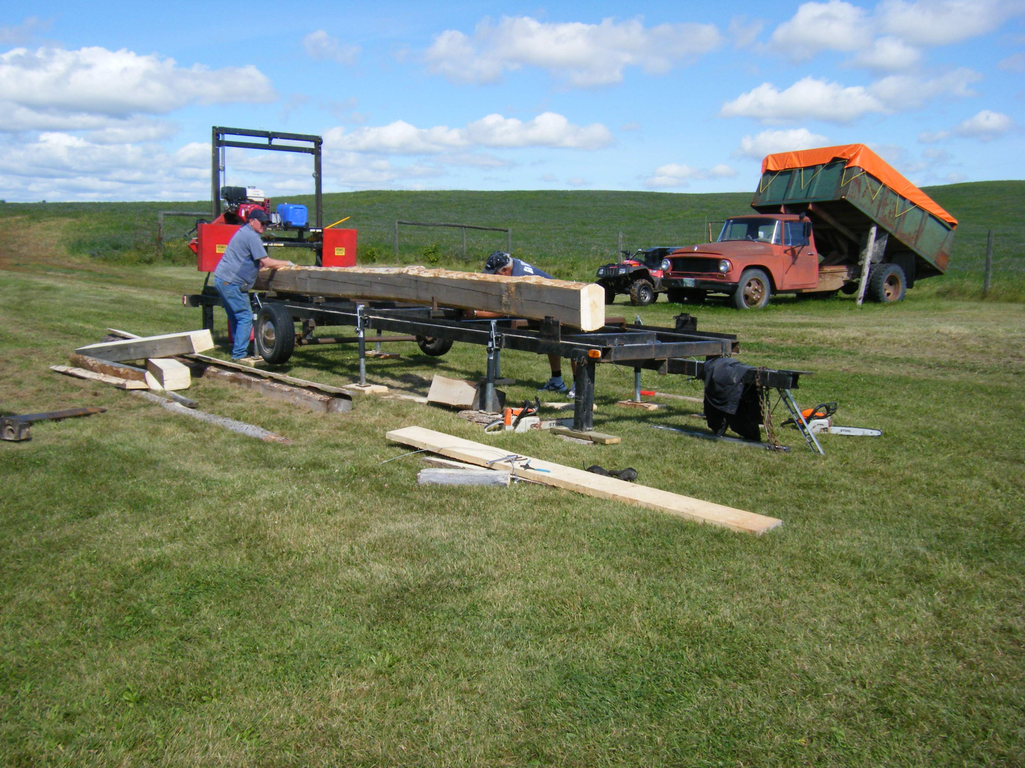

Hope you have as good service out of your 1510 as I have with mine. Two years ago we in are retired infinite wisdom decided to build a log cabin. We purchased our own saw mill and went at it. We used our 1510 for all the loading and unloading the mill. most of the logs were 18" in dia and 16' long. the loader handled these logs, the hydro trans was a must for creeping up to the mill to load. The summer we built it we had 43" of rain over the summer ,buried the tractor more times than I can remember but the front wheel assist got most of the time. I also custom rotortill with 6' king kutter tiller. Its got a full load with that. No problems yet 710 hrs, just oil and maintenance ,wrong one flat tire on front.

I have pictures of the build to date but I think I would start a different thread for that. I have a burg mill and build the mobile carriage myself.I have attached a picture of the mill and loading logs during the rain 2010_0517logmilling0042.jpgcabin1.jpg

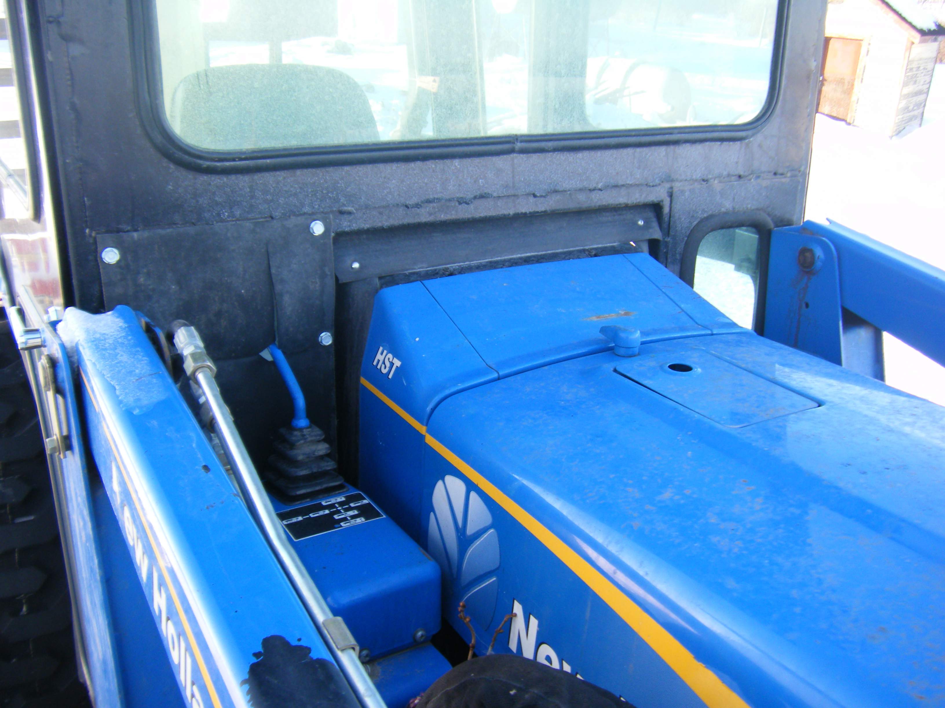

Finally got the last of the cab done, I found some seals from a large shop door for around the fuel tank and sides. for under the cab I used some seal from a railcar hopper door seal the I got from a supplier for cn worked great. All that I have left is the head liner and permanent wiring for the heater and radio and lights but not untill springDSCF5114.jpgDSCF5115.jpgDSCF5116.jpg
   / t1510 New Holland cab build #40
I was wondering how you were gonna close-in the joystick. Very nice build and everything looks great! :thumbsup:
