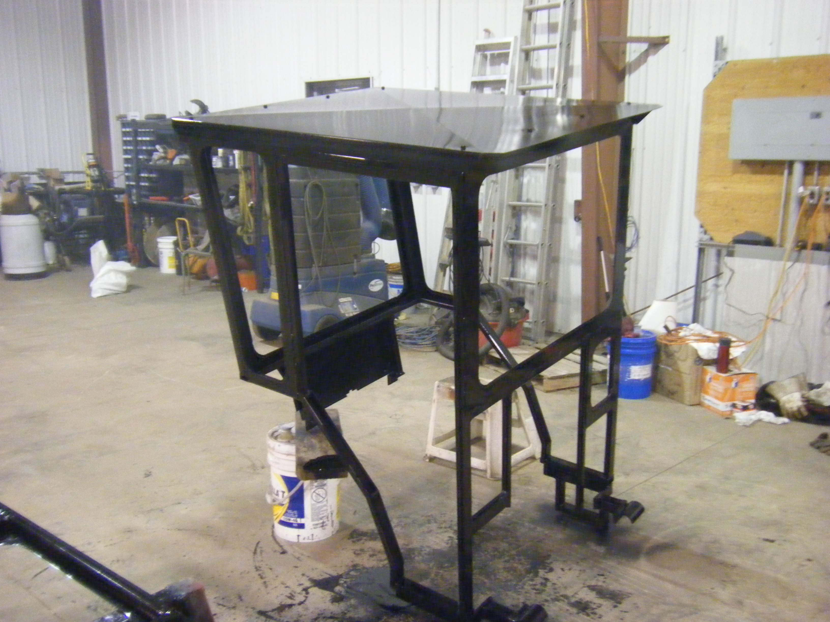

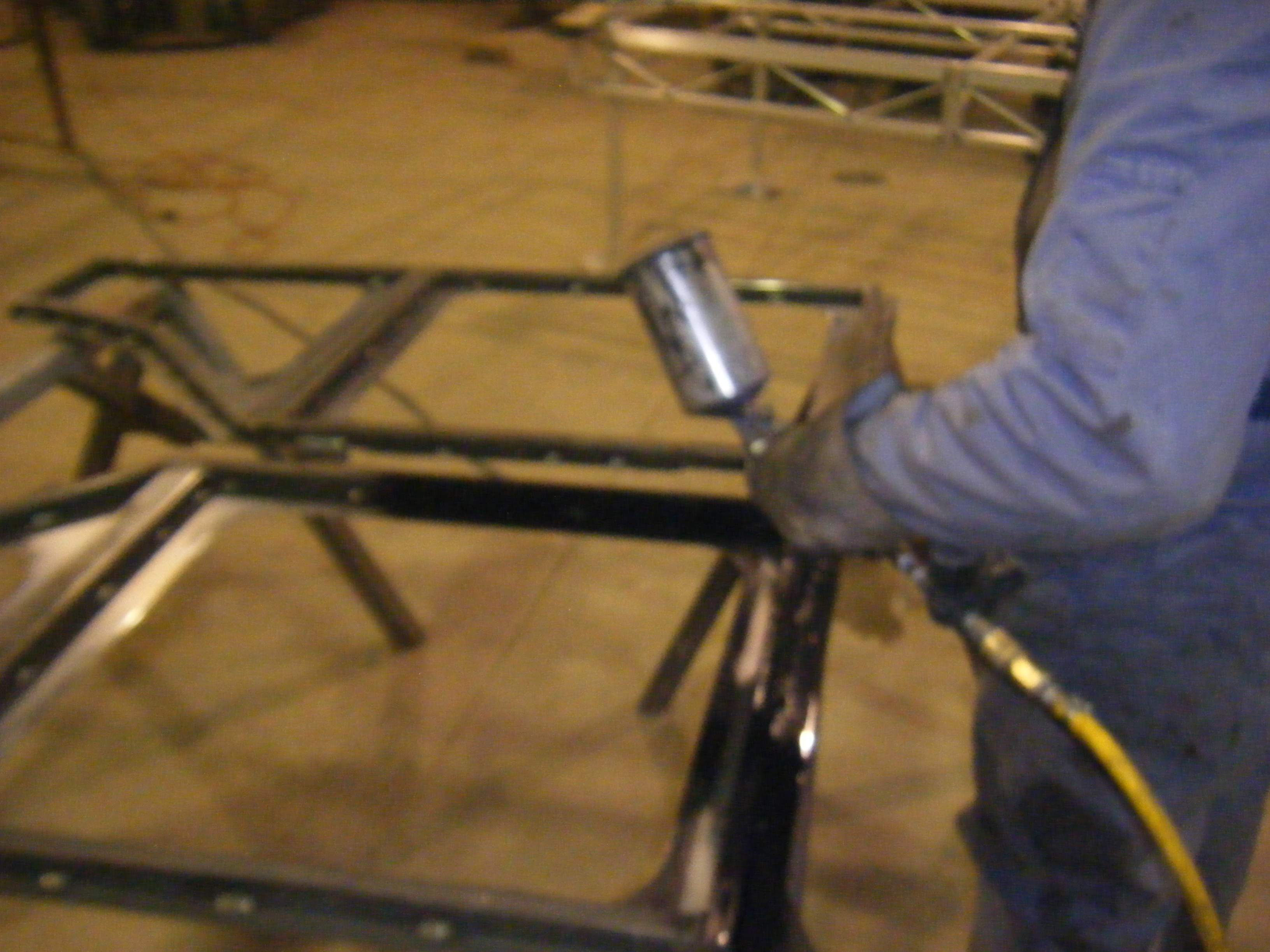

   / t1510 New Holland cab build #14
Very nice job. Looks very similar to a used cab I purchased from the local driving range; suicide doors and all. It was used to pick up golf balls at the range and had expanded metal welded to the cab frame.I bought the cab - more like a cage, for $50.00. After cutting away HUNDREDS of spot welds to remove the expanded metal, I was able to fit it on my B1750. I skinned it with orange poly on the lower half and clear on the upper. No heat, but all I need is something to shelter me from the wind. Worked well last winter.
   / t1510 New Holland cab build #15
Your cab is looking great and I like the "X" deformation in the roof to cut down on vibration and add some stiffness.

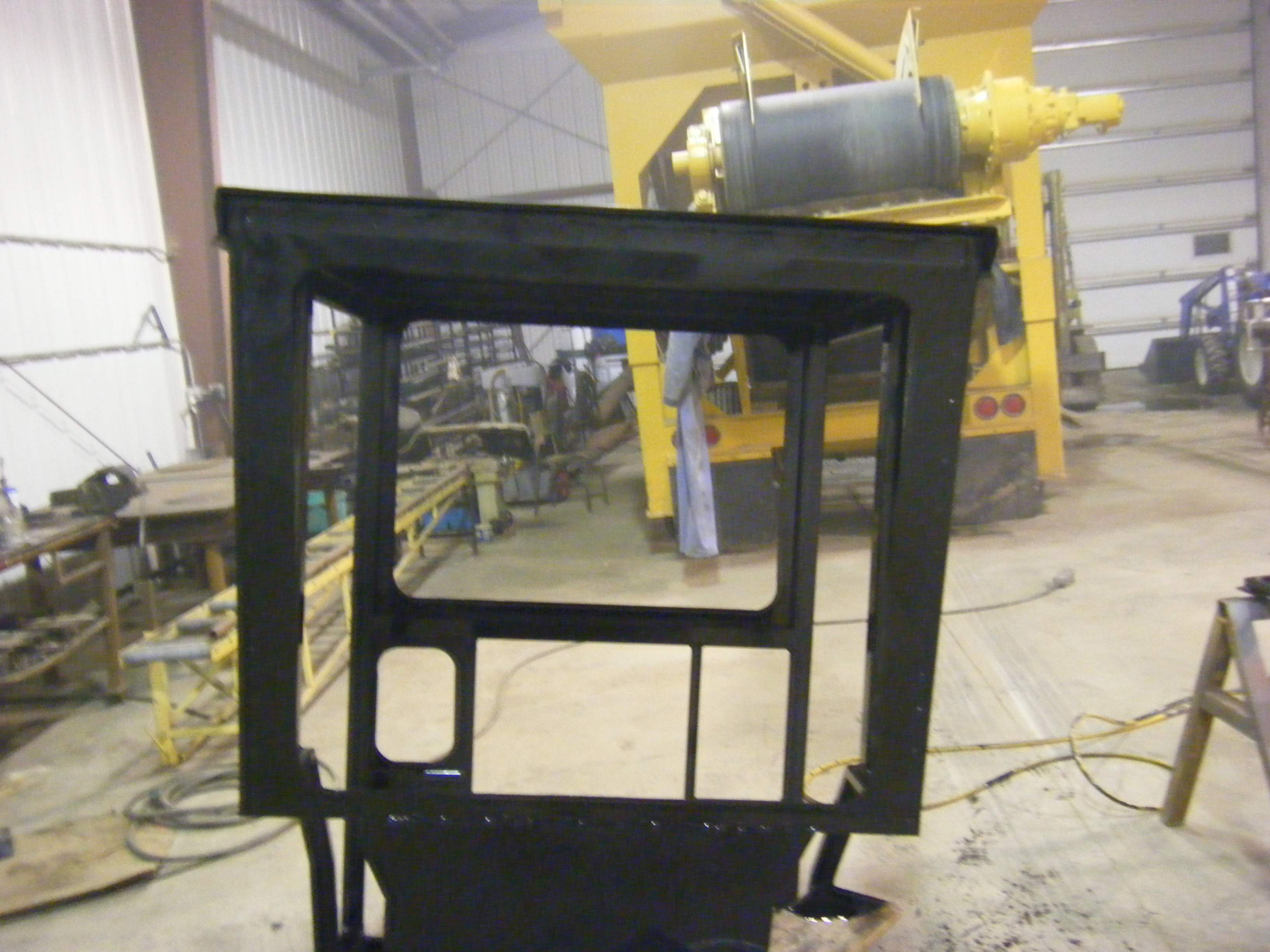

OK, what is that beast of a machine behind your cab in the second picture? It almost looks like an asphalt rotomiller.
#16
The machine behind the cab is a gravel conveyor , we were doing an overhaul of a client's gravel crushing outfit in the shop
