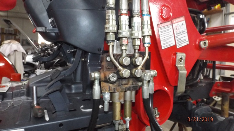

Well fellas seems TYM will only give me the LT350 valve and I would have to pay for the rest of the conversion. That is to have a correctly positioned joystick mounted valve mounted to the loader subframe. I emailed the dealer to see what the costs are for welding a plate one and a couple of hoses. That is pretty bad for a company which is of that size and has knowledge about the problem of the valve set up.
Maybe time for buying something else that has better customer warranty support when the TYM warranty runs out.
Les did you happen to start working on the write up for the valve replacement?
I am interested because why not upgrade to a better valve now and eliminate the problems you had and changing it over in the future. Which it seems everytime I need the machine something is r goes wrong with it(Stripped threads on loader frame, backhoe subframe bolts loosening up, frozen loader valve(condensation build up due to valve bing upside down), broken joystick because of valve corrosion, nuetral post on back hoe valve loosened during a job causing ball to pop out, and worn pivot bushings in the hoe), and it isn't due to maintenance because I am religious about that with all my equipment/toys.

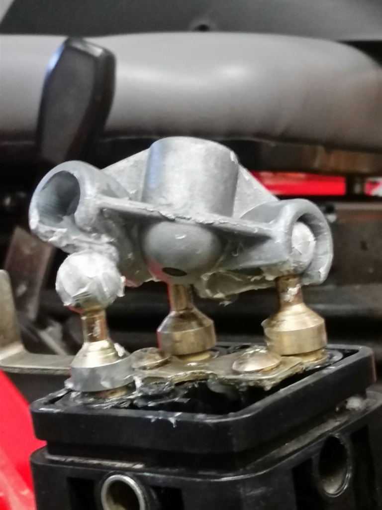

OK, here is the update, I broke the control cable going to the loader valve. I went to my dealer today and picked up a new cable ($50) and received basic info on how to replace it, the service side was closed today. I have reinstalled the cable now all I have to do is reconnect the joystick to the cable end which is a steel ball on a shaft. There are three, the center one in the picture which really is on a corner is stationary and the joystick pivots on it. The left and right ends in the picture controls the FEL and the bucket. I can get any two in their slots but not all three. I stopped today before I tried to force it and break the gray piece which is cast something. The joystick actually screws into the top of the gray piece and I don't know if it is available separately if I break it. I do know that the whole joystick control is $800 so I don't want to go there!
My question now is has anyone had to deal with this in the past? Any hints on how to get all three "balls" into the piece in the picture? I have tried many combinations of raising or lowering the cable ends, different angles etc.
/ T330 Loader Control Valve #51
I would think you have to remove the retaining plate to free the ball(s) and fasten it back when all three balls are inserted in the "swash" armature.
Edit:
The answer above is wrong. I just looked at FEL control on my tractor. I think you need to unbolt the "fixed" ball, insert it to the "swash" armature and bolt it back.

Ladia,
I tried that, when the other two are connected there is not enough room to slide the fixed one back in place. I will look at it again, I tried so many combinations already I may not have had the other two in a looser or higher position. Thanks!

Take the bolts out that hold the joystick unit to the tractor. Under the base that is a allen bolt that holds the center pivot ball in place. Remove the allen bolt and slide it out. Put the ball head in the triangle plate and angle it downward so you can slide it over the two cable ball heads at the same time as you put it back in the housing. When down in put the allen bolt back in and try the joystick. If all works bolt it back to the fender brace. Note- In some cases you may need to adjust the bucket and boom cables higher to get everything to slide together.
/ T330 Loader Control Valve #55
Pete, thanks I think I just don't think I have the cables high enough. I will try it and let you both know.

Ladia and Pete,
You both had the right idea, I just needed to adjust the ball ends of the cable more to finally get it to fit into the triangular plate. It still took a few more combinations to get it right. Thanks for being so helpful!! I have to give a shout out to my TYM dealer, Jordan's Tractor in Post Falls Idaho, for being helpful and having a good supply of parts in stock.

vmax540--yes these valves vent upward Causing issues. Not many options to remedy it. Tried slicone sealing holes and keep lubed. I had my vavle replaced adding a new lever mounted vavle and plate mount off of loader like the older tractors had. no cable crap to deal with... it has been awesome for the past 12 or so years.
