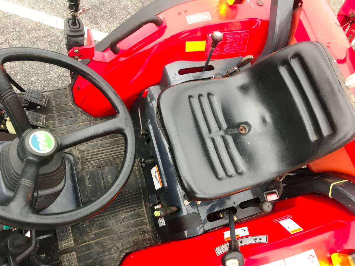

Hello, I have a 2009 TYM T330 with a LT300H F.E.L.that is cable operated. Have anyone ever switched this model over to a fender mounted hydraulic operated joystick like the one found on a LT353 or Mahindra ML 111? What parts would be needed and where can I find the parts list for a LT353 Loader ? Does the LT353 have a float function ? Thank you, Chuck S.

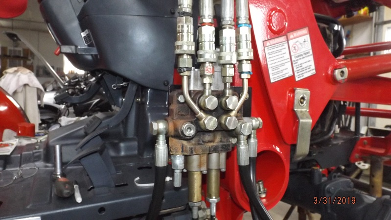

Fender mount joysticks still uses cables to the control valve, pretty much like your current setup, with just a few extra covers to hide the linkage and they just hide the valve under the floor board.

As seen in another thread https://www.tractorbynet.com/forums/tym-tractors/180703-t330-loader-control-valve.html I have cleaned and lubed everything from the joystick to the control valves. The Joystick, cables and valves by themselves all move without effort. Hook them together and the joystick movement is a jerky/binding mess and especially, the dump function (which puts sideways pressure on the joystick plunger and binds). The bucket will not dump fully which is a pain when trying to clear the bucket of stuck soil. There is no float whatsoever. Heck, the bucket will at times flop like a wet noodle when trying to scoop up dirt from a pile.... The tractor only has 525hrs.

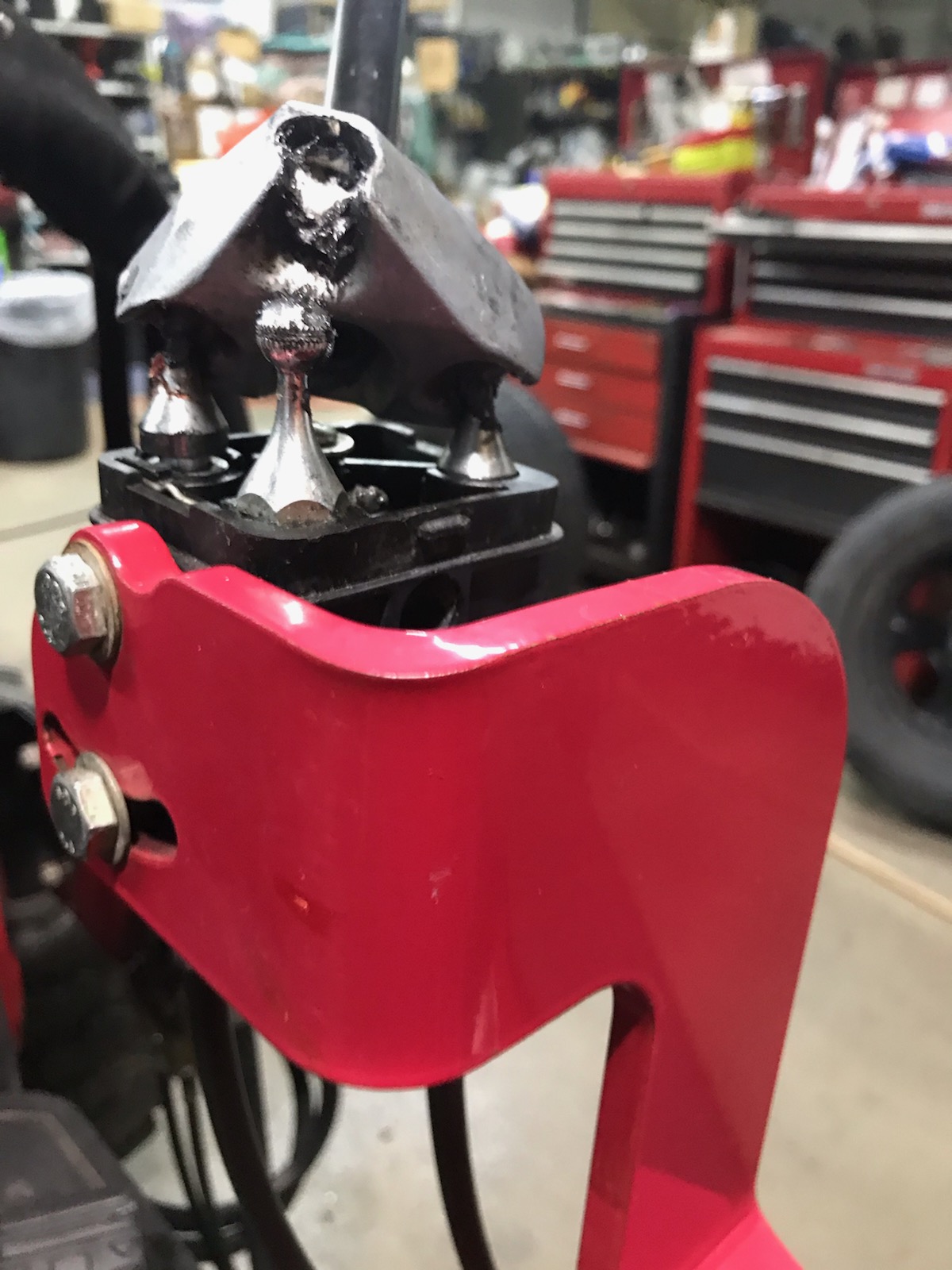

Problem is, like many others have encountered, the plastic ball ends on the cable joystick have broken off. For the price of new cables, it seems worth it to spend a bit more and replace the whole valve unit with a monoblock unit with the joystick mounted to the valve.
