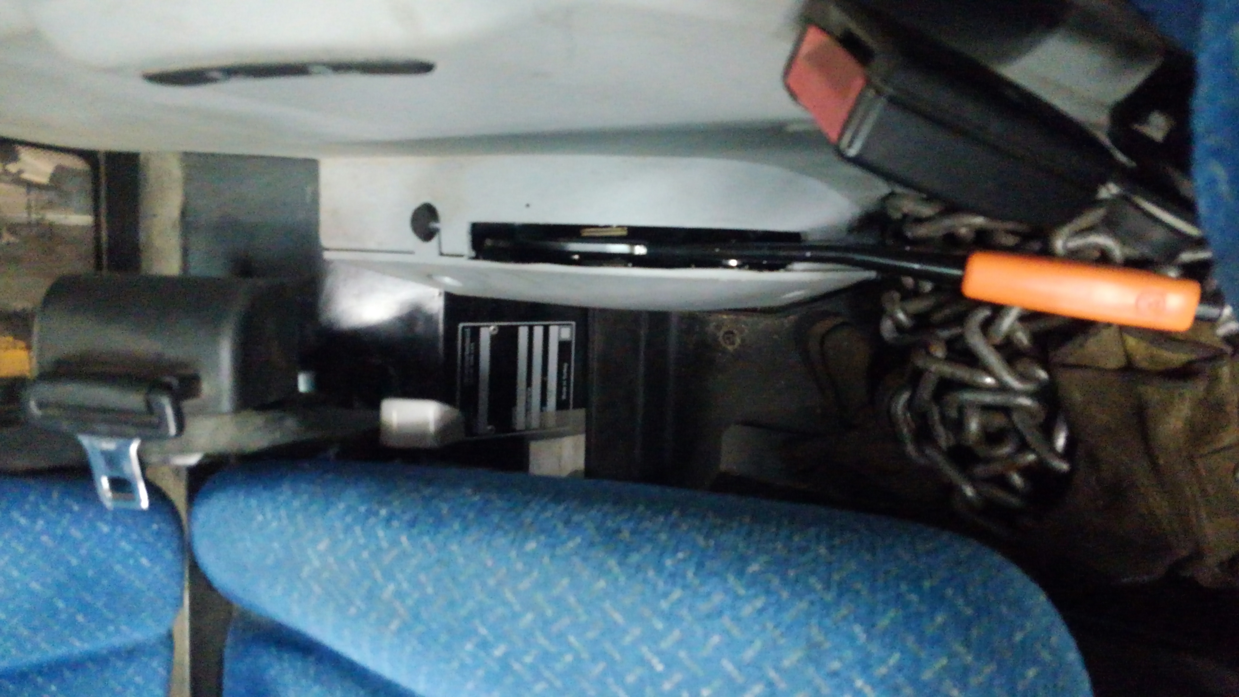

   / T4.75 Power Star transmission problem #24
I installed in three steps
1st step took about a 1/2 hour I installed the brake handle and cables. I slid the right brake cable over the transmission so I didn't have it hanging below and temporarily cable tied the ends up so they wouldn't fall down.
2nd step took about an hour and I waited for the fuel tank to be almost empty so it wouldnt be too heavy. Had to remove skid plate sending unit wires, 2 tank straps, and 2 bolts,holding fuel lines to the inboard side of tank then I was able to slide it forward enough to R&R the rear tank bracket install the brake cable and put the tank back together.
3rd step was the longest as I had to remanufacture the right bracket. I bought a duplicate right bracket for my tractor so if I screwed it up totally I'd have the original to put back on. Using part of the wrong bracket I got from England, the duplicate and the engineered drawing I welded up the new one, painted and installed it on the right side. It was probably about 3-4 hours total but the install and adjusting was under a 1/2 hour.
I can't say enough for the folks in England they helped a lot in getting all the parts together!!

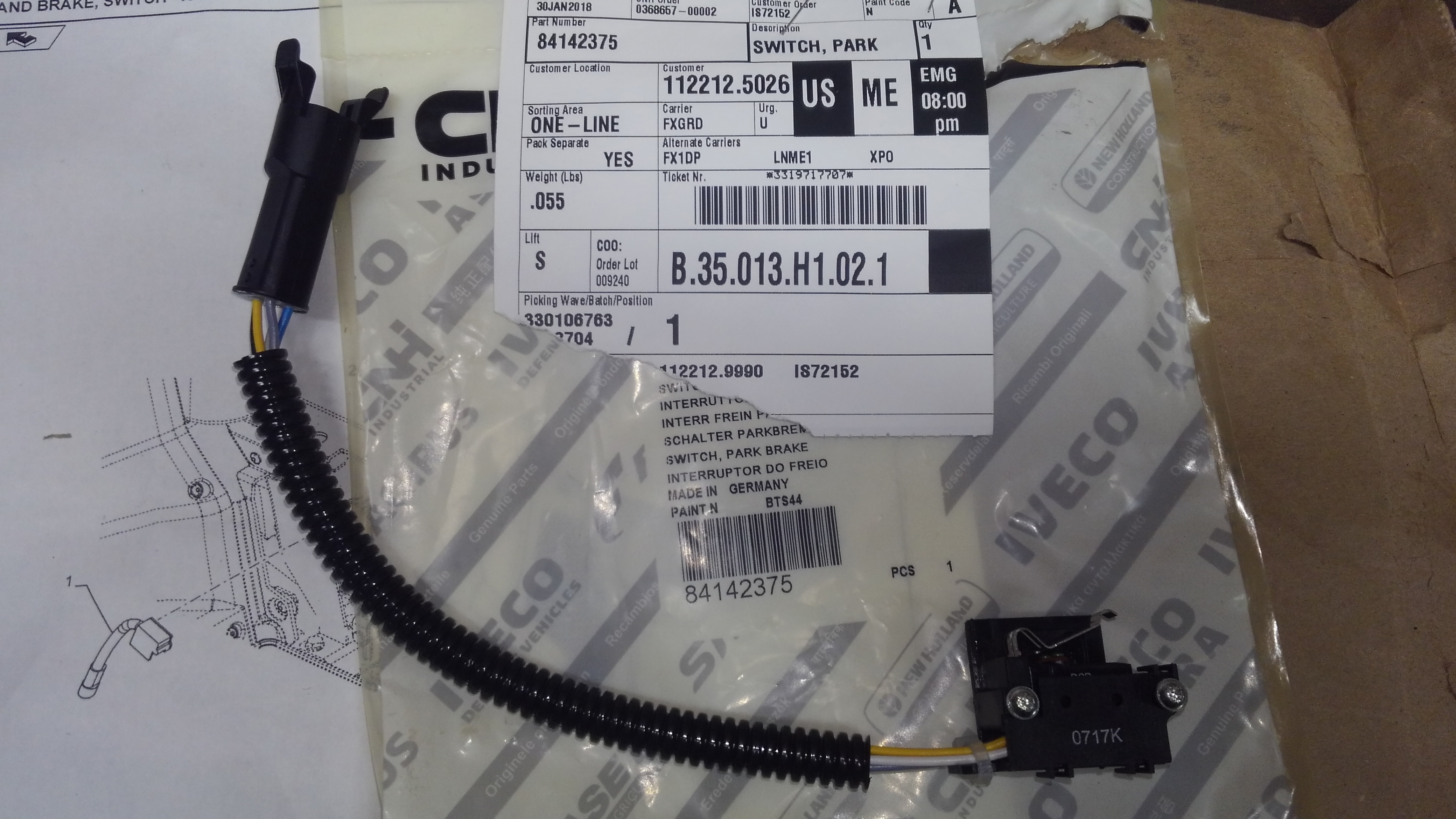

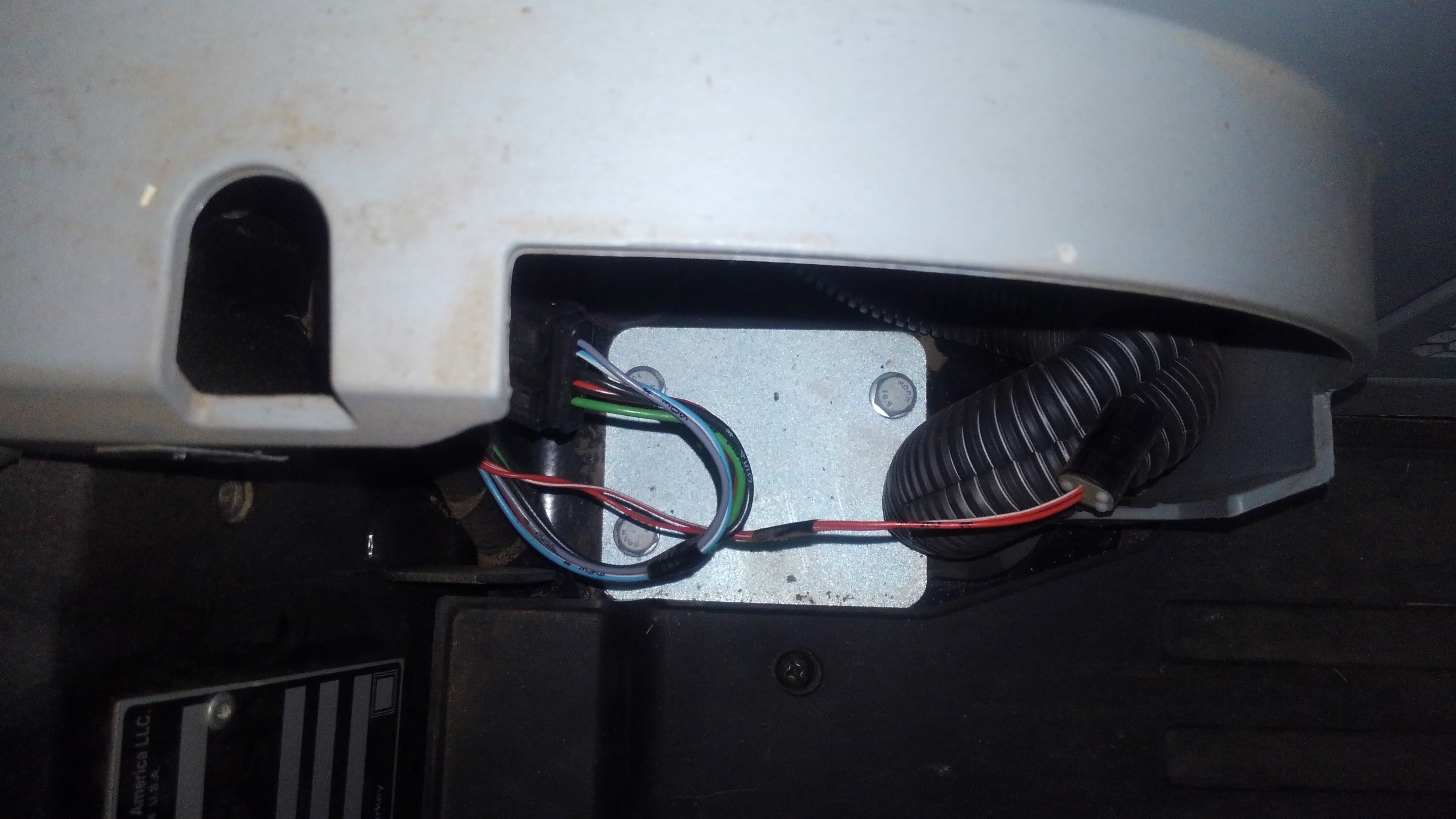

Update - I added the hand brake switch NH # 84142375 it plugged right in with the existing wires/plug and it works fine. The Parking brake warning light comes on with either Park or the hand brake. I also ordered the screws that attach it. If you forget and start to move with the parking brake on all the warning lights on the dash flash and the warning tones go off.
