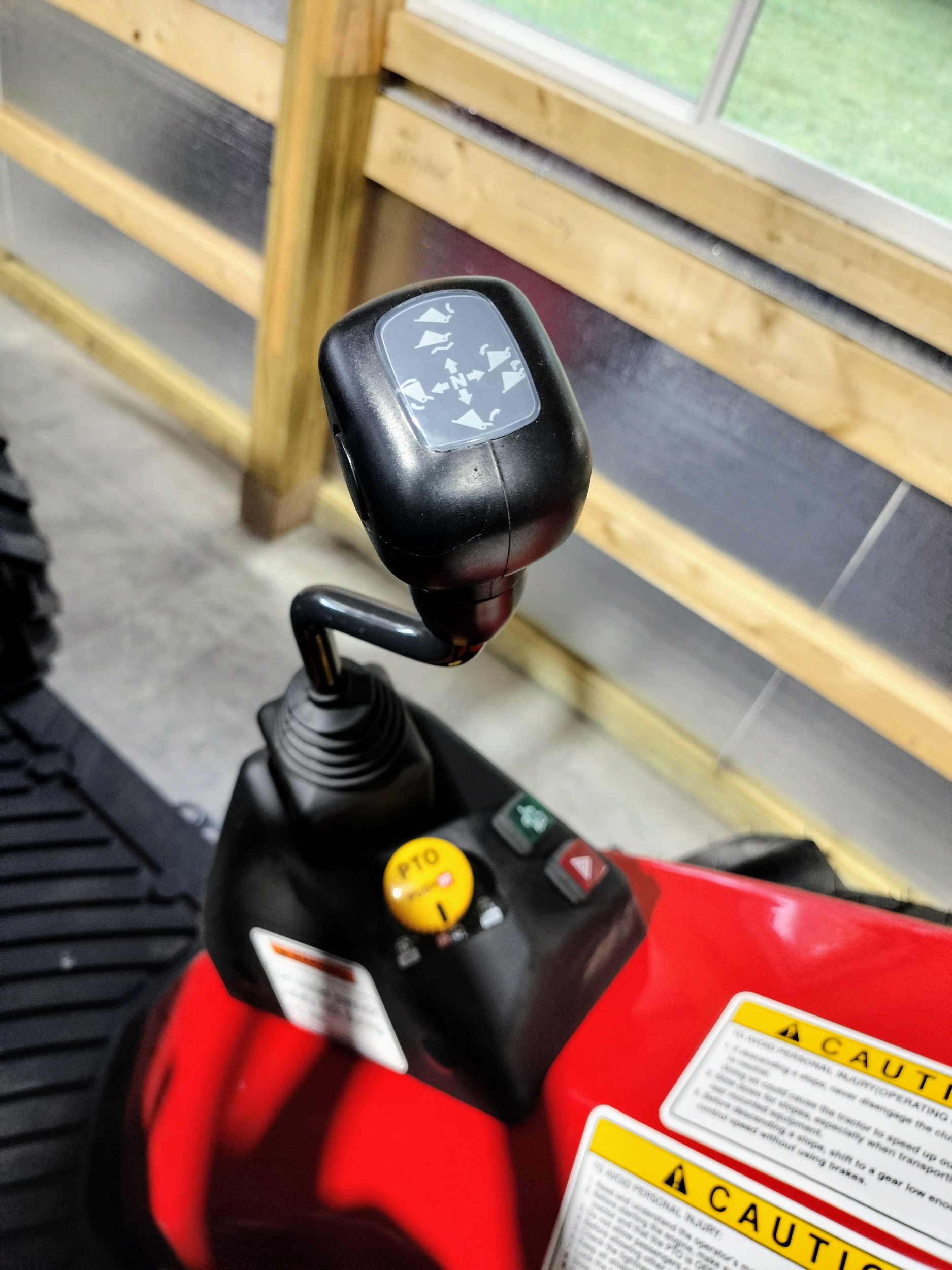

clover...the 4830 has more hydraulic capacity...probably why yours bucket is fast. you are correct, they look to be heavier built than the T494. Can you provide some pics of the loader control? appears it is much heavier and located on the fender flare vs all the way to the ground.

Oh, sorry, just saw the new post...
I may be able to do that tomorrow. Though as I recall, I can't post video here... I tried to with my hydraulic top link and it wouldn't work.

Thanks for the pics clover...I keep reading these reviews of the loader handle on the 494 snapping off in cold weather or when hit upon exiting the cab. That issue seems to be a non issue on the 4820 given that it is mounted in the side console off the floor...man Torvy...that is a lot of tractors!
