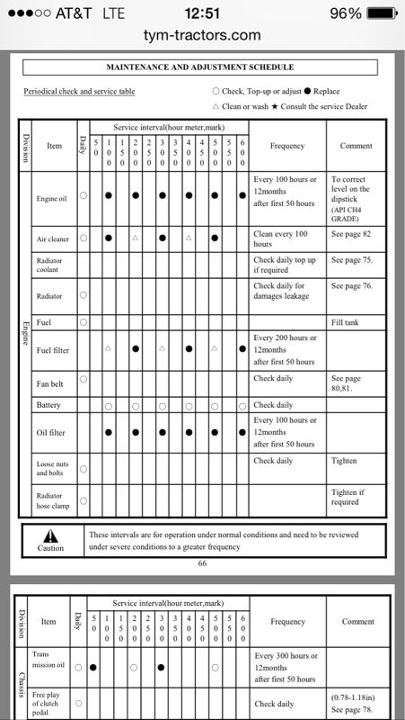

I just check my manual again and its
said 500 hrs interval.
I don't what manual you have but we all have manuals that is different from yours...please don't sell that tractor to me when your finished with it...oil changes every 500 hrs....wow....I think your pulling our leg
/ T554 tym #28
Here are the snapshot of the manual.
wow ...i think you should go back to your dealer and show him that manual.must be a misprint..if you follow that manual the tractor wont last..the filters will be on bypass most of the time especially with an hst trans...like you see from our manuals they say something totally different
/ T554 tym #30
I would have to agree. Give the dealer a call and let TYM have the chance to make it right and get you the proper manual if they can't explain the reason for the discrepancy.

Well like I said I have the same tractor 2015 tier 4 t554 tym and my manual doesn't say what yours says...I'd bring it to your dealer to have a look at it...I'd say a misprint
/ T554 tym #34
Call my dealer service department today and
ask about the hrs service interval
they told me its every 100 hours for oil
and fuel filter. 300 for hydro and hst.so its is a
misprint. Then I call TYM-USA service department
And explain the discrepancy. They said the have
to check with R&D department to confirm which is
the correct versions of its. Will let you know.they also
Will send me the right version of the manual when
they get the correct answer from R&D department.
