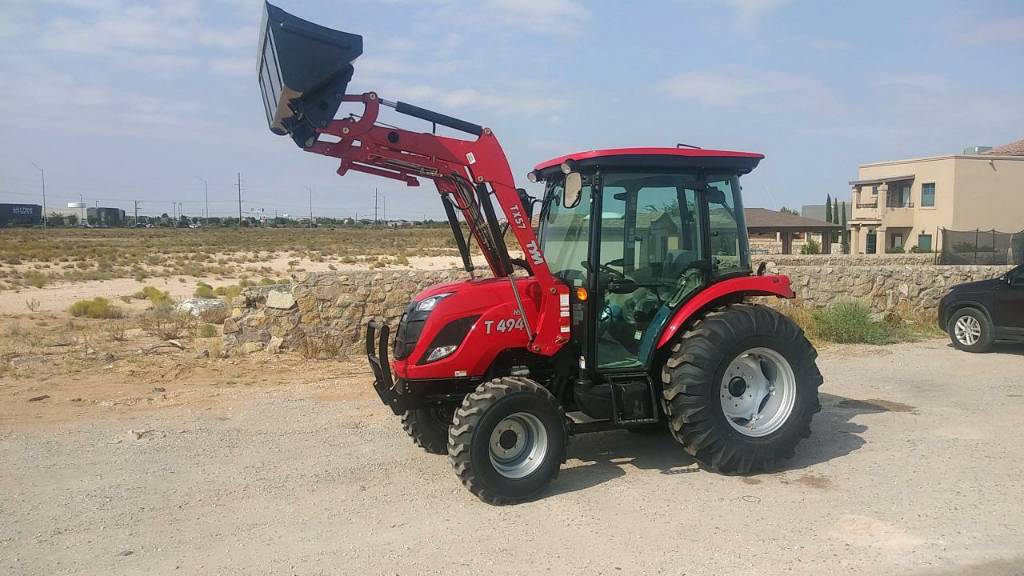

Hello all ,
We are looking to buy our first tractor to work on some land we inherited.
The land has been neglected for years and it has many juniper trees that need to be removed of various sizes. We mainly want to remove sappling to 8 ft trees and cactus.
We found this front tree puller
Danuser intimidator
Intimidator | Tree & Post Puller | Danuser
Just wondering is the t574 too much tractor for this job or could i use a smaller tractor?

Sounds like the trees are smaller, so any reason to go with the T574? Even looked at the T394 (37Hp) or T474 (48.3Hp)?
/ T574
No no reason, just thought a bigger tractor. We were not sure what a smaller could handle with tree pulling being the main job.

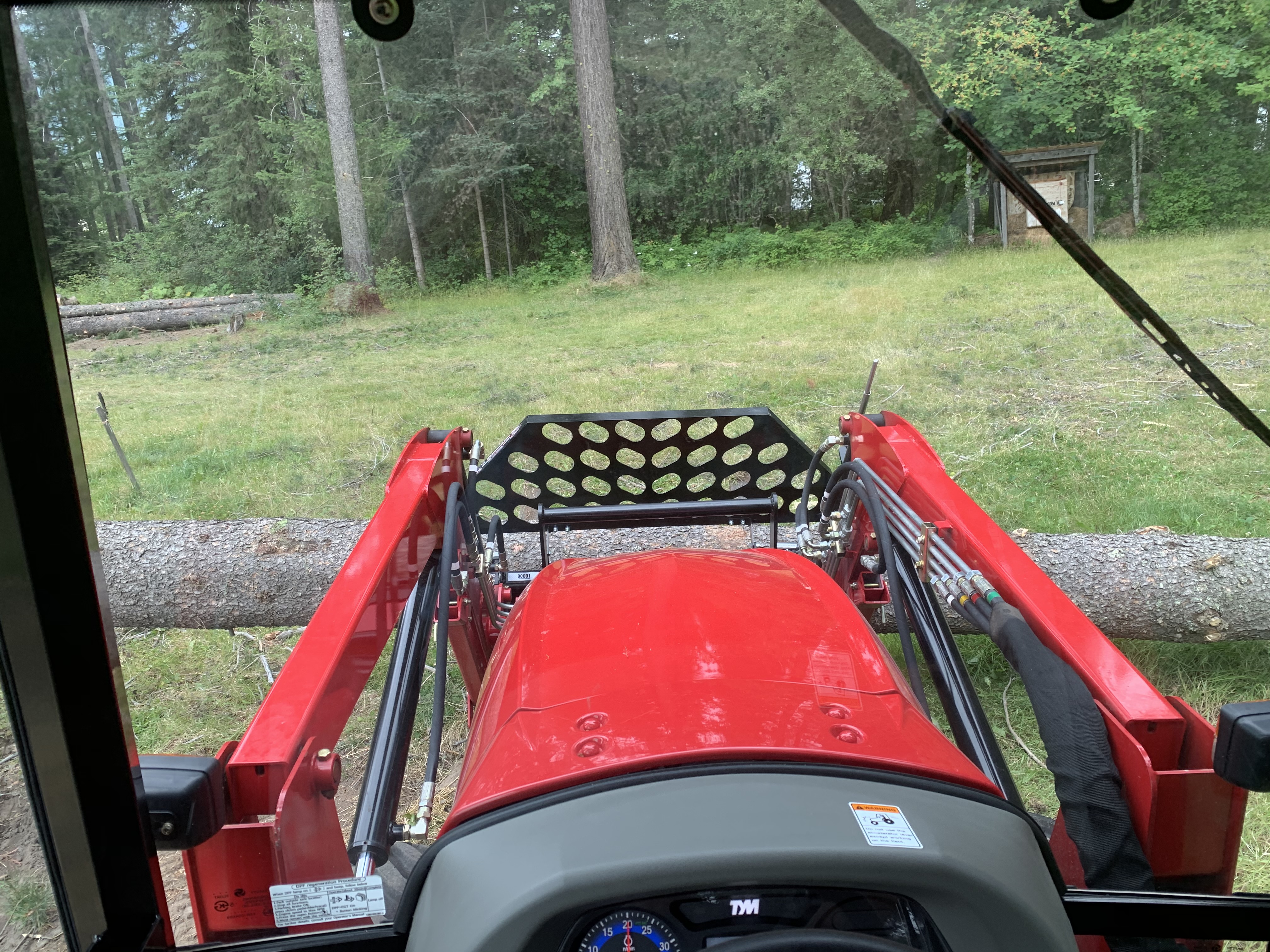

This isn't pulling trees, but carrying a large green sappy log weighing about 2500#. The T474 is an impressive compact tractor so far. Tree puller seem to weigh 600# give or take by itself. If you choose a T494 (one frame size up and possible same as T574? T574 has a Turbo instead of N/A?) You get front loader lift capacity of 2780 and change. Vs 2160 on the T474.
Look at the T494, same frame/tractor just alittle less HP. I think for what your doing the frame size may come into play along with lift capacity.
/ T574
So we talked to a dealer in el paso about the t494 with the tx57 loader last week. He Contacted us today and said he is going to order the tractor today with the tree puller and auger. Says there is a 4 week lead time, so we will have to wait awhile till we get it.

Everything finally came together with the tractor and trailer and I was able to pick them both up on friday.20200911_135231.jpg29830.jpg
