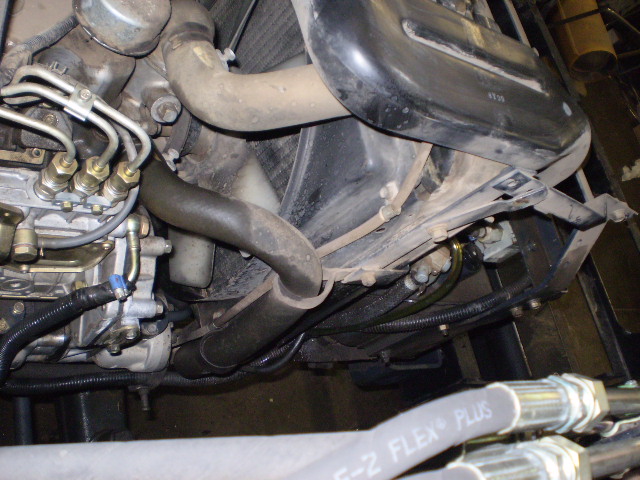

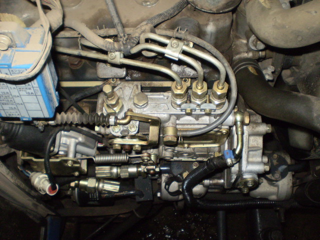

I,m also trying to figure out about the injector pump & if its supplyed by Engine oil or not . Can you tell by looking at a few pics ? :confused: I,ll attach a few here .
As far as how to post them , In a new thread Or if You hit the reply button you can scroll down to the Manage attachments button , Click on that & it will open up a new window where You can browse the photos & Upload them from wherever You keep them stored on your puter , You might need to resize them so there not to big for the forum , I just have My camera set to make them forum friendlly . Hope that helps . Bob

HI ,on mine the injecter pump has an oil line that runs from the oil filter area to behind the injecter pump you have to use a mirror to see its conection to the pump.I shure hope thats what it is because i tryed to put oil in mine and could not find a drain plug and what oil i put in it went right on through.Still runs good though.:)

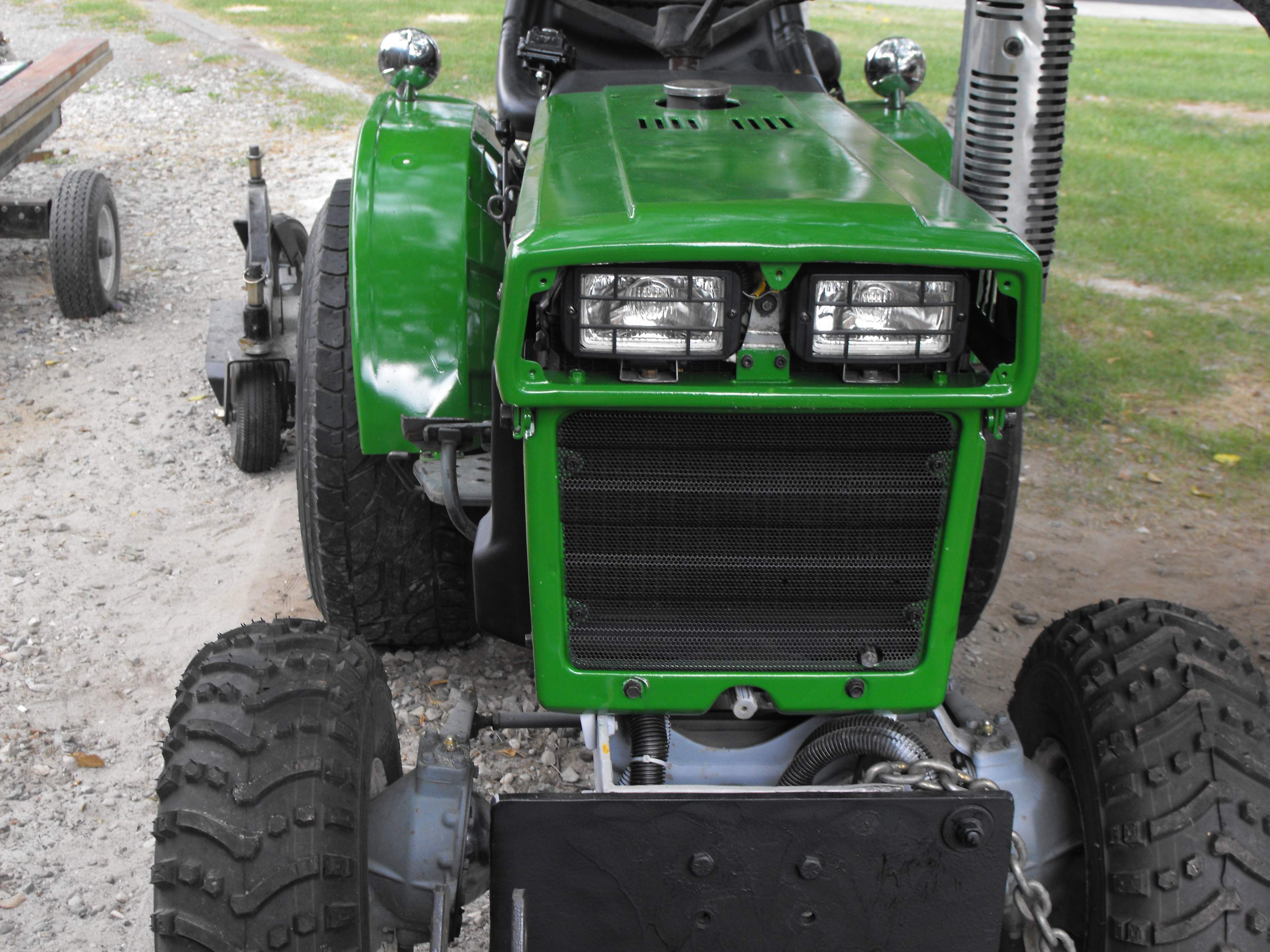

Hi Cowboy.....I'm gonna' try uploadin' a pic of THE BEAST as it looks now after a not so complete Repaint "Ugg" JD green from the old flat white it came with.........Ampa....:thumbsup:
/ ta 250 new owner #11
What do you know! I done did it.....thanks Cowboy for the info....sorry to hear about your trans problems....did you find the needed parts yet? those gears look in bad shape.....take care.....Ampa :thumbsup:
