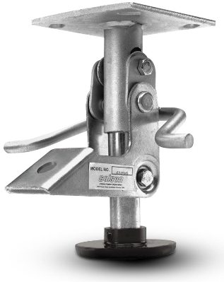

Get QUALITY casters with wheels.
Or buy Floor Locks. Some examples:

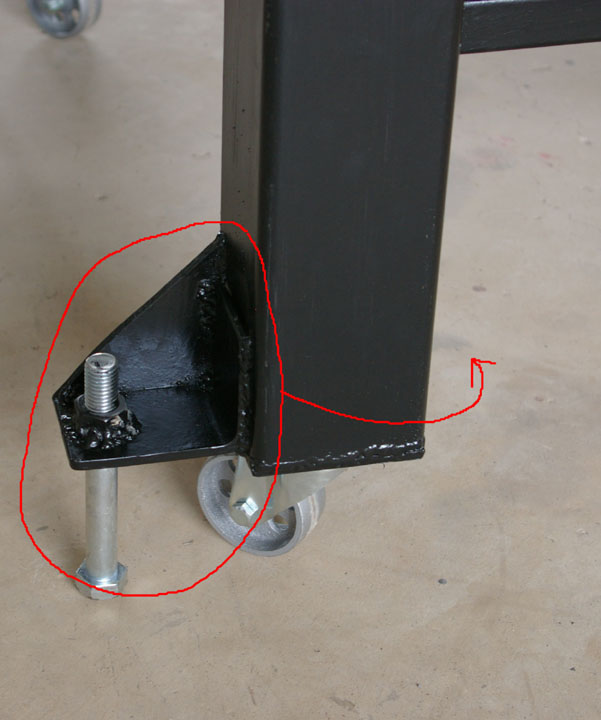

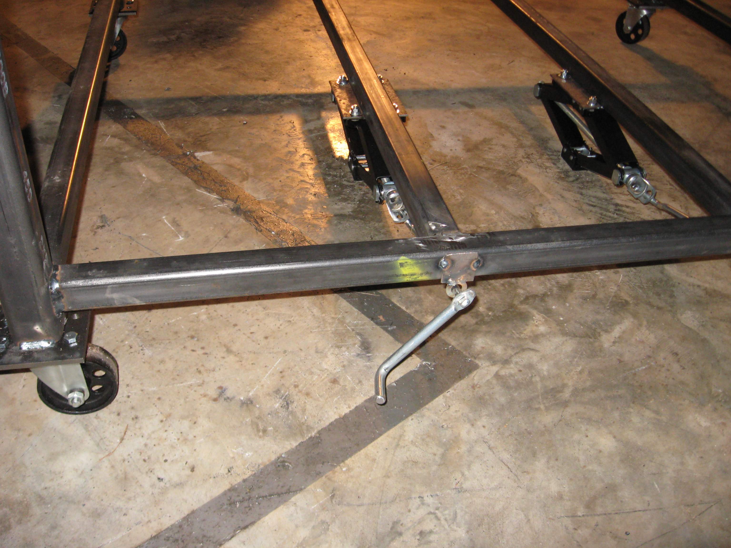

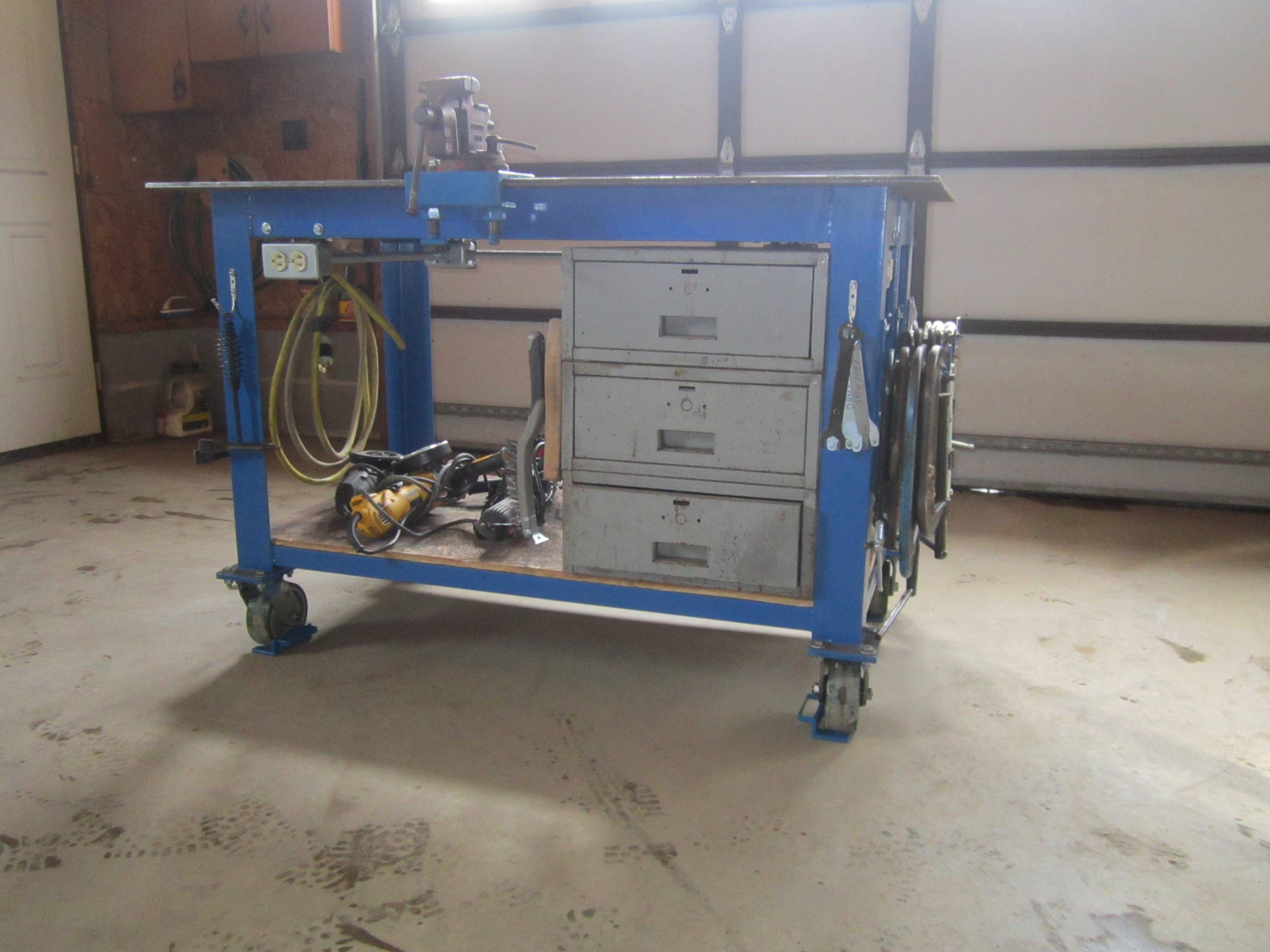

I used a couple of scissors jacks, but the table is so heavy, I'm finding I don't really need brakes.IMG_1786.jpg

+1 on the floor locks shown in post #2

I used a couple of scissors jacks, but the table is so heavy, I'm finding I don't really need brakes.View attachment 294879
That's a good idea too! Anything to save a little $. I think making my own is the way to go. I figured at least $200 if I buy the brakes.

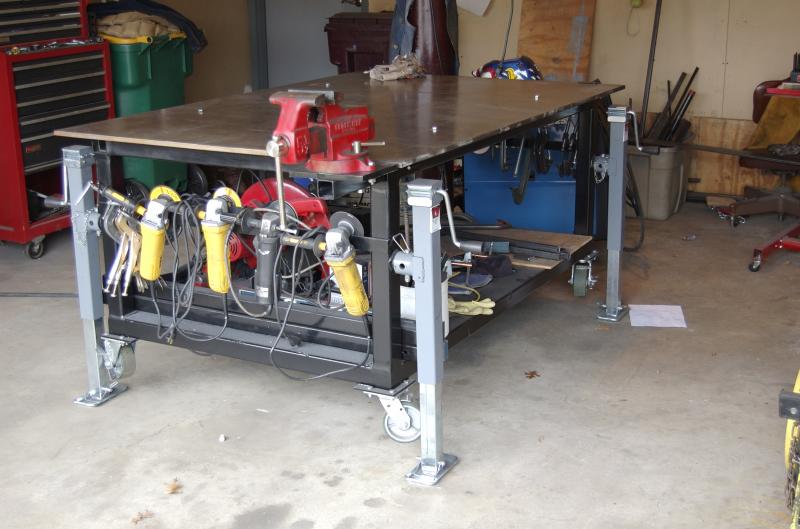

It would work, depending on how far you want to take it. Here is a picture of a table I got off another web site that uses them.DSC_0014.jpg

Bday, happy you like my idea. Now keep in mind, it is a brake, not a leveling device. WT 20.jpg
Gary, you are right. The way I built mine can be seen as a tripping hazard, that is why the photo has the red directional arrow to put the brake to the inside of the table leg. Although I have never tripped on mine. There is a 6 inch overhang on my table.

You would probably want a side handle weld-on jack. I was going to say mount it inboard but with a 2' retracted length plus room for the handle to swing under the table it may not fit well.
Ultra-Tow Square Tube Jack — 3000-Lb. Lift Capacity, Direct Weld Mounting | Trailer Jacks| Northern Tool + Equipment

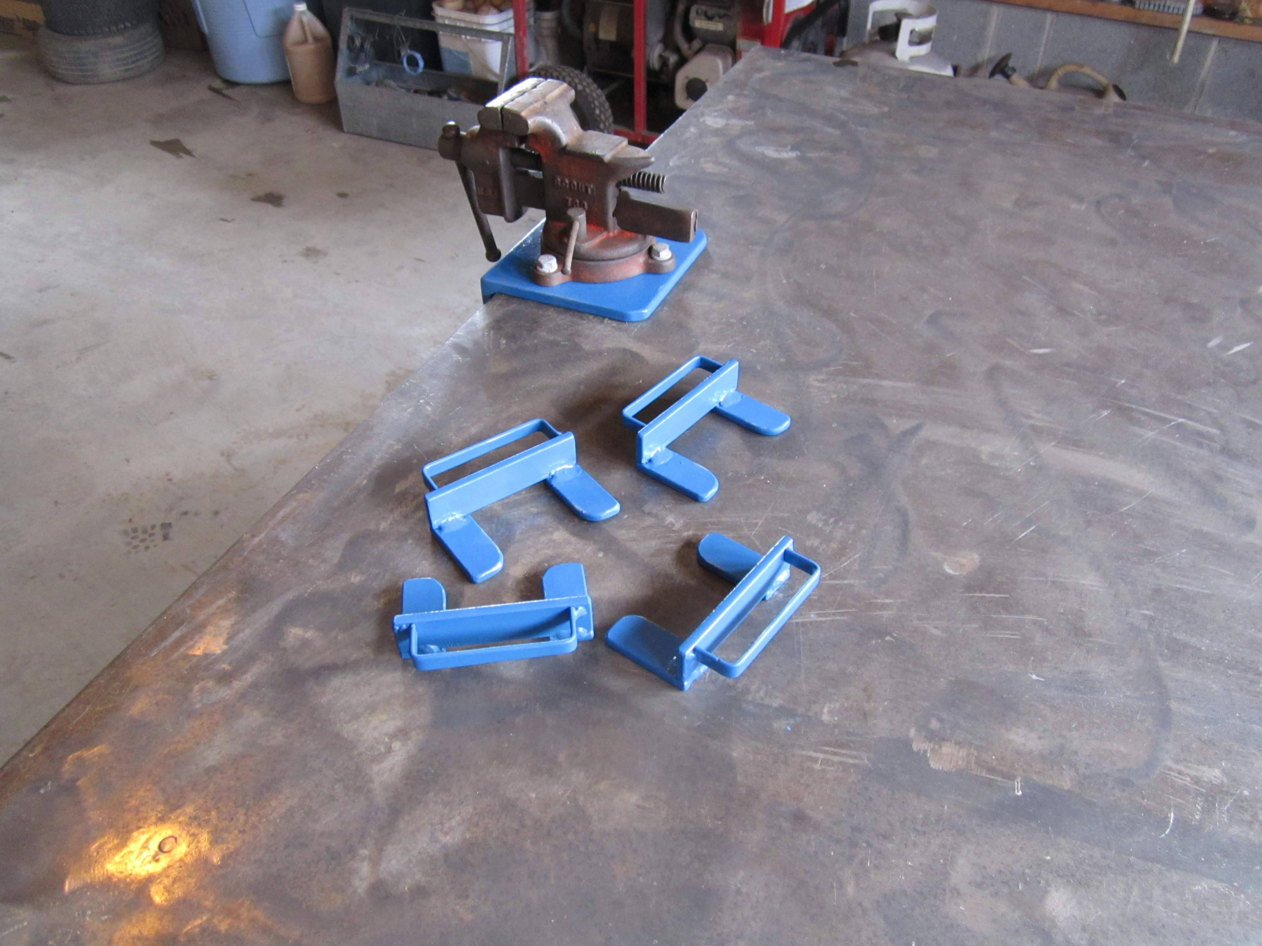

My idea was to make some chocks out of 1/4"x 1" flatstock. Cheap, simple and it was a good project for my 15 yr old son to do.
View attachment 304426 View attachment 304427
Hey Mercmaniac, looks like a good idea. I just finished mine today. Went to Harbor Freight and bought 4 jacks. The concrete in my shop is less than level. I'd like to meet the guy that poured it! Anyway, being able to level the table is great for some jobs! Plus the table is now stationary with the jacks down. It worked really well!:thumbsup:
