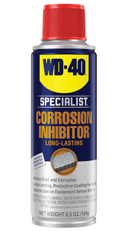

You might consider a light coat of WD-40. It is not a lubricant, its purpose is water displacement. In addition to spray cans you can purchase it by the gallon.
/ Weld Table Rust? #6

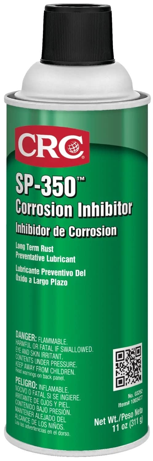

CRC SP350 for anything containing iron. I've never got a can that seemed to spray worth a darn, so you have to spray then spread it around with a rag. You can also just give it a heavy coat. :D
