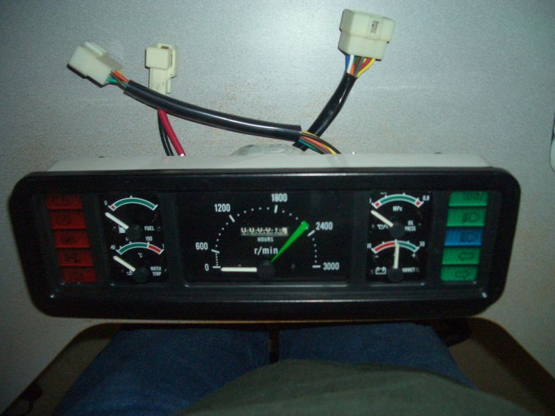

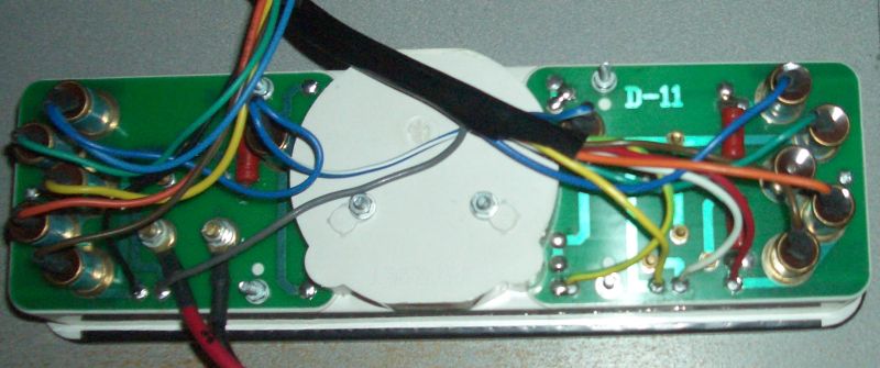

I have no desire to be confrontational here Tommy. But this is a thread about a TaiShan issue. Go back and read everything you've posted to this thread so far, and see if you still think that experience gathered from selling 300 Jinmas is germane to a Kama/TaiShan OPSU-tach-hour meter issue.
Here are front and rear photos: note first that the KAMA/TaiShan face and physical dimensions are different. But note more importantly that there are three electrical connectors. Then look at the photo of the PCB on the back. The yellow wire with the green stripe behind the center circle (5 o'clock position) is the tach feed. There is no independent hour counter wire. When the tach is registering RPMs, the hour meter is counting. And it's not a simple on/run - off/quit counter either. An internal logic chip makes the hour meter count faster or slower - relative to how many RPMs are registering. Up at PTO speeds, the hour meter is counting 1:1. Below that, it racks up time slower.
//greg//

OK Tommy, you obviously don't believe a guy who actually owns/operates/maintains a KAMA and a TaiShan. And assuming you're unfamiliar with the line, LakeSpirit's TS254 is basically the same as my TS354C - it just has a smaller engine (Y385 versus Y485).
But if you must, go ahead and get your independent confirmation from Chip. I'm here to tellya that neither of my hour meters count simply because the keyswitch is in the ON position. The key has to be ON, the engine has to be running, and the speed at which the hour meter turns over is proportional to the number of RPMs the tach is registering.
That is; when the engine is at idle, the hour meter ticks off at a rate considerably less than 1:1 (less than one meter minute for every real minute). The more RPMs indicated on the tach, the faster the hour meter turns. At PTO rpms, the hour meter is clicking off 1 minute every 60 seconds (1:1)
And I guess I've been at this longer than it's taken you to sell those 300 Jinmas. Because the older Jinmas (pre-cluster gauge) had no tach at all. The OPSU ran both the oil pressure gauge (wire #27) AND triggered the hour meter (wire #26). No oil pressure, no hours counting off.
