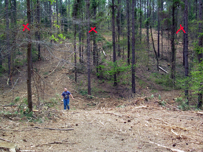

SCRich, can you walk up it? If you can its not 45. If it is you have a very touchy problem. Picture?
larry
   / "Tactical" Question FEL on steep hill
#16
I can walk it no problem. I looked for a photo but I do not have one of the dozer pile. My son is about 4ft tall and I am 1/2 way up another hill, he is in a gully and you can see the hill I got to work on behind him. The red marks note where the piles are . Photos are horrible to show inclination, you really can't judge from a 2D photo but...
   / "Tactical" Question FEL on steep hill #17
It is hard to tell from the photo. The hill going down toward your son looks pretty steep!

Actually that's quite funny. The hill I am standing on is our yard! Not enough flat land near the home for a traditional yard so I picked the closest flattest point near the house and that's 50ft behind it where I am standing. We had our guy de-stump and grade a little bit for us but that is what I'll be mowing every week or so with a JD ZTR! I THINK the hill behind him is a bit steeper but it may look worse since it is not cleared and clean like where I am.
   / "Tactical" Question FEL on steep hill #19
The picture does help a bit though...
The biggest things are to NEVER be cross-ways, going around the slope, and to always keep the most weight on the uphill side, not down. I still think your best bet is to loosen the material from the top, pushing down. Then, scoop it up and back down or climb on up the slope. Personally, I'd cut a path out first (as I suggested) then haul the dirt uphill if possible. I don't like working in reverse on steep slopes -- it's much harder to see potential obstacles like stumps, ruts, etc.
