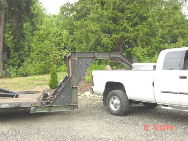

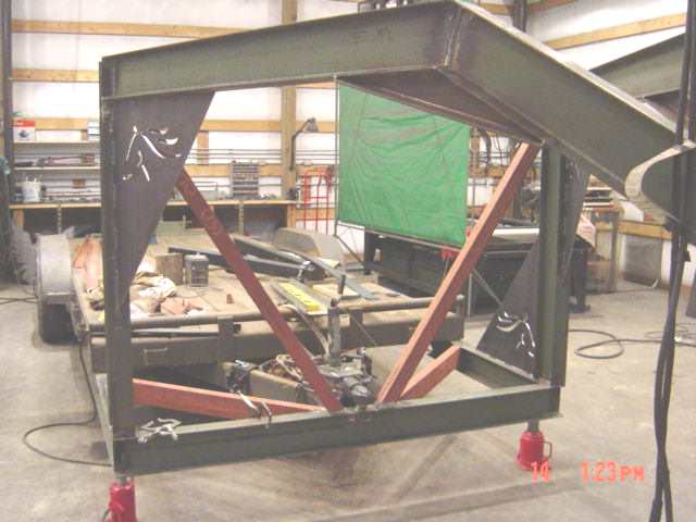

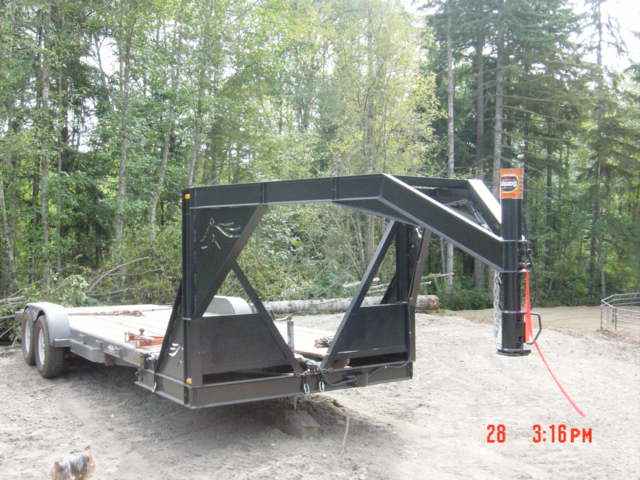

Very nice work, but that is a heck of a lot of steel.... Our 12t goose was nowhere near that heavily built.
First one I did was for a friend. Used smaller steel. :D

We used to build a tri axle 18,000 pound trailer . It's neck was made with 8" I beam to match the frame .. It had a simple design and used several gussets and doubler plates where required .

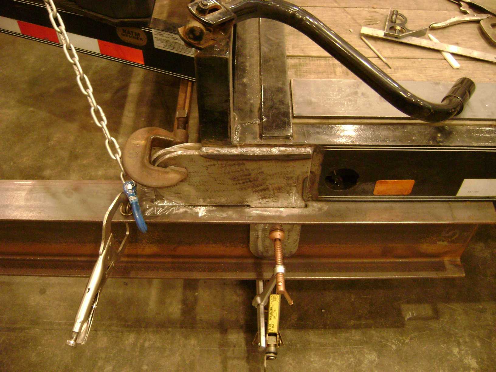

After I built my gooseneck adapter, an engineer friend ran the numbers. He said it was good for 30,000-pounds. I got the beams off Craigs list. They were demoed out of Childrens Hospital in Seattle. They must be an M-shape, but I can't find there size in any of my books.
12-inches tall.
Flange width is 4 1/8-inches.
Flanges thickness is 1/4-inch.
Web thickness is 3/16-inch.
