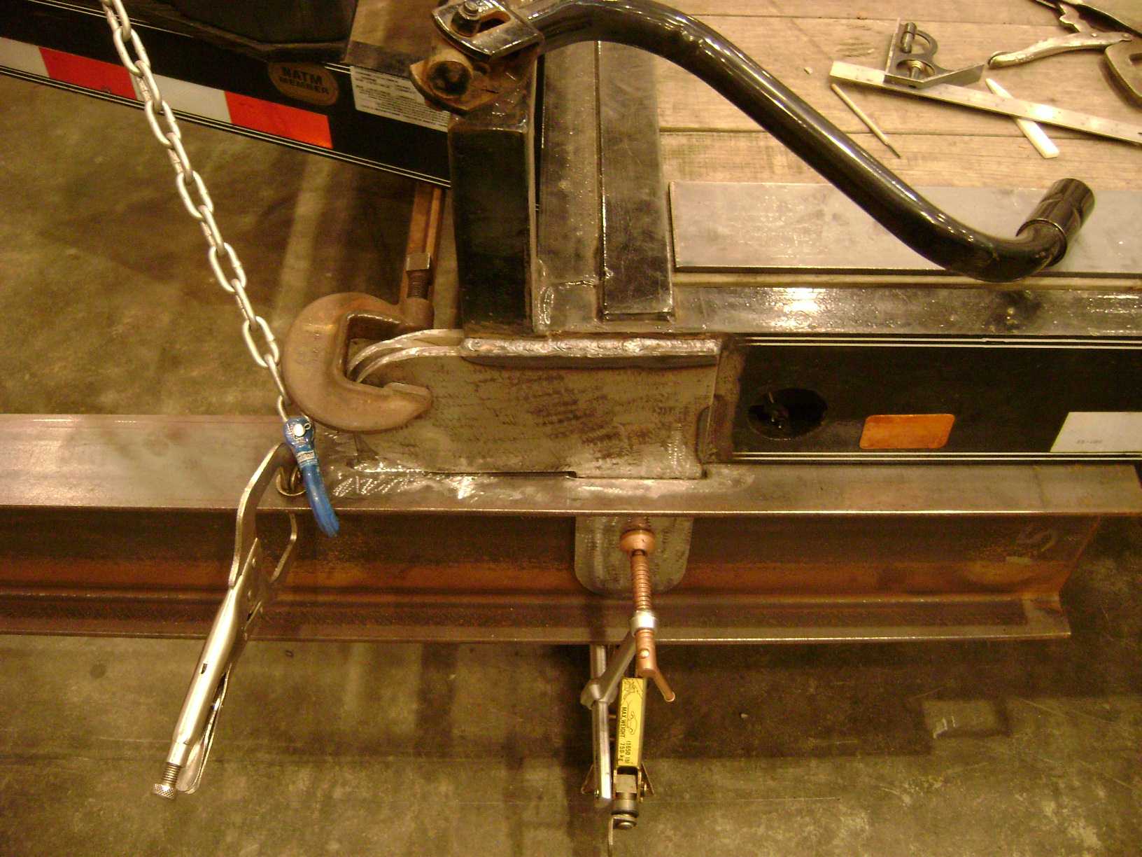

After I built my gooseneck adapter, an engineer friend ran the numbers. He said it was good for 30,000-pounds. I got the beams off Craigs list. They were demoed out of Childrens Hospital in Seattle. They must be an M-shape, but I can't find there size in any of my books.

dieselbeef I'm not sure I understand what it is you want to see:confused:. I built the adapters out of scrap steel. They bolt to the trailers with pad eyes welded to the trailers.

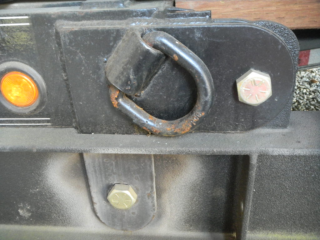

I would much rather rely on welded pad eyes and bolts, than chains.
   / tag to goose neck conversion #26
I dont think DOT would be too crazy about chain(s) holding a g/n adaptor to the trailer. Even a well built bolted on adaptor may raise some eyebrows and open some ticket books if the officer is being a richard that day... what happens to weight ratings and legal limits? That's not even opening the liability chapter in the book...
Not to say I wouldn't build one for my trailer, I have looked at Shield Arc's pics and would copy his design and pick his brain about it too. But no chains.
