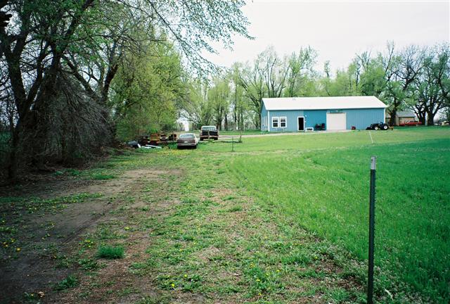

Yes . Our 40x60 morton building was built as a Karate school about 20 miles from here . It was completlly disassembled in Reverse of how it was put up & Each & every piece was marked so it could go up Exactlly the same way , This also included Rolling up the insulation & putting it in large plastic bags . This one was assembled with screws & very well built . The Nails will make it much more dificult to take apart but Posablle .
It took around a week to tear it apart with 3 working full time . Once it arived here & unloaded in seperate stacks . Another 4 days , Denailing everything & stacking it back up in seperate piles in the proper order for reasembly .
We had the ground leveled & compacted ready to go & all of the post holes dug ready for it , so the Frame work went fairlly smooth . The Poles were set & just tamped & Braced . The 2x6 runners were then put up & also everything was braced from the inside . Then We rapped the entire Building with the dupont mosture barrier .
Once that was done & everything was Squared the Outside wall sheet metal went up , With one end Open enough to get a tractor inside to Put up the trusses .
Everything has to be as Perfect as posable so all of the exsisting screw holes in the metal could be used . The windows , Walkin & overhead doors were left till last & framed in from the inside . The originall buildin Had only 3 windows & one walk in door . So We had some metal left over from adding another walk in door & the overhead . Nothing was wasted & only had to buy 6 additional sheets to finish it up .
We Then put the truses up & braced them as We went along & started putting up the perlins . Once all that was done We closed in the other end .
Then Raised the roof sheeting up from the outside of the building with the tractor with forks on it & started putting it up in Reverse of how it came down .
Once that was all done , We poured as much as the concrete through the Walkin & overhead doors . With a small tractor inside to Move the concrete around to wear the shoot Couldn,t get to . & poured in 3 Seperate sections. once cured the tractor was moved onto the section that was poured for helping get to other areas as needed .
We did This in the dead of winter, Fought snow, ice , mud & high winds out in an open feild . In perfect weather We might have aproached it differently .
Very few screw holes were missed & all in all it went Pretty smooth . Its not perfect But Good enough for Us . The only people involved Were My FIL & 2 great farmer friends & the wife & I .
My father in law & the 2 friends took apart the bulding & delivered it, From there the Wife & I Denailed & restacked everything . Her Dad & I did the whole Framing & sheet metal work . The 4 of Us did the trusses , perlins & roof sheeting & concrete work .
Once the shell was Completed I finished all the Eves, windows , trim & doors Includin 2 interior walls . & the Wife & I finished the inside of one end for a small apartment game room type thing .
Sorry for all the caps I get carryed away. The whole thing took about 2 months from tear down to the finished Structure . Not for the faint of heart . but Much cheeper then new . Hope this helps & sorry for the book :eek: .
Hers a pic about a year after it was finished . Bob

I do have more Photos , But my scanner is broke. & the puter crashed where I lost the ones I had downloaded , But I,ll see what I can come up with .
Everything Was Marked as it was takin down with a Marker . Like Northeast corner . Roof, Sides . However the best way was . On the inside of the metal Using Arrows to point to top, bottom or whatever .
The wood , Side 2x6,s , Perlins & such Were not as Important As They Were Basiclly the same . The Posts & trusses However We did mark & tried to Use as a starting point accordinglly to how it was taken apart . Mainlly for reference points & directions , If that makes sence .
Everything was hauled on a 24 foot car trailer in several different loads & unloaded in seperate stacks & each stack Was marked as what they were for . Restacked in order of How they needed to go back up .
What We would have done Different , Simple. Dont wait till the dead of Winter :eek: . I Beleive if We would have waited till Spring it would have taken a fraction of the time . Making sure the Screw holes hit the side & top perlins took Quite a bit of time . Having the sheet metal Froze together Only made it more dificult as well as Putting the wet sheetmetal on top , Makes it very slippery & Dangerous .
Also, If You can put the posts in, Get it Framed then pour the concrete . that would make it far easier as well as safer .
I,ll see if I can get some more pics . The main thing is keep track of whats what when its taken down . I Would also sugest using screws to put it back up instead of the nails .
Hope that helps some . Best of luck. Once You do it . It will be a huge accomplishment . It aint easy , just takes some planning Which I,m not real good at. Bob
