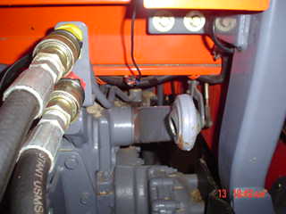

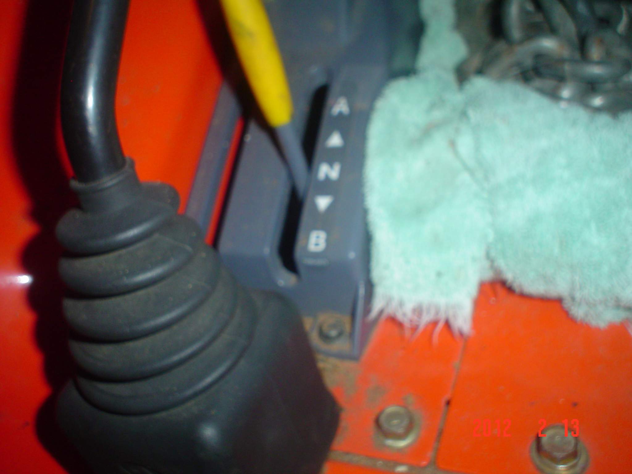

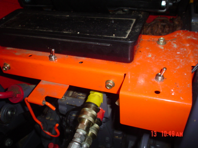

I put colored tape on both the hoses and tractor fittings so you will remember which one goes on which when you reconnect. In pic #2 & 3 while it doesn't show there is colored tape on the hoses. On my 2008 CK35 I switch the lever position from A to N, (see pic #1 for location). You MUST change this other wise you could damage your hydraulic pump. In the almost 4 years I have my tractor and backhoe I have probably taken on and put back the backhoe 25-35? times. Sometimes when putting it back on it can be a bit difficult to line up properly. As EHR suggested, use a nice level area to take it off. I do use blocks under mine as well.

Taking it off is a little easier than putting it on being that you don't have to line things up. It took me about 20 minutes the first time but now I can do it in less than 10. I do block it as mentioned at three points. That will keep it in a nice position for when you go and put it back on. The stabilyzer legs and the boom will allow you to lift or lower and tilt the bh left to right or front to back in any direction you need. And to remind you of what Mousefield advised, when the hoses are disconnected from the QDs, put the remote lever in the "N" position or you will be deadheading the hyd fluid and damage the pump. A half a minute or less won't be a problem, just don't leave it to long without being moved to N.

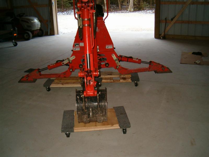

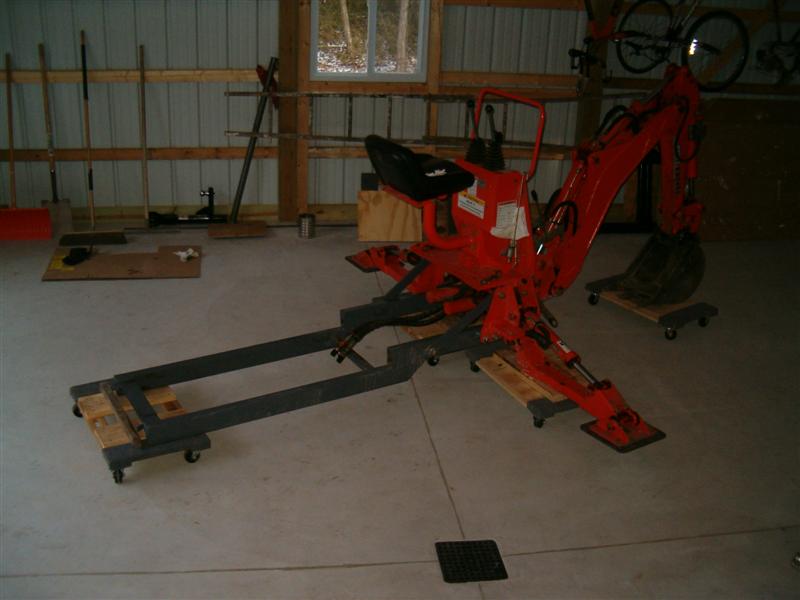

My dealer made up a short length of hose for me to provide for a loop between both empty rear remote ports once the backhoe hoses are removed. That way, should you accidentally hit that switch which will pressurize that "A" loop w/o relief you are protected. If you pressurize without a relief loop it is called "deadheading" the hydraulic system with no backhoe for relief which damages the pump.
As discussed, You will be able to unhook easier than hook back up. I have a concrete floor to drop my backhoe off so I place it on furniture dollies. That allows for some movement for easy reinstallation of backhoe to tractor because allignment is so important.
