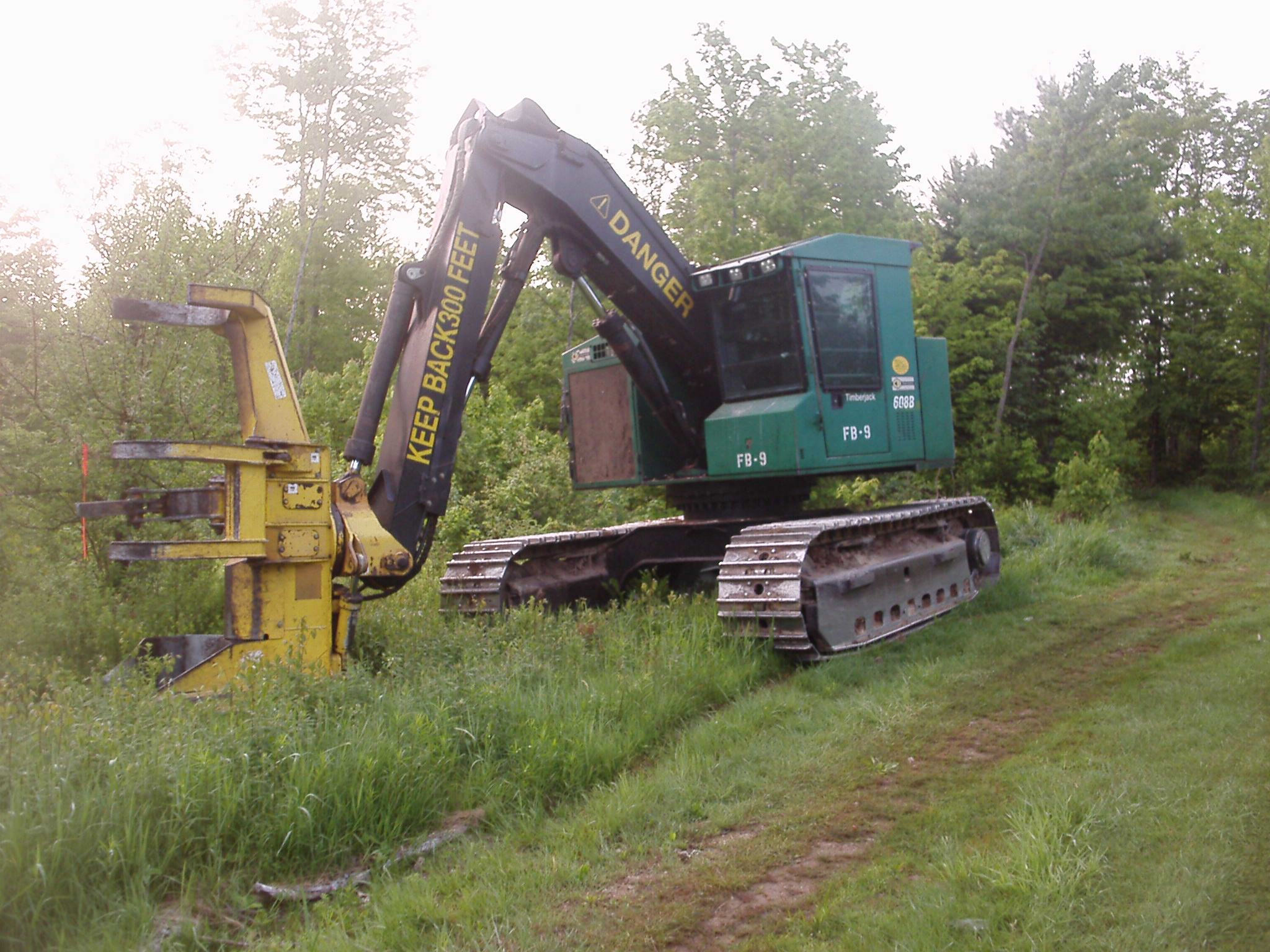

If you have time letting the stumps rot for a year or two will help them to come out better. Are they hardwood or softwood?
In 2009 I had a 2 acre field reclaimed. First they cut and chipped everything; Harvester.JPG
then came in with a 20 ton excavator and pulled the stumps, creating 11 stump piles so that I could reclaim the topsoil. It took 2 days to do two acres. The stumps weren't as big as what you have, but there probably were more of them. He also did a good job of raking the rocks out and getting them out of the field.
