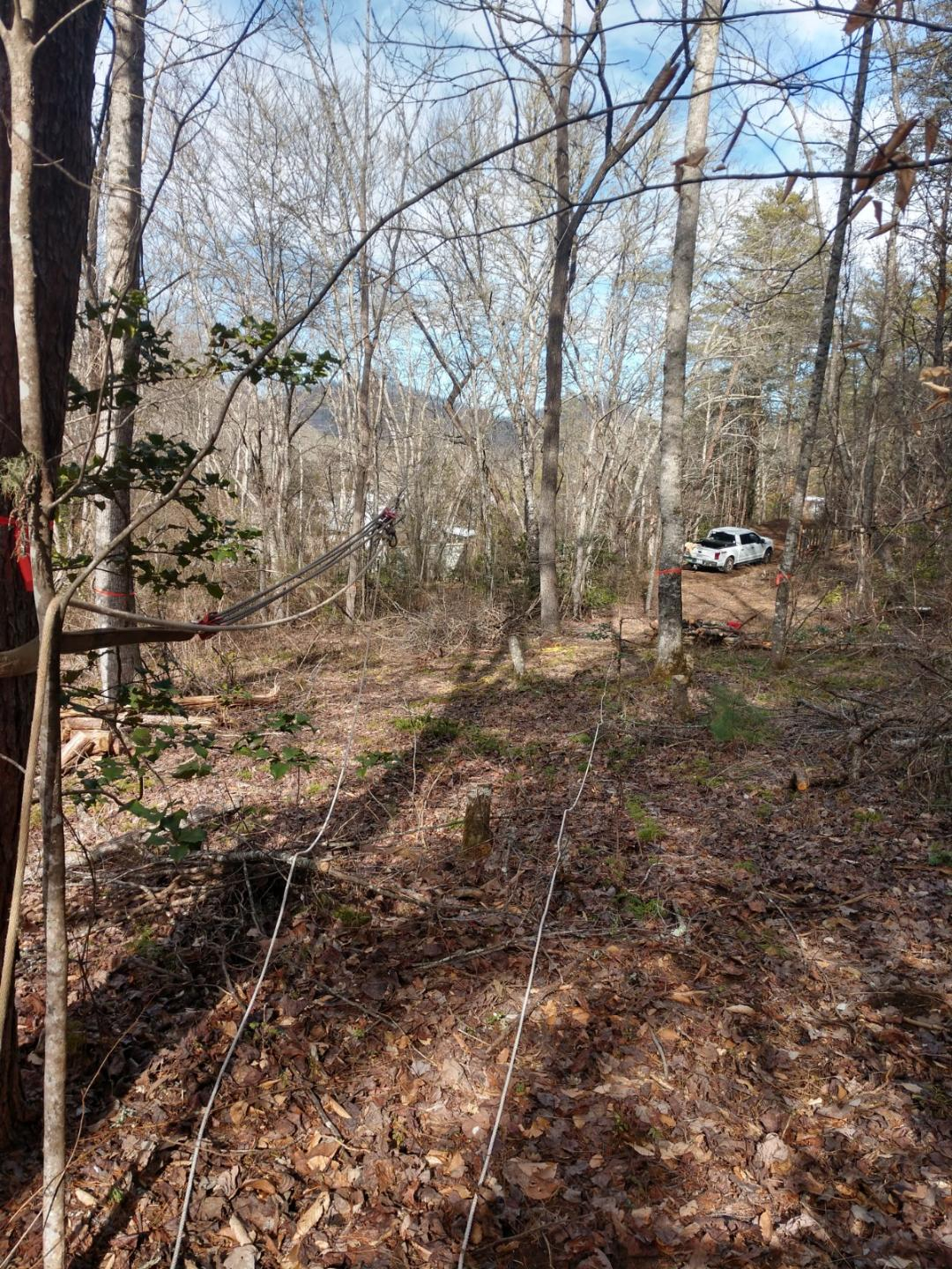

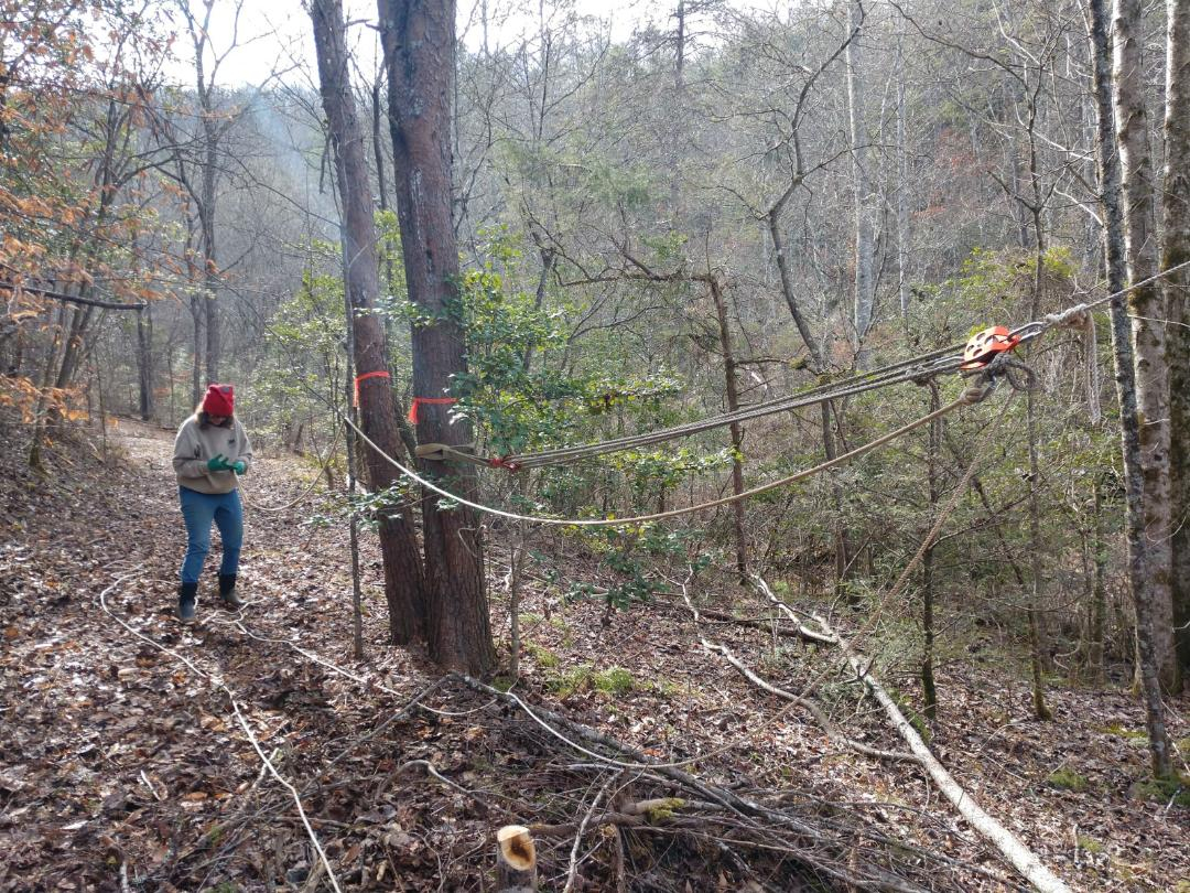

Mrs on the pull line, but you can get an idea of terrain and trees. Some skinnies were already taken down
