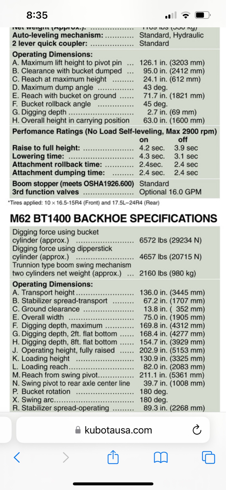

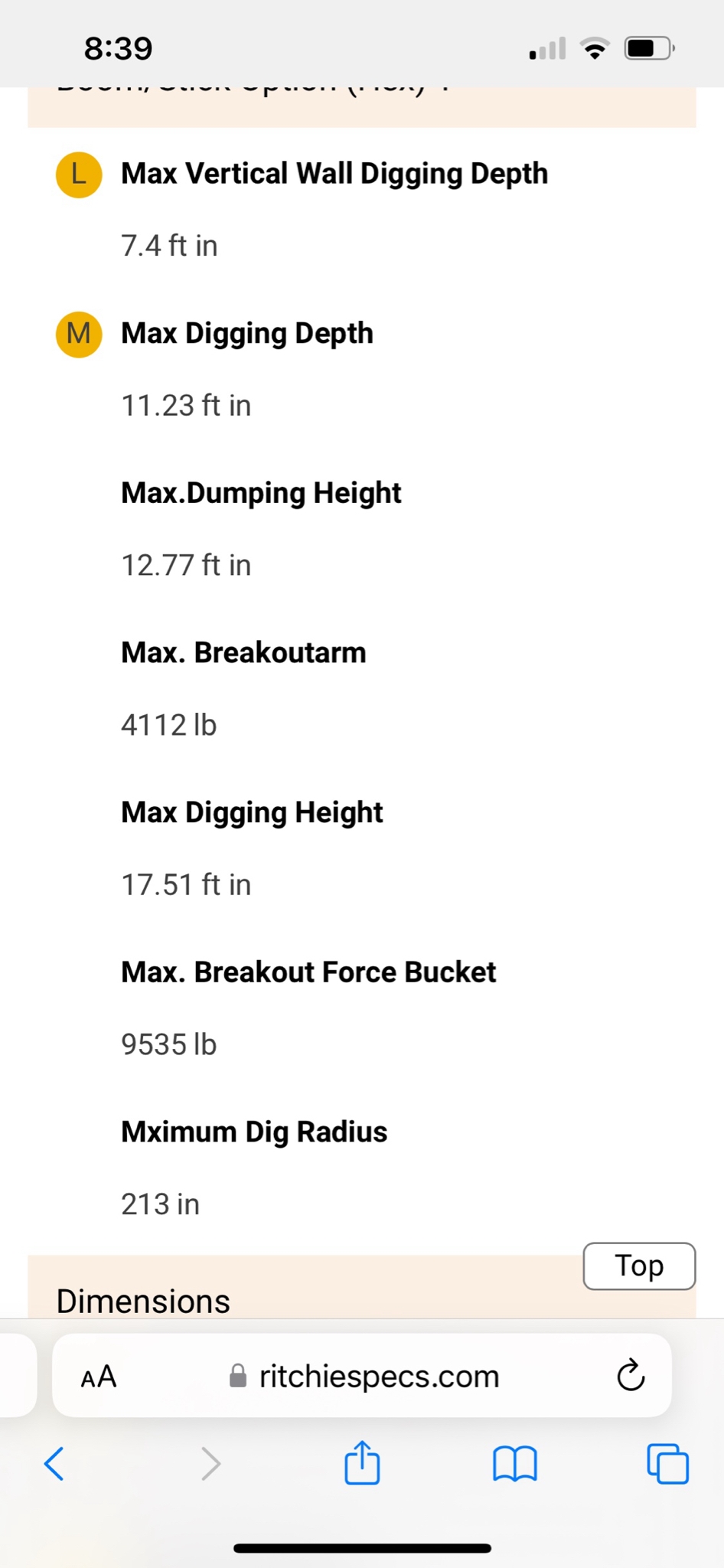

I think a M62 will slightly edge out a KX40 pulling a stump or digging out a big rock as long as the TLB can maneuver. In terms of speed, the typical job is done faster with a KX40.
The 40 bucket specs are considerably stronger. The arm specs are closer to the same with a slight edge going to the M62. I don’t see a lifting spec but my money goes to the 40 winning that one since the 40 is using the cylinder in the stronger extension mode for lifting. I don’t have any m62 experience but I owned a M59 before the 40 and the 40 makes a fool of the M59 backhoe.
