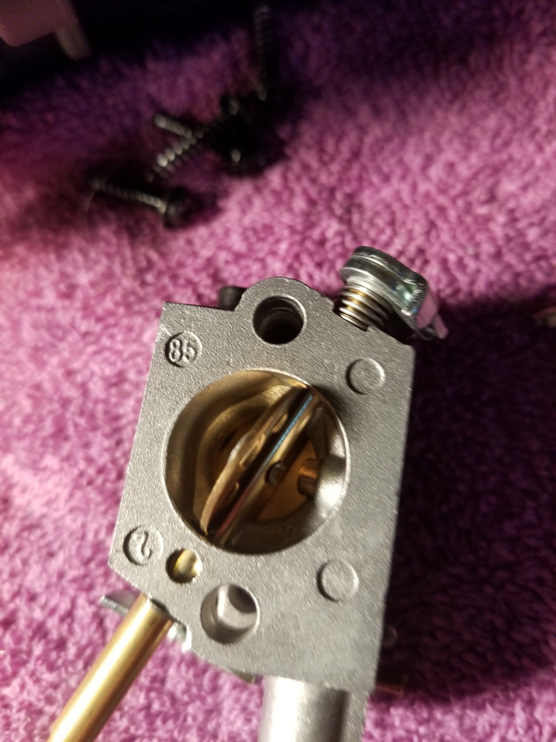

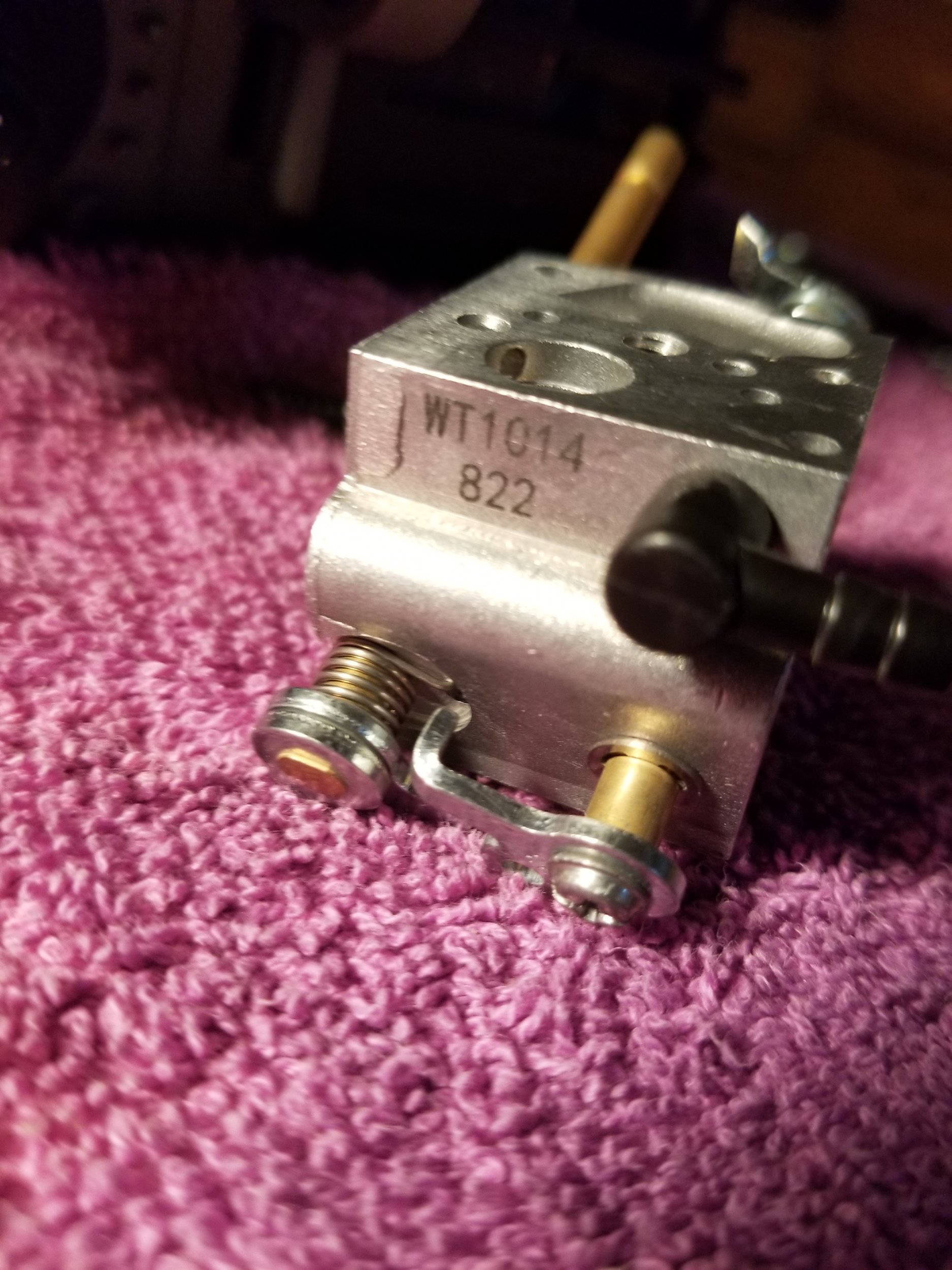

I can't find this carb anywhere. I don't know if I am looking for the wrong number or what. If you can figure this out and tell me where to get one I'd appreciate it.

Looks like everywhere I would normally looks for parts is showing it out of stock. Found prices from $78-154 so I would be attempted to just try installing a repair kit K27-WAT and see what happens.
