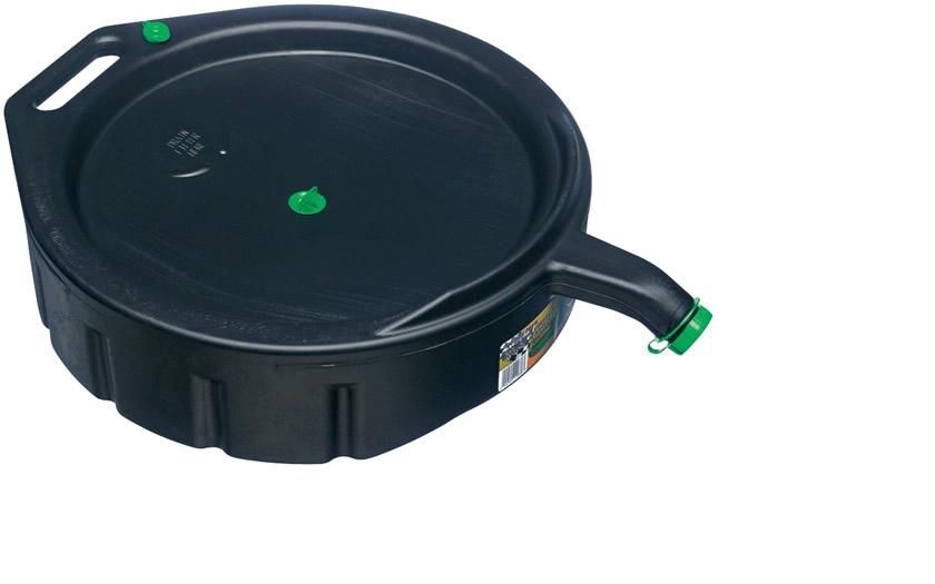

I am fortunate to have a 35 gallon plastic drum that I use for waste oil. When I accumulate a few gallons, I transfer it to a 5 gallon bucket with lid and take it to the auto parts store for recycling, or the local recycle center. I use one of these low-profile oil drain pans to catch anything under the PT (or car and truck).
